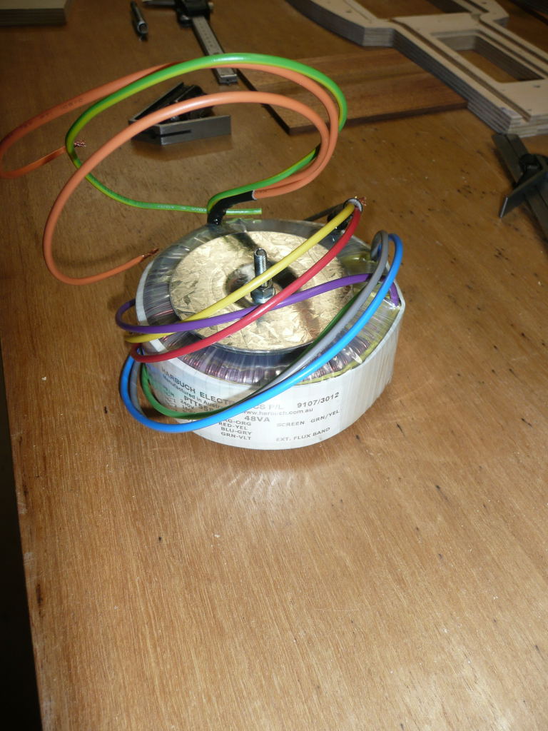

Given I am only building 1 output stage (not dual Mono) I assume I only need 1 x 150V secondary?
I thought the other secondary had to be 9V ?

I have not been making any progress because the local supplier has bee slow in giving me a price to make the transformer. He has advised me I require the following transformer to ensure I get the best performance,
Will design on a 120VA Core at 0.5Telsa, with an Electrostatic Screen and Flux Band 1 x 150v @ 0.1A & 9V @ 2A
The cost is $166.00 plus freight!!! & he wont be able to make it for 3 or so weeks!!
Do I really need this fancy transformer? Will it make a difference, say to the type ANTEK sell?

I'm on the same page here... You're wasting your time and maybe money here... Get the Antek transfo and use the SSHV 1 that Oliver sells or the SSHV2 or any other nice HV shunt.
I'm currently using the SSHV2
The Antek transfo works perfectly and does not vibrate or hum. You really should consider it

I have ended up ordering the local transformer because I was advised by Antek that they "Didn't make or modify transformers"

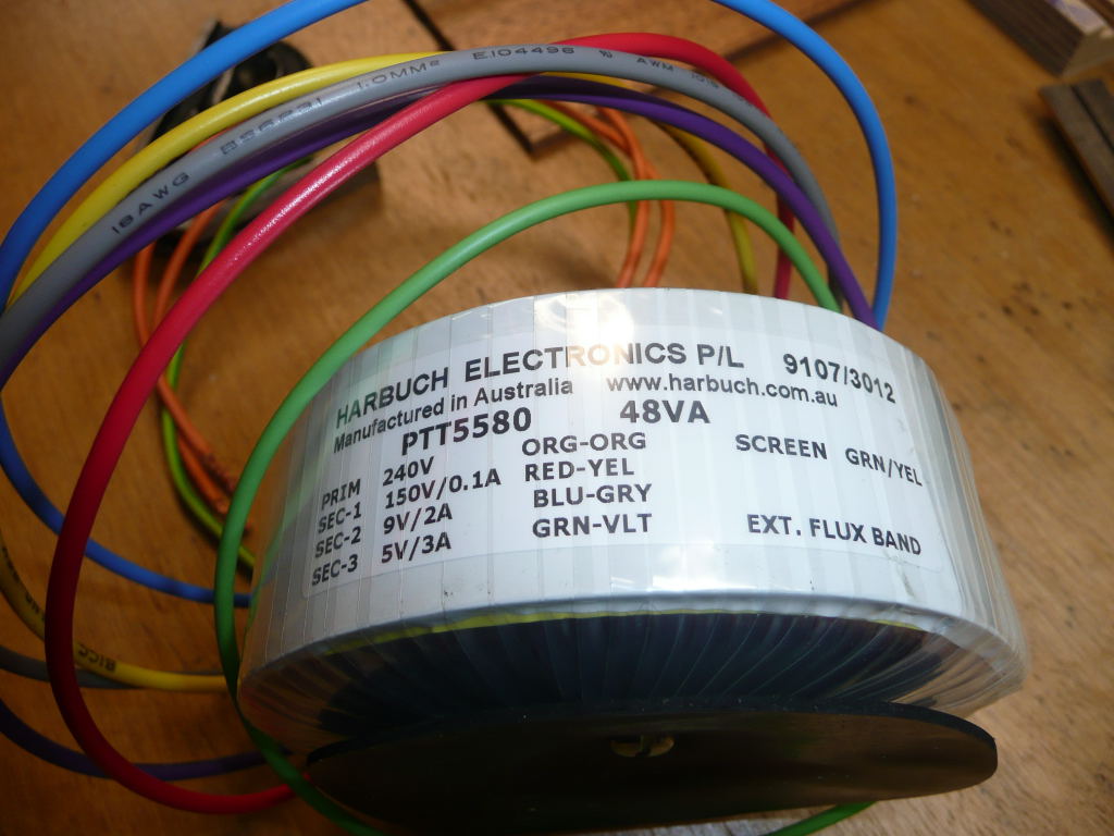

I finally got the transformer, ended up going the whole hog, has screened windings & a flux band, it is also built on a larger core to keep the TESLA value down, if only I knew why 🙂
Peter (the maker)said I wont be making another one that cheaply again 🙂 Mind you $180.00 didn't seem cheap to me.
