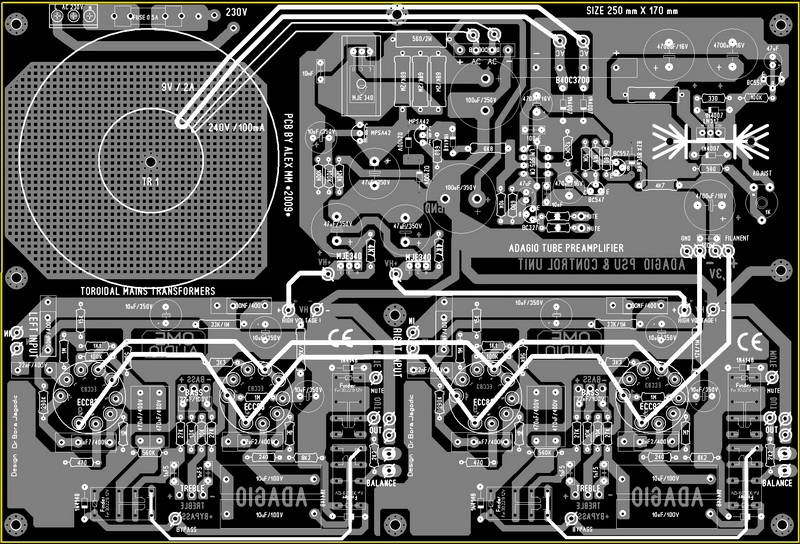

My first tube preamplifier Dr.Bora Jagodic design

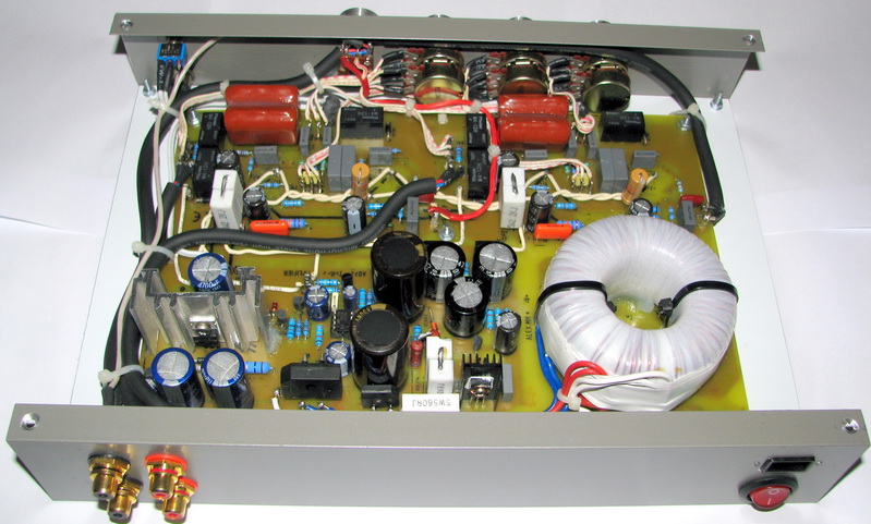

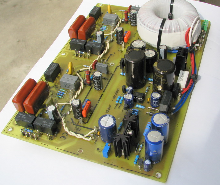

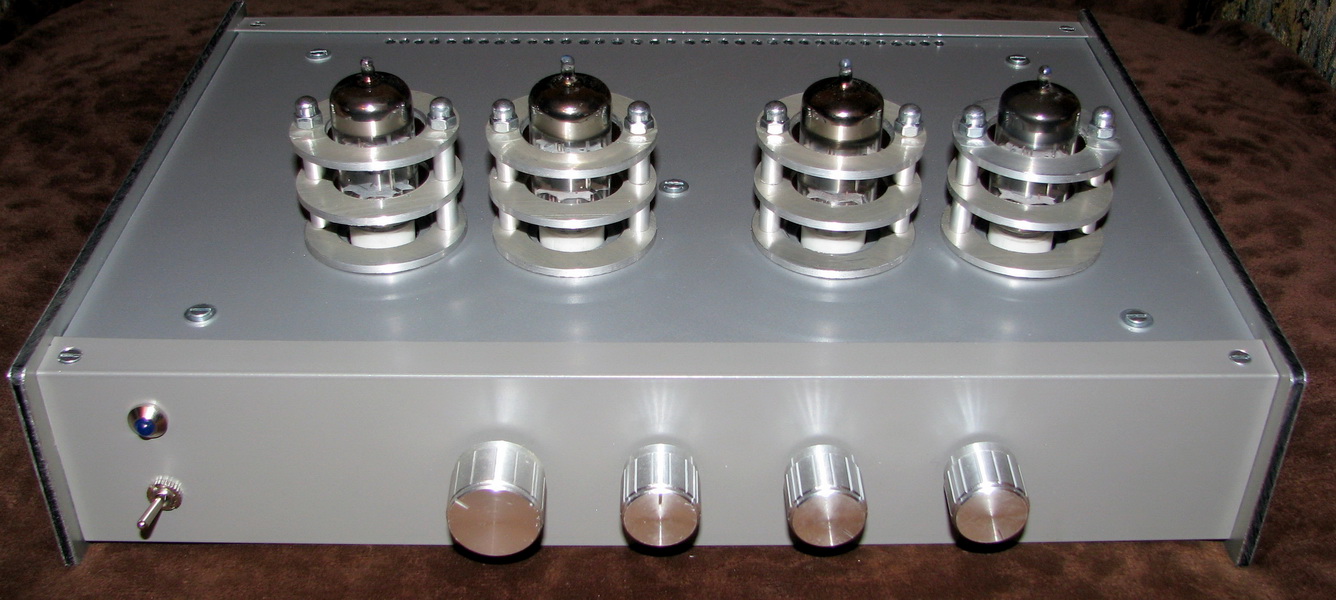

Four pictures of my finished valve preamplifier .......🙂
Alex .
Alex .

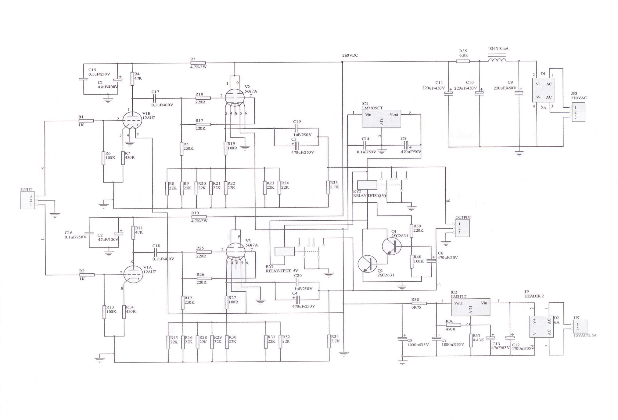

I have attached the circuit that is in a local electronics magazine. Please be aware that it is under copyright of the publisher.
But if it is copyrighted and not published elsewhere, please don't put it here without the author's permission.
