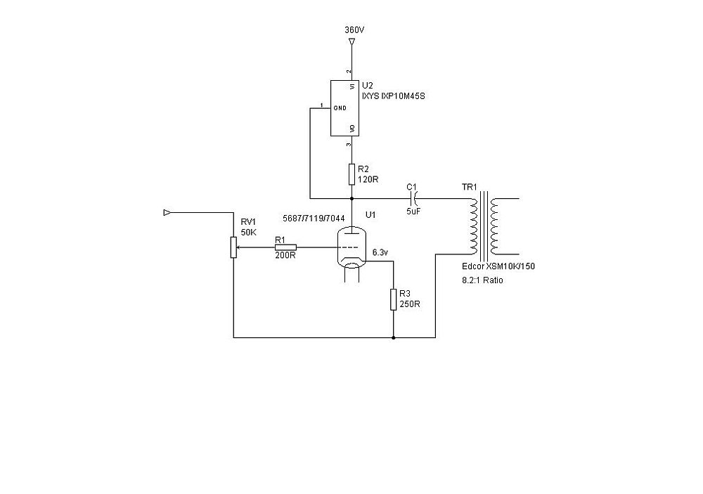

Hi Gavin, do you think it will still sound good with 32 ohm Grados? Mine has 32 and 300 ohm tap and the 300 ohm is not so good with my SR80i. I use the 300 ohm tap with AKG K240M (not mine) and it sounds good enough to me.
arnoldc said:Hi Gavin, do you think it will still sound good with 32 ohm Grados? Mine has 32 and 300 ohm tap and the 300 ohm is not so good with my SR80i. I use the 300 ohm tap with AKG K240M (not mine) and it sounds good enough to me.
It's not really what the tap says it's the ratio of the windings. Yes I think it will sound good. Here is a schematic I threw together, I am assuming (always a mistake) that the CCS will take up half of the B+ leavin 180 v - 200 v for the 5687. I may be wrong and if I am then you can rest assured that smarter people than me will point the mistakes out. This is just a starting point. I think it will have enough gain. I've had a few scotches so I might be totally off base.
After looking at it again I'm not sure that this amp will be acceptable for a Grado. It will have no damping. A cathode follower output stage, direct coupled, could be added for use with Grados.
Hi Gavin, did you mean omitting the output transformer altogether and using a big cap on the cathode output?
I was not and I think, I'm still not to keen on OTL with such a big capacitor 🙁
For parafeeding for Grados, lundahl LL1930's can work and aren't too expensive. Otherwise, Hammond 119DA, are OK. I got some Electra-Print 5K:32 parafeeds made for $100. You can also use power toroids. http://www.ecp.cc/less-pressivo-build.html

arnoldc said:Hi Gavin, did you mean omitting the output transformer altogether and using a big cap on the cathode output?
I would use the transformers that dsavitsk suggested. The Electraprints. $100 for a pair is a great price. I would also use the SCVS that Wavebourn posted. THe schematic I drew up is just a starting point. The cap size was just a guess. A smaller one may work fine.
