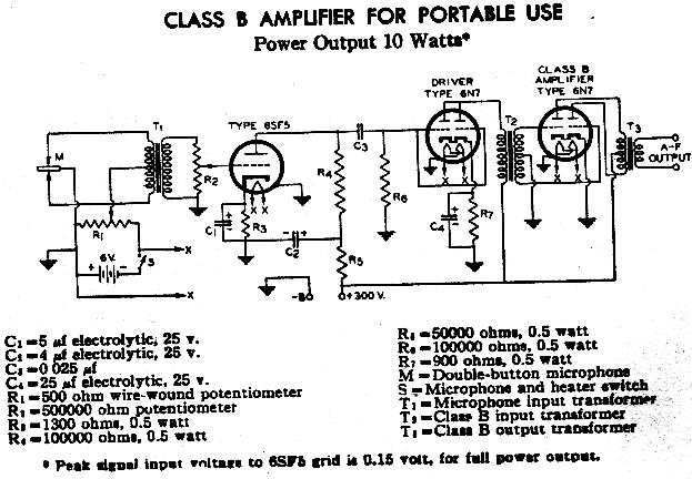

Since it appears that you are serious and sch3mat1c suggested 6V6's may I suggest you look at the 1619. That is a metal 6L6 beam power tube with a 2.5 volt directly heated filament and G3 is not internally connected. DH filaments get you more emission per watt than their sleeved indirect heated cathode counterparts.
With lots of power but sacrifice in quality you can use 6N7's tranformer coupled class B P-P. One tube will give you 10 watts! There is a schematic called "Class B amp for portable use" in the RC-14 RCA vintage tube manual on page 208. I could scan and post it if you wish.

After dinking around with scanning this image for a half hour and finding that in my only mode available, grey scale, I cannot post anything legible here in the 101 kB file size limit. Therefore please PM me your email address and I'll send you a readable copy. Thanx.

rcavictim: thank you again for the RCA battery amp schematic. I cropped it a little and am posting it here. The GIMP under Linux is a wonderfull thing.
Nice simple looking circuit. I worry about the transformer coupling, transformers always seem to be big, heavy and expensive. Is there somthing small and cheap from Hammond I could use here.
I also worry about the heater current, 800ma is going to empty my gel cell in 2 hours.
The 6ak6 tubes of Steve Benches circuit are 150ma. But then we are looking at a lot less power output. Decisions, decisions...

I'm sure I'd be going with a SS power inverter to make the B+ on such a rig if I were so inspired. Hammond made toroidal transformer sets for DC-DC upconverting tube plate supplies. You can also look at aircraft war surplus tube gear with 400Hz transformers for size and weight savings here. Much, much smaller core and less windings for the same job.
