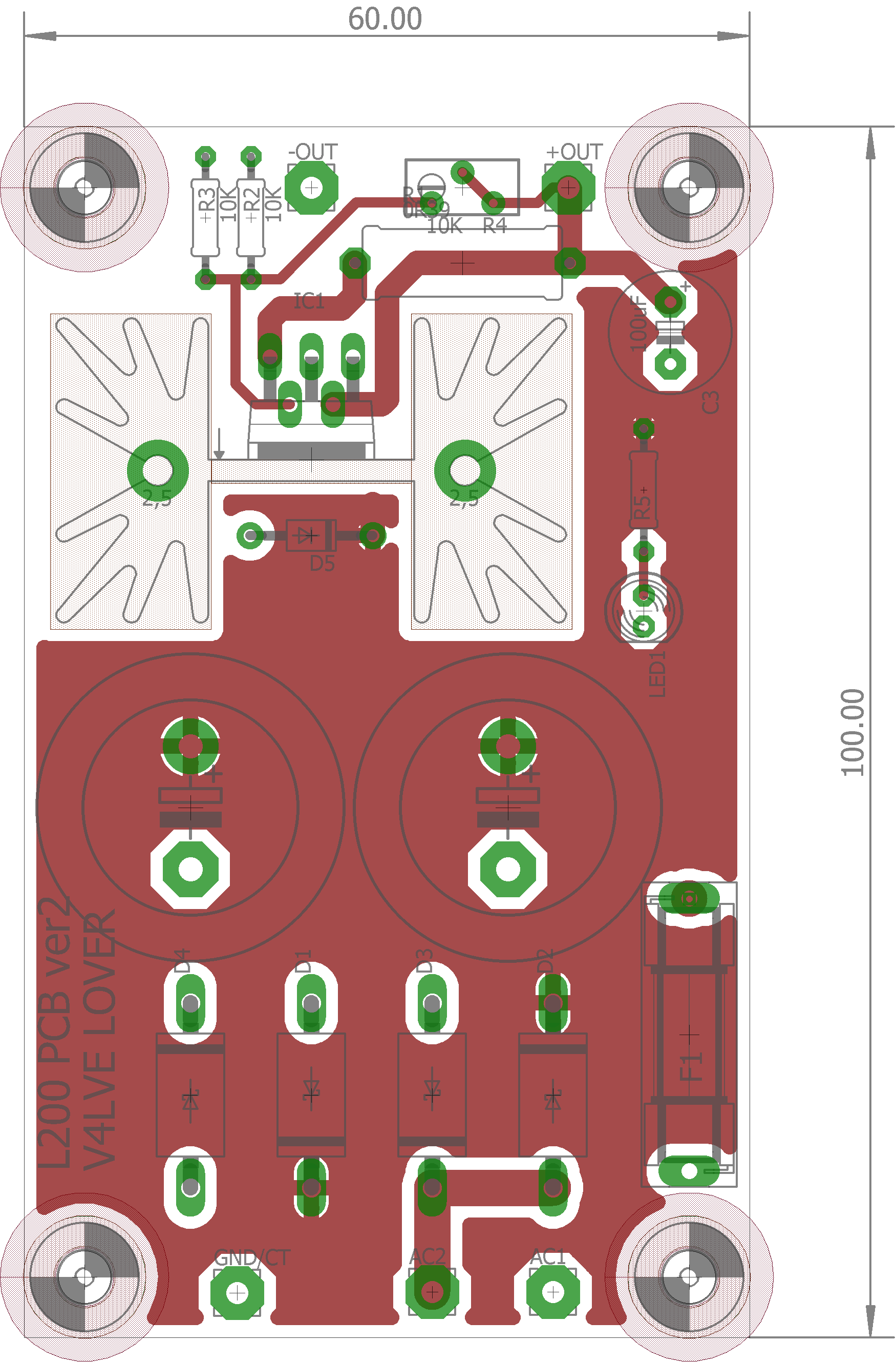

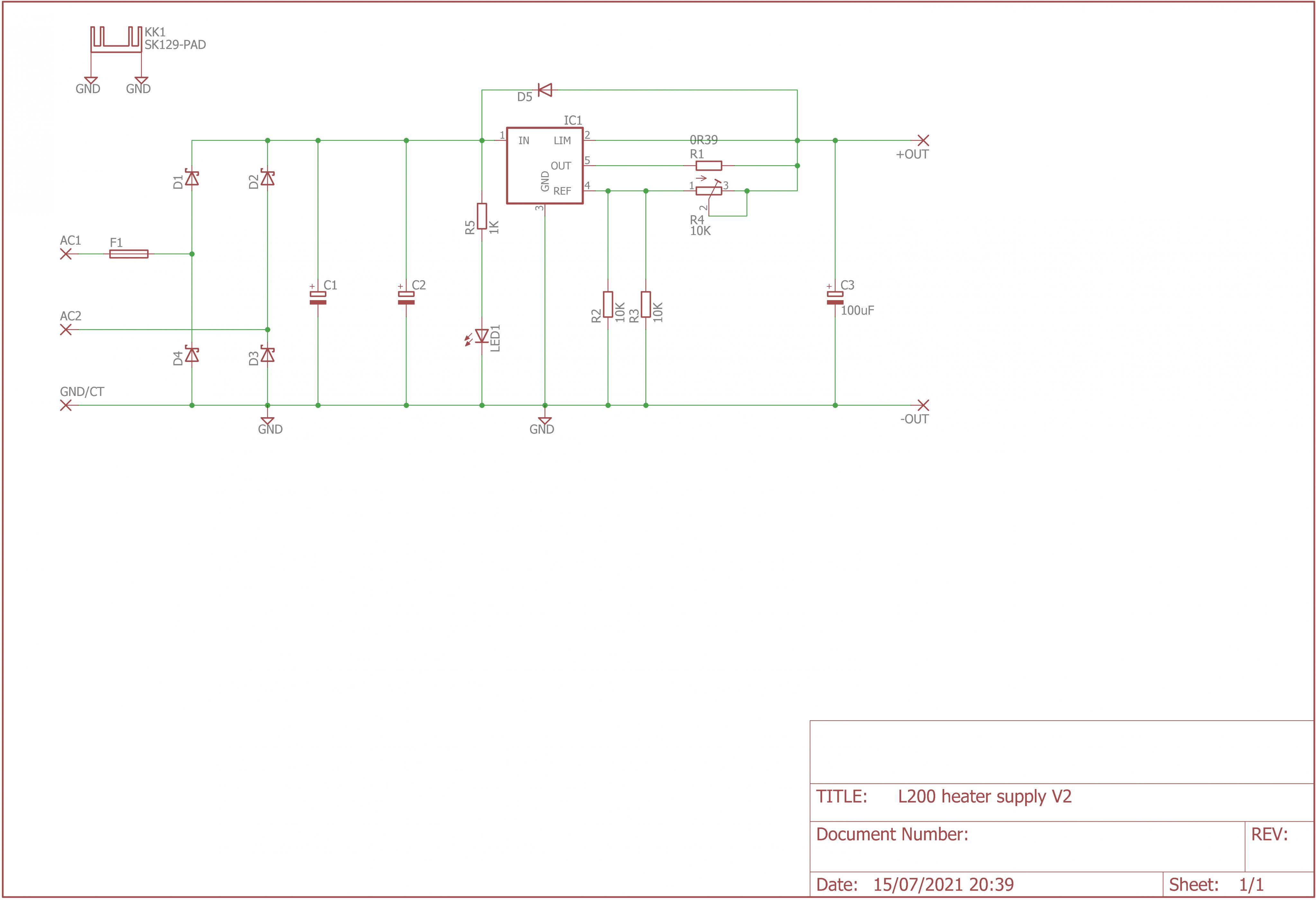

Perhaps try the L200 regulator, its got current limit. But high dropout voltage
You are right about that part being out of production, but there is still stock around. I recently bought 50 from Reichelt. And if the normal suppliers fail one can take a gamble on ebay/Ali
Ive been experimenting with the MIC5156 LDO controller, to do 6.3VAC to 6.3VDC. But that is a different goal. Allthrough that chip can do current limit.
Attached, the gerbers for a board with L200 it has current limit.
