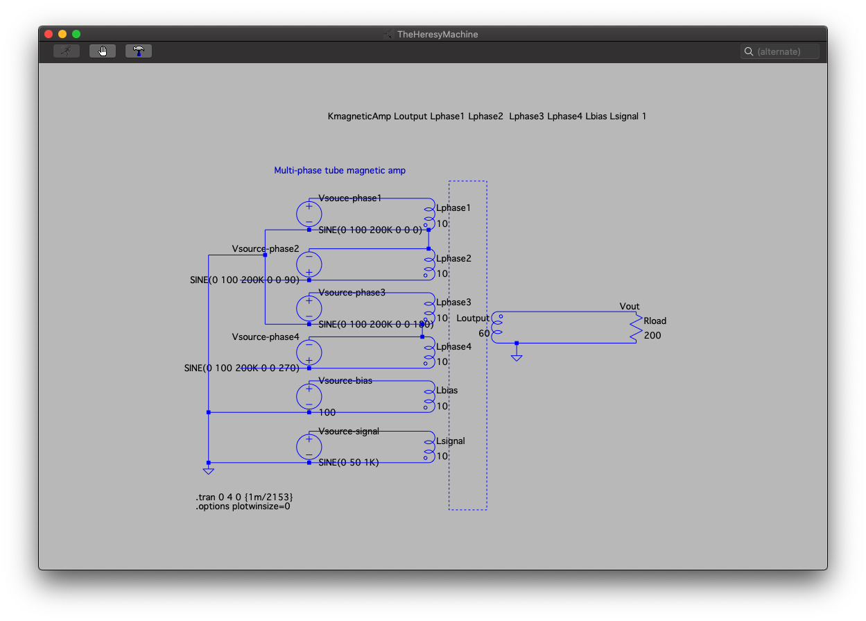

So instead of two phases, could we make a multi-phase amp?

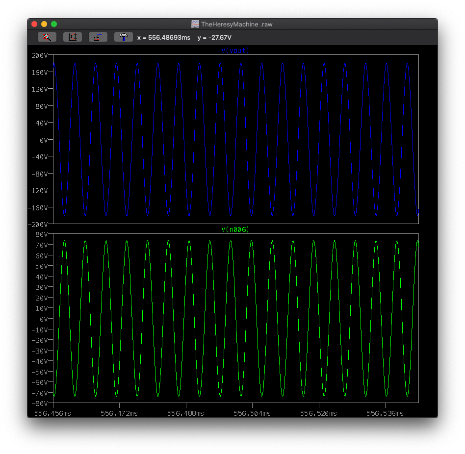

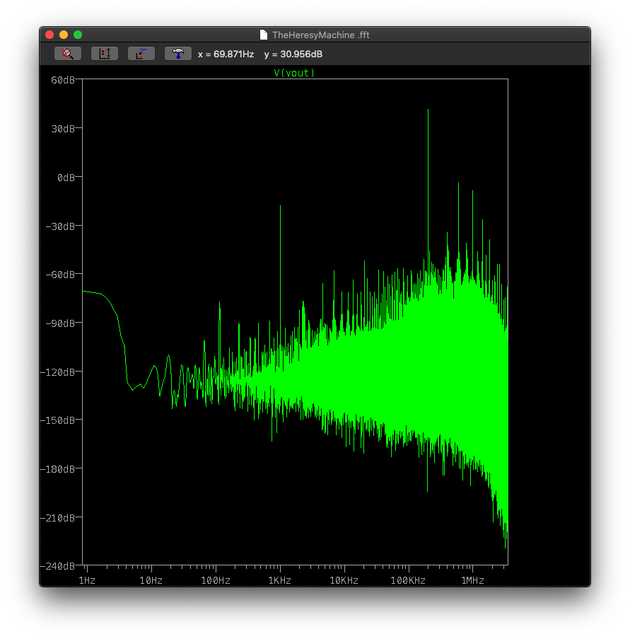

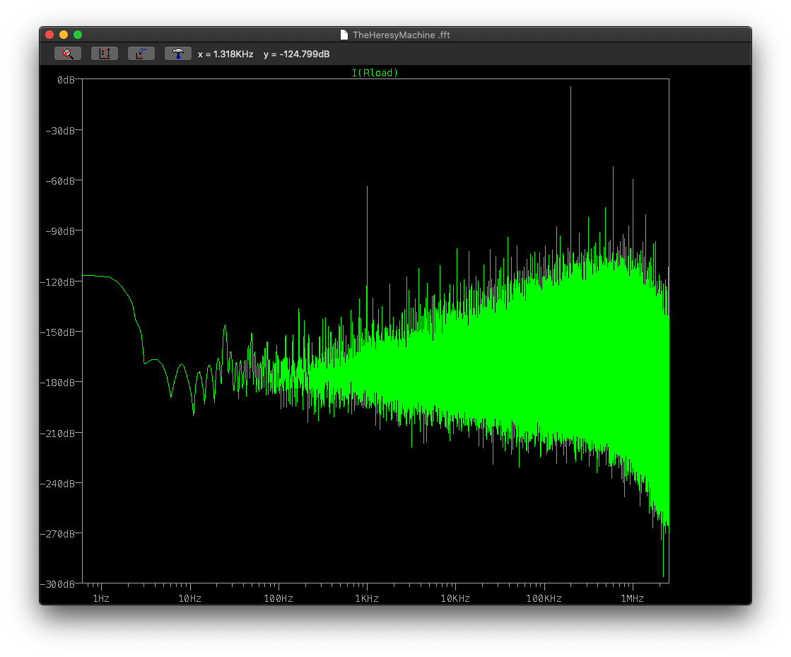

This seems to be working- first run after making the spice model - would appreciate comments.
Current this is using 200KHz sine wave, I will alter the model for 200Khz switch pulses today - just have my vaccine shot today so I'll get more time this evening.
LTSpice
View attachment TheHeresyMachine .asc

The key here is that the transformer switches in and out of saturation. Saturation creates a lot of odd harmonics which is where the SMPS switching rate allows this to be targeted.
I'll have to expand the test to a multi-tone signal to ensure this isn't just operating in one-frequency.
