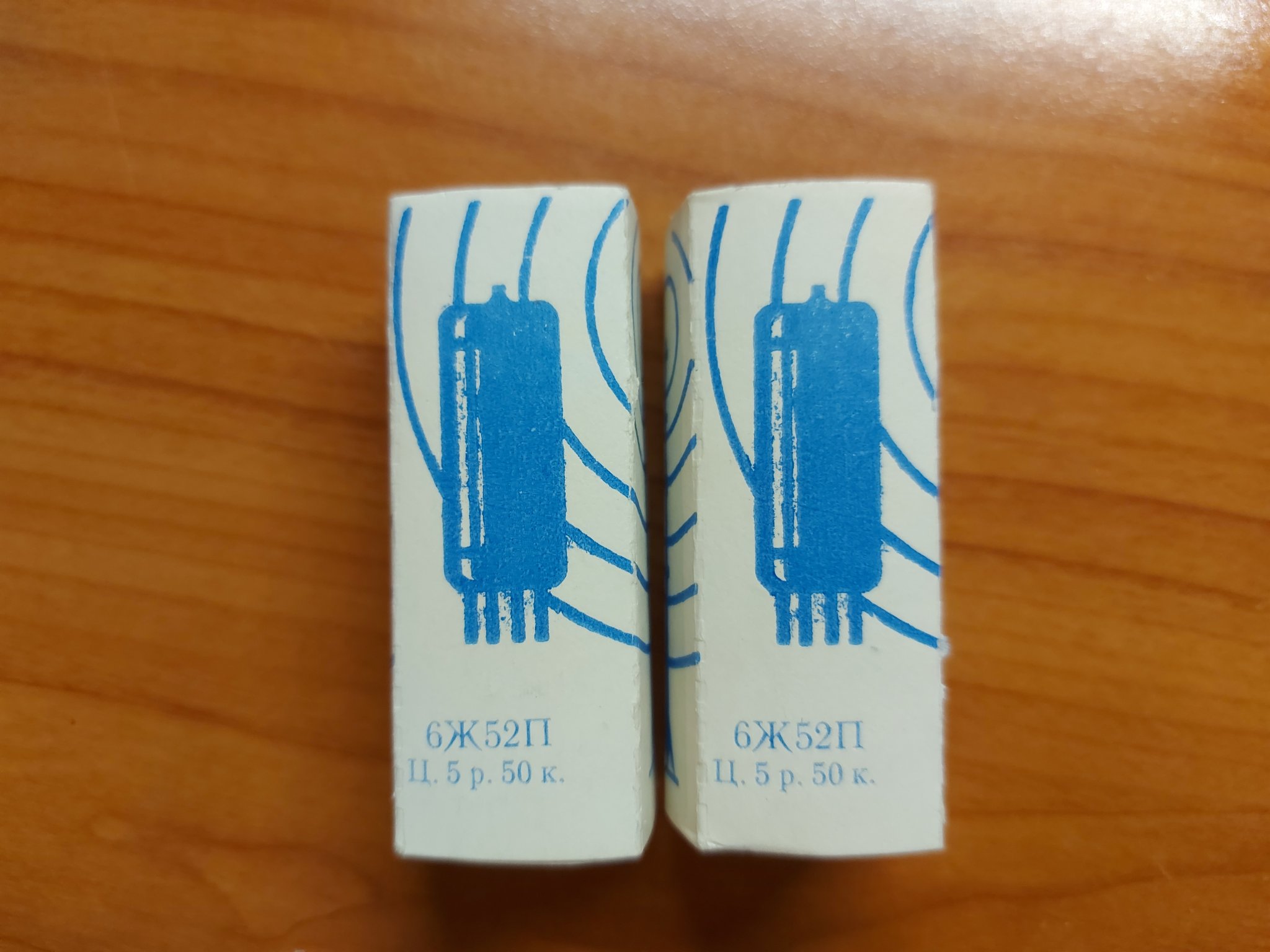

Tube DAC with TDA1541 and 6Ж52П pentode (6J52P or 6Z52P ??)
Hi, I have this DAC that comes out a little low compared to my other sources. Maybe I could change tubes with others with a higher MU..Clearly tweaking the polarization?
It features 2 pentodes connected to a triode with this acronym printed on it "6Ж52П".
Regarding the translation from Cyrillic, I honestly don't understand if they are 6J52P or 6Z52P, I would like your opinion on the matter.
I would also like to know the MU when connected to triode. Two links online lead me to this:

In your opinion is it the measurement of the same valve? Because it mentions 6J52P in one link and 6Z52P in the other... and I don't understand why there is so much difference in MU. Maybe measurements taken under different conditions make that much difference?
Oh well..I would simply like to know the MU also to adjust myself with other possible alternatives, with higher Mu, such as perhaps a possible E810F, D3A..or 6z51p which has an MU of 80, visible at this link:
https://www.bartola.co.uk/valves/2013/02/23/russian-pentodes-in-triode-mode/#more-1264

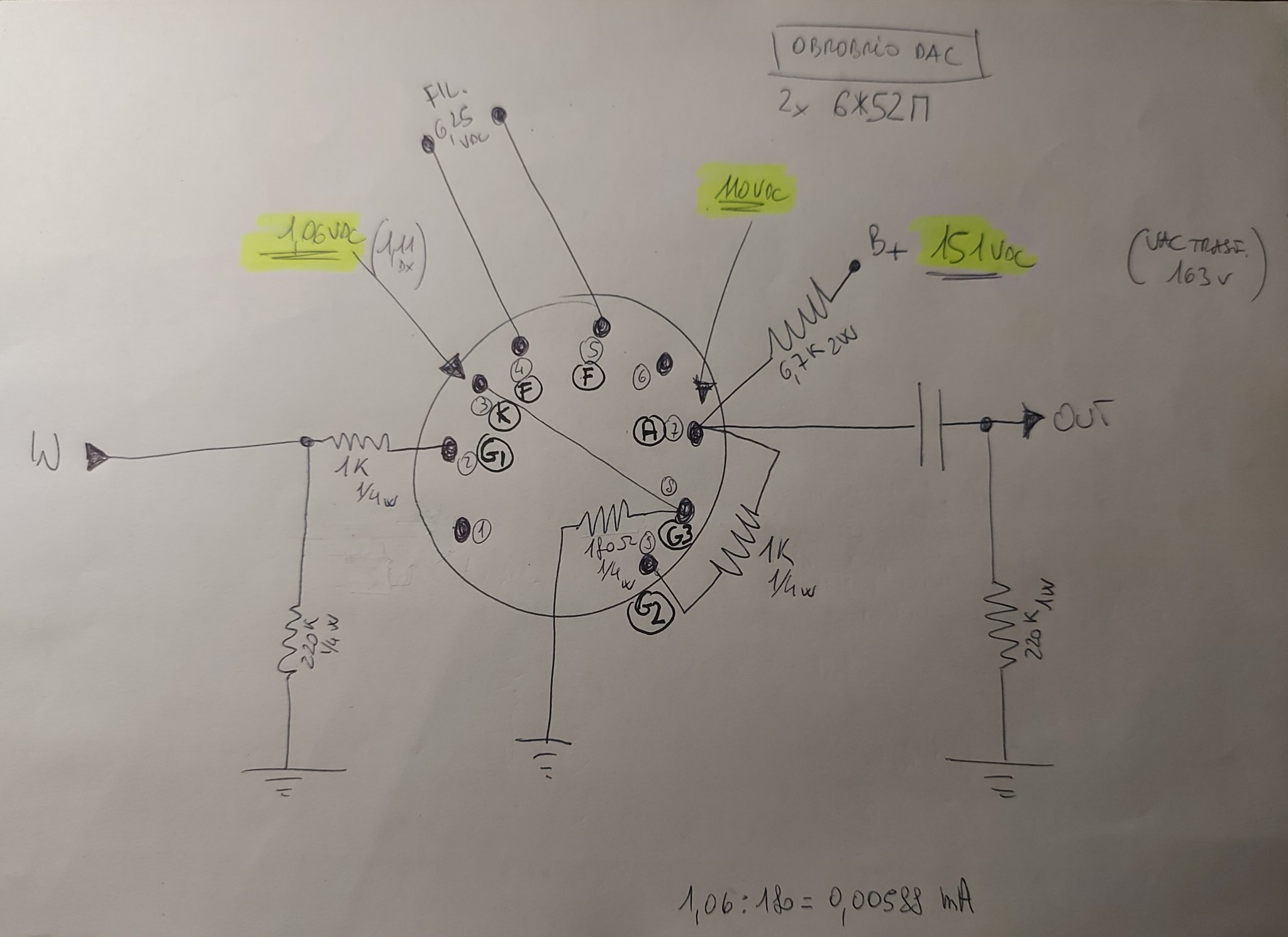

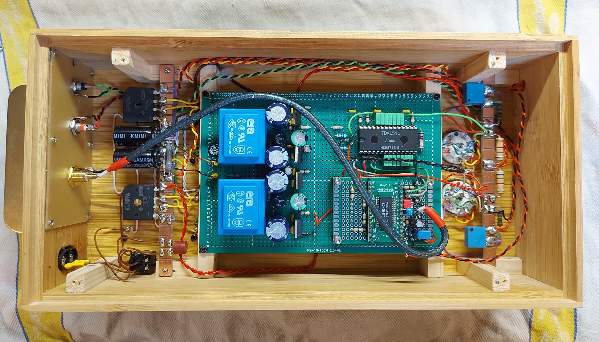

Apart from the MU issue, partly to know how this DAC was implemented, partly to learn something, I still made some measurements around the tube.

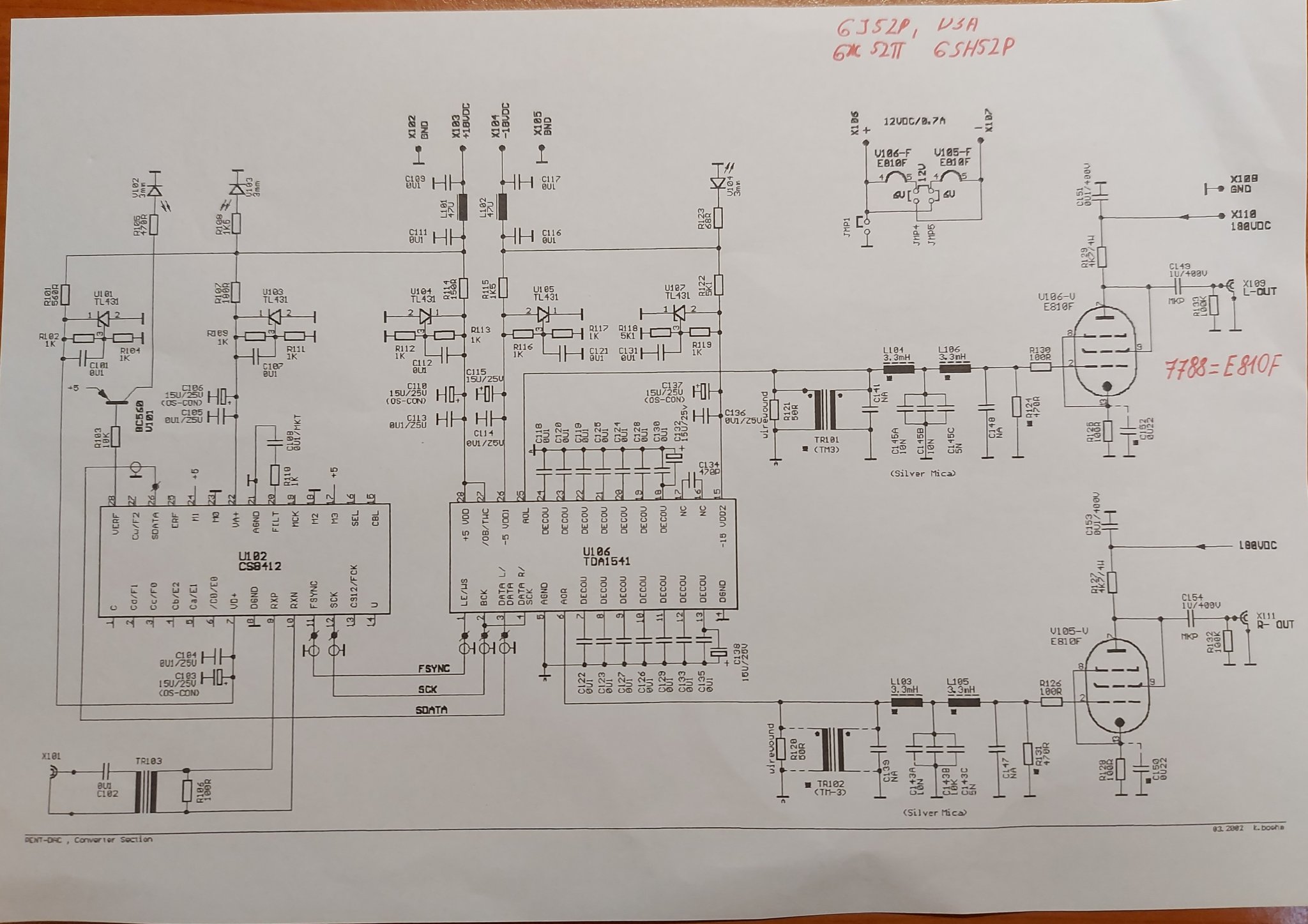

Compared to the diagram the seller provided me, I notice several differences.
The DAC output pins go straight to the tube and, unlike the diagram provided, no transformer, no filter. There is only one r of 56/57ohm towards ground (I think it is for the I/V conversion)... and 1k as a grid stopper, if I'm not being stupid. Why is there no filter? Perhaps the miller capacity entering the tube is exploited to "generate" it?
For the rest there are no bypass caps on the cathode, so I can assume that I could gain output signal level by bypassing the rk with an electrolytic cap. But since, if I remember correctly, the signal passes through it, perhaps I would prefer to use some diode... LED... or another type.
Always hoping not to say nonsense. It's correct? with a diode, at the same voltage (1.1v) I should have maximum gain, right?
In fact I then noticed differences from the scheme. The B+ is not 180vdc as per the diagram but 151/154vdc.
The RA is 6.7k and, if I'm not doing the math wrong, the current flowing in the tube is (1.06v : 180ohm) ...5.88mA.
Given the way the tube bends are, whether it is a 6J52P or 6Z52P, it seems to me that it is working with little current and therefore also in a slightly unlucky area of the bends.
I'm highly inexperienced so I've been talking nonsense for a while. Furthermore, reading a lot online about this tube or similar... they seem to like much higher currents than a paltry 5.88 mA.
Was it a design choice to have a certain sound timbre?

@lcsaszar
hi, as I said in the initial post, in my reality, leaving the tda..straight to the 1k grid stopper...and then grid. no transformer or filter.
only a 56/57ohm R to ground (I/V).

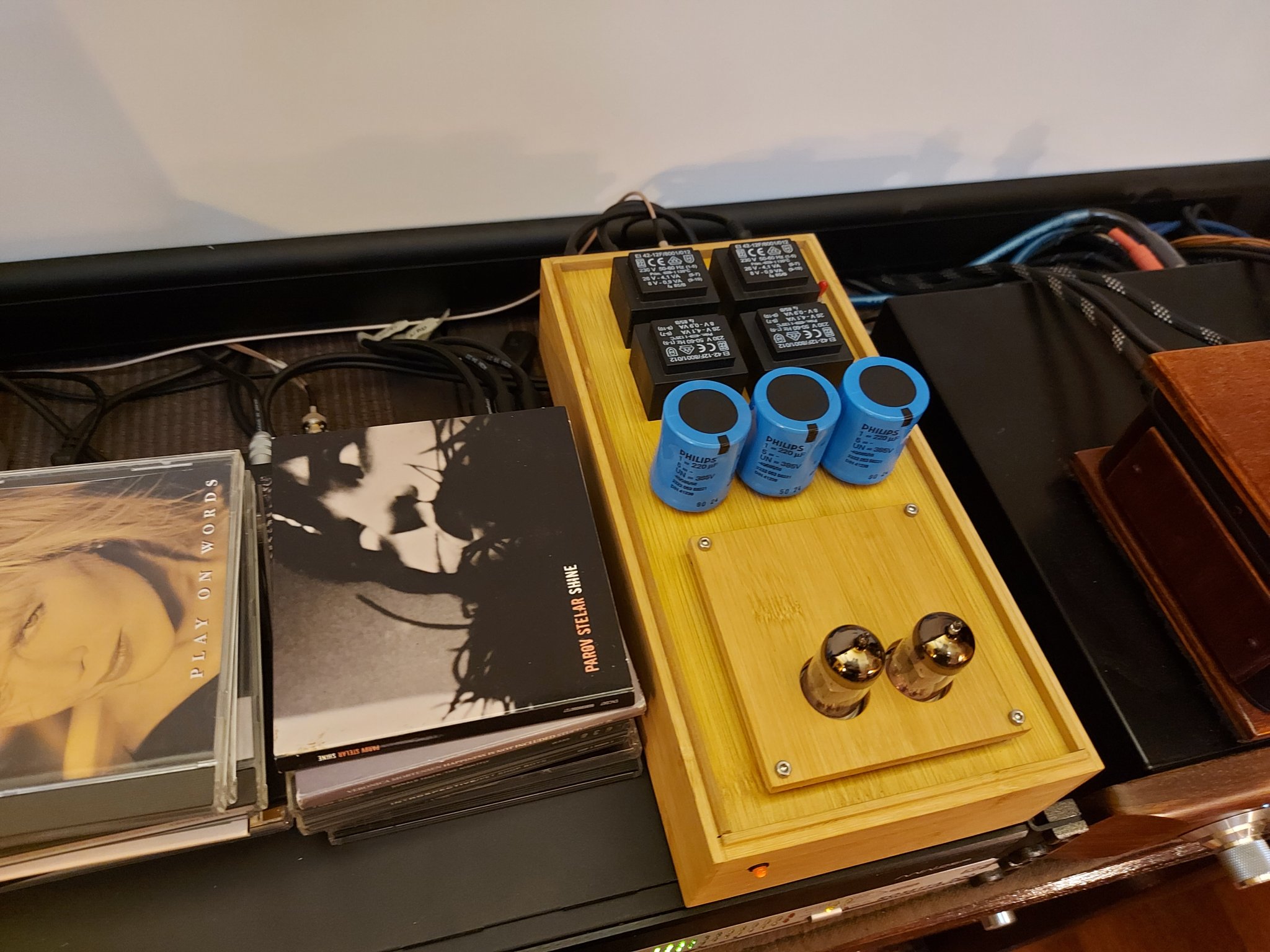

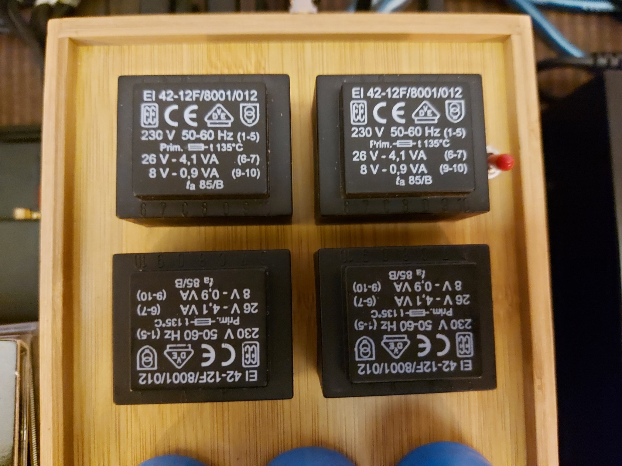

It is clear that I do not have enough voltage for this tube, as well as little current, current 5.88mA. I know that for this tube you need a lot more current and also quite a bit more voltage.
I don't intend to undo everything and change the 4 transformers you see in the attached photo, they produce the voltage for the filaments and the anode.
Currently the 4 secondaries at 8v are all in parallel and power the filaments. The 4 secondaries at 26v are all in series for B+.
Unfortunately I can't connect them in any other way to get a higher B+. Yes, actually I could do that, but I would lose some current to the filaments. So nothing to do.
Solution? Tube change!
I have a pair of e88cc siemens gold pins perfectly matched and a pair of ecc88 philips, also new and paired.
Among the tubes I have I think these are the most suitable, in my opinion with these tubes I can get 2Vrms output and I have enough current and voltage to make them work well.

I tested the power supply by loading the B+ with resistors. I have these currents and voltages at my disposal.
LOAD B+
12mA 150V
23mA 139V
39mA 121V
The less current I consume from the B+... the better, as the voltage for the filaments is also affected. This should be taken into account.
I would always tend towards solutions with "less" current (and perhaps also "less voltage") as I would like to keep some margin in case more filtering is needed.
What would you do with these voltages and currents and... tubes available?

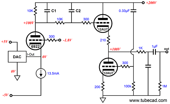

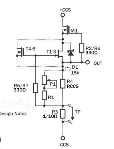

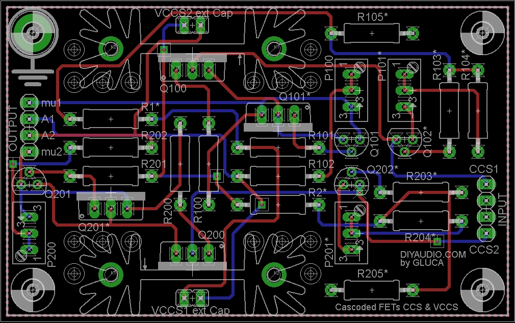

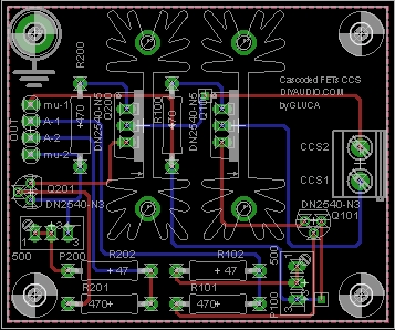

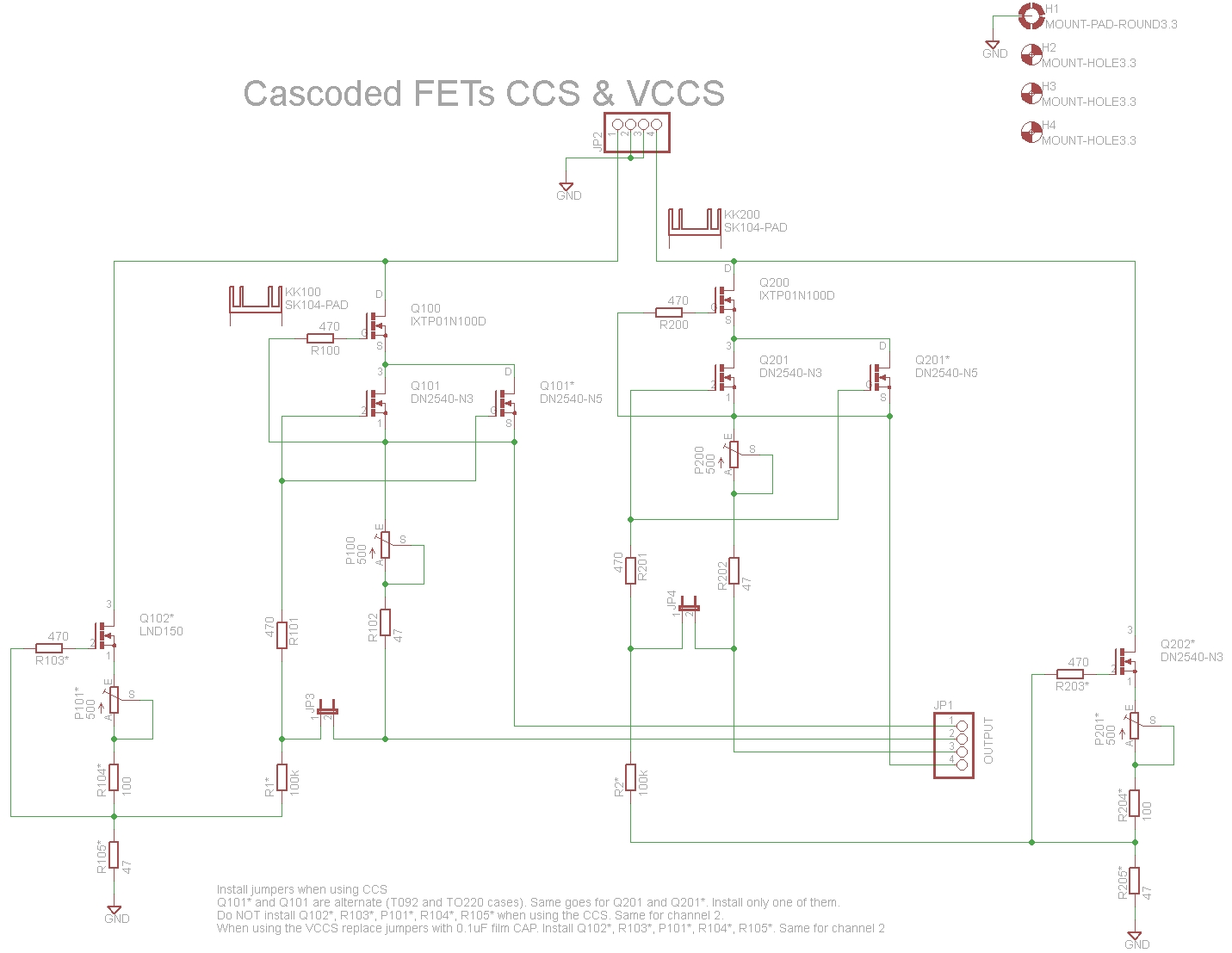

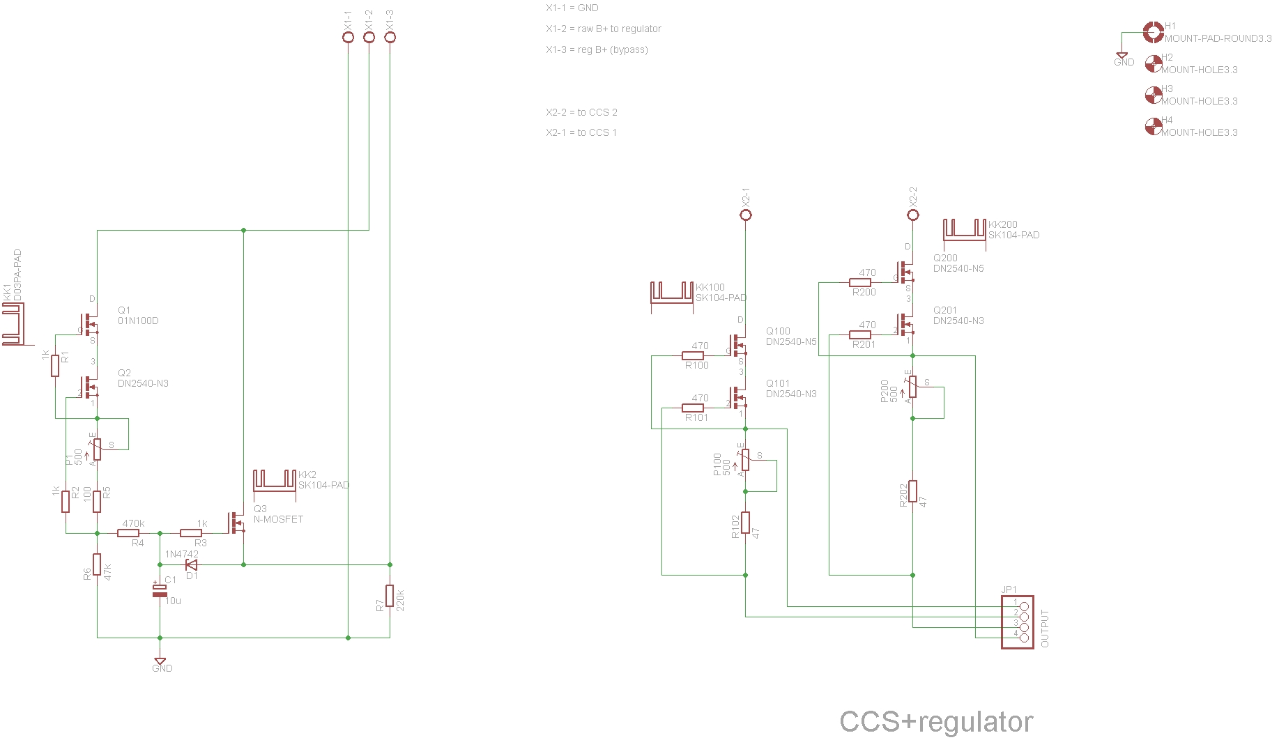

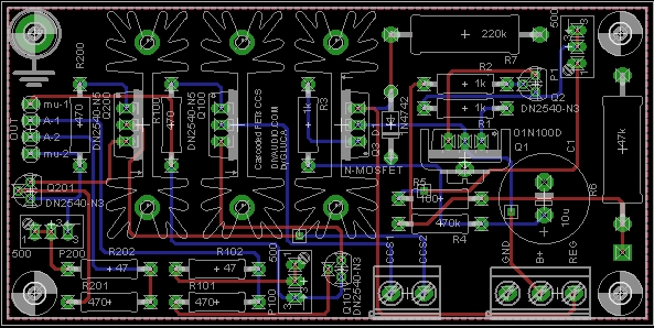

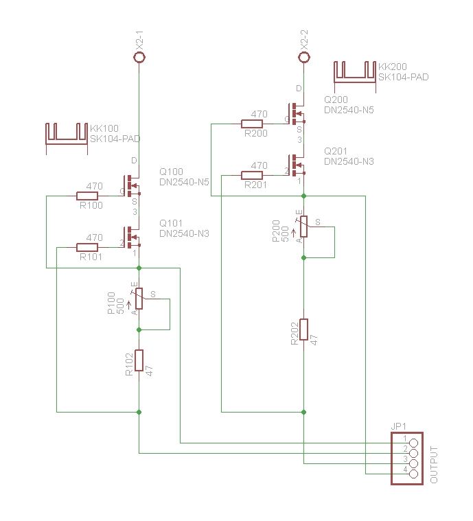

Don´t complicate things for yourself. Use only one half of the ECC88 for each channel! The wimpy power supply seems to work acceptable with ca 5mA, which is good enough for the single 88´s. Don´t load it more, as 150V is still on the low side. Once again, if you want it to work properly(horizonal loadline) and want low Zout, go for a Bartola CCS/mufollower from Bartola: https://www.bartola.co.uk/valves/for-sale/ccs-pcb/
I once bought the same style unpopulated PCB´s from an Italian maker(Gianluca) here on diyaudio, can supply you with a pair if you need. https://www.diyaudio.com/community/threads/pcb-for-cascoded-ixys-ccs-tube.190379/
