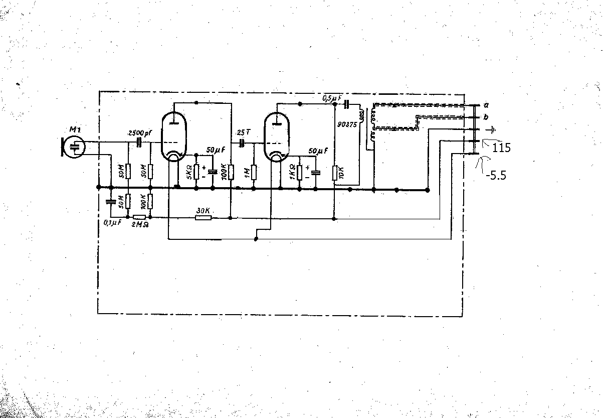

Chris: If you built a AKG C 60 mic according to the schematic shown in the first part of this thread, the mic end is about as simple as it gets, and it too can be simulated. Filtered B plus (+120 volts) goes straight to the plate of the nuvistor. The two series resistors in the cathode are required and these are chosen to self charge the mic capsule from the IR drop across the 82 k resistor. The 1.5 k resistor is the cathode resistor and the output (to a transformer) is impedance coupled off the cathode. My calculations indicate the plate current of the AC701k (as shown) is around 0.8 milliampere. This would make the capsule charging voltage around 65 volts.
If you use the 7586 nuvistor to replace the AC701k, change the 82 k resistor in the cathode divider to 110 k and the 1.5 k resistor to 2.7 k. (100 k should work in place of 110 k) Resistors 0.1 watt each. The 180 meg ohm capsule resistor is fine. The charging voltage will rise to around 75 volts but this should work. If the capsule charging voltage is excessive (measured at the junction of the 110 k and 2.7 k resistors), the plate supply voltage must be reduced approximately 15 volts by increasing R6 by 10 k. R6 is selected so you want to send approximately 100 volts to the nuvistor plate with plate current of approximately 0.7 milliampere.
What you are looking for is a plate current of 0.7 milliamp, a drop across the tube of 40 volts dc, and the capsule charging voltage in the range of 60-70 volts dc, developed across the 110 k resistor to ground. Use a good quality high impedance dc voltmeter for the voltage measurements in the mic since you don't want the voltmeter loading these circuits.

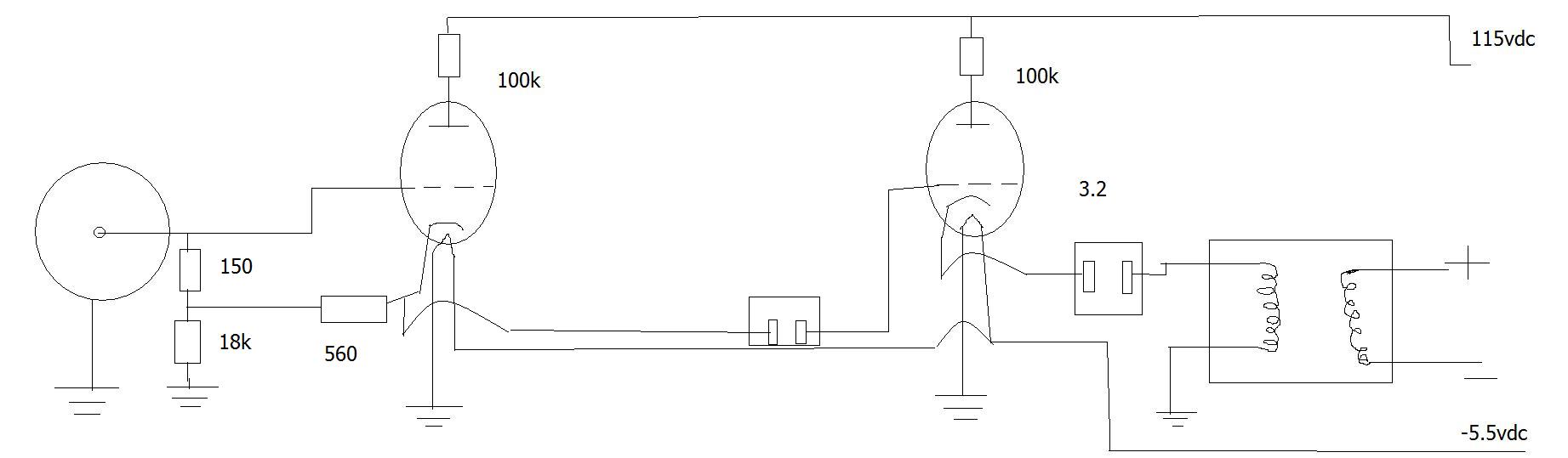

Good evening Chris...
The old Ampex plug in mic preamp for the MR70 tape machine used two nuvistors to get 60 db gain. Schematics of that preamp can be found on line. I used a MR70 once years ago...a great machine...also used the ATR100 which was also a great machine and those in between...until Ampex ditched the audio business.
Whatever you do with the mic preamp, the input stage is the key. That is the stage that matches and/or amplifies the small voltage variations from the high impedance input to a useable output with minimal noise. I am convinced that the 7586 nuvistor is your input stage. The AKG C 60 mic has good clean high output. You can use another 7586 following the input stage for more voltage amplification, but probably would not work as a line driver. The 7586 has a absolute maximum power dissipation of 1 watt.
Inside the mic body, you will have at least one tube (heater power 0.7 watt, other dissipation 0.1 watt). More tubes means more power (and higher range of signal levels) in a confined area so you don't want to cram so much in the mic body and heat stress the capacitors, risk of oscillation etc. You may get away with 5 watts total dissipation with a U47 type body, but a smaller mic body will run hot. A line driver could be as simple as a 6C4 or a 12AU7 impedance coupled to a plate/line transformer, even a 6DJ8 type, depending on the primary impedance of the transformer and the operating point of the tube section (or sections if paralleled). I like transformer output since that stops RF most of the time if you are recording near any radio or TV station antenna structures. There is also an interesting tube D3A which is European, which seems to be high mu (in triode connection) and can also handle some power. Haven't used the D3A myself but may be worth getting a couple to try on the test fixture...

Chris: The 13CW4 nuvistor was part of a kit Gotham Audio sold almost 40 years ago to replace the VF14 tube in the U 47 and U 48 mics. The VF14 has not been manufactured for many years, and the AR47 kit was a 13CW4 replacement for the VF14. Do not use the 13CW4. The 13CW4 has a 13 volt heater and was used in the old series string TV sets. The VF14 had a 40 volt heater but in mic use it was run around 35 volts in series with a dropping resistor off the single B plus coming out of the NG supply.
The 6CW4 nuvistor has a standard 6.3 volt heater. The 7895 is a high mu nuvistor triode with industrial specs. You should be able to use the 7586 off the mic capsule and follow that with a 12AX7. You may also want to experiment with running more plate current on the 7586 at the possible risk of more tube noise. If you are using the AKG C 60 circuit, try the following on the 7586 cathode divider: 18 k in series with 560 ohms, open end of 18 k resistor to ground, open end of 560 ohm resistor to 7586 cathode, 150 meg grid/cold end of capsule resistor to junction of 560 ohms and 18 k on the divider. The plate voltage (drop) across the tube should be around 65 volts, the drop across the 18k resistor should be around 54 volts, plate current 3 milliamps. The capsule voltage should be in the vicinity of 54 volts, the cathode voltage of the 7586 should be around 56 volts. B plus supply should be 120 volts. I recommend using the test fixture so you can use a high impedance voltmeter to check the voltages and a milliammeter to check current as well as facilitate easy component changes.
BE CAREFUL WHEN WORKING ON THESE CIRCUITS...The 120 volt B plus, filtered by many uF of capacitors, can do damage and/or seriously hurt someone. Be especially careful when measuring plate current since the milliammeter (or VOM meter) is at full supply potential! Allow capacitors to discharge before changing components.
Chris: The 13CW4 is noisy. It was mass produced and used as a RF amplifier in the UHF tuner of series string heater TV sets. The 6CW4 is the same tube electrically with a standard 6.3 volt heater. The 7895 is the choice for a high mu nuvistor since it has industrial ratings. The one U47 I heard with the AR47 kit (using the 13CW4) didn't sound as good as one with the original VF14 or a 407A mod.
I've been working on the design, and from different posts and different schematics i've came up with the following values, but i might be on the wrong track.
What do you think so far?

I have started cleaning up a circuit which might help me, Sure im recycling it, but i think it might be a good start for me who doesn't have much knowledge of how to create good working circuits, I know the values are all different than what you were saying, but i found this one interesting as it had provisions for line output, and polarized the capsule via the ht supply.
