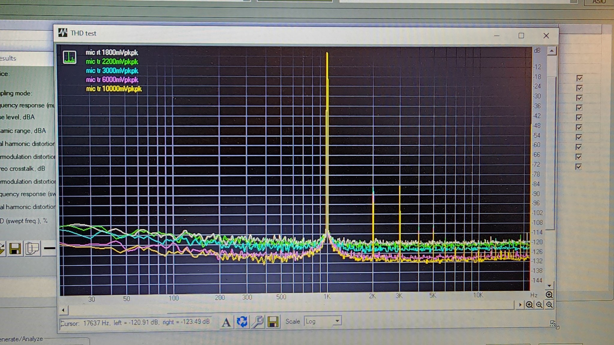

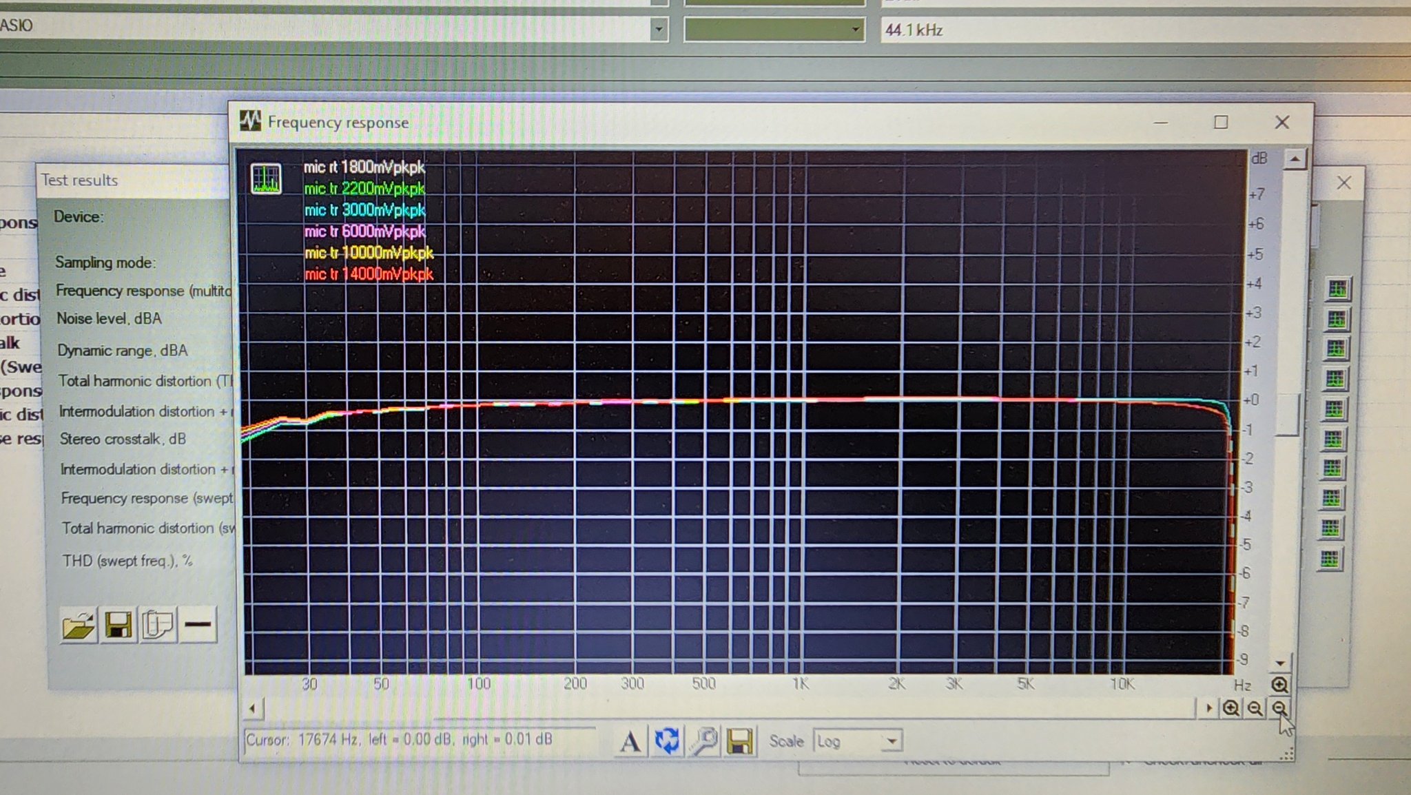

Interestingly, i put those edcors in steel enclosures, to shield them, yet they show 60Hz peak, while those two mic balancing trafos have no shield yet are absolutely clean on the bottom. Go figure. Now i know why my prototypes on the floor perform much better than final projects in case.

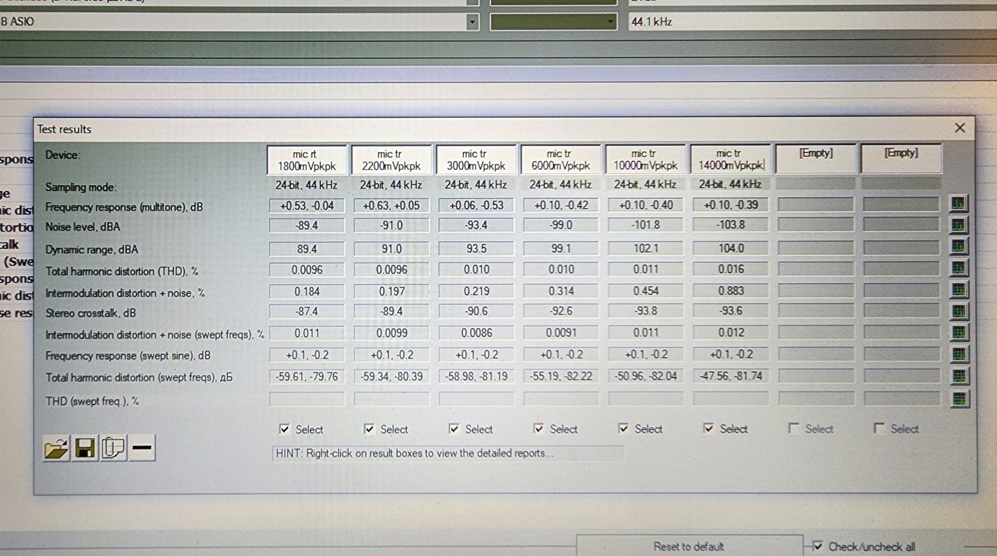

i tried on my M2 defect edcor audioformer and use the Hammond 109N. still strange for me is the excellent test if i use i with 10k load but in the M2 PCb if got just 36kHz fg.
First sound impression compared to the original Edcor was not bad but i have to learn to listen at 1 channel.

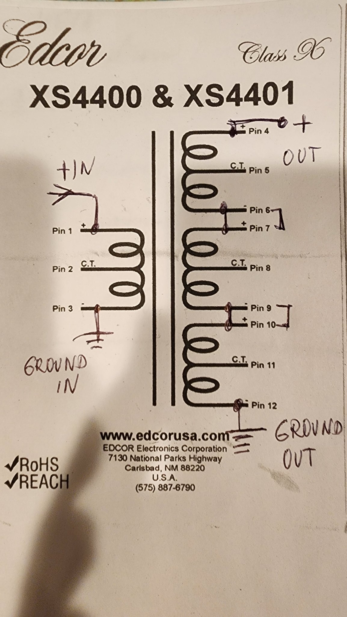

Ed,
Do you mind doing an additional experiment when time allows? 🤓
With your Edcor XS4400, connect it conventionally:
BTW, are you loading these transformers with anything but the input impedance of the soundcard? What is the input impedance of the soundcard?
Best,
Anand.

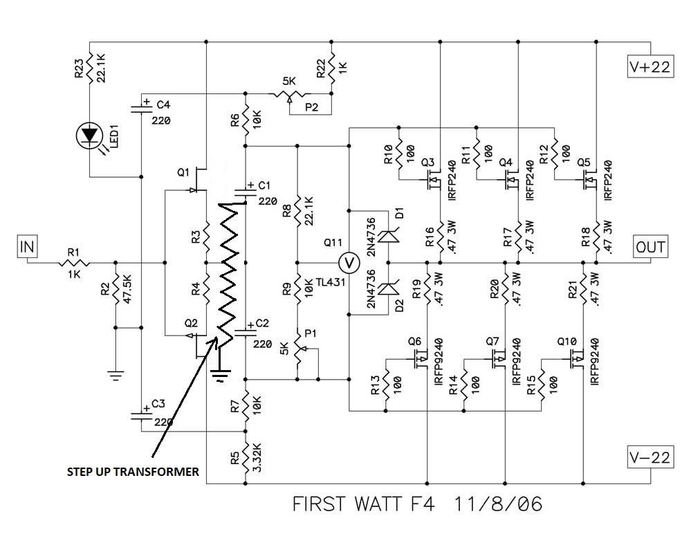

P.S. I would be very curious how this Edcor transformer would perform in an M2 amplifier_it is available in a 1:5 turns ratio.
- Connect the input signal to Pin 1 (+) and Pin 3 (-), the primary of the transformer.
- Eliminate the connection from Pin 1 to Pin 12.
- Connect Pin 6 to Pin 7, and Pin 9 to Pin 10 (i.e. series connect the secondaries).
- Make Output Pin 4(+) and Pin 12 (-).
Best,
Anand.
Hi Anand, not loading transformers, just input to focusrite scarlet.
Yes, i can do the test, will report back.
I can order transformer you linked. But it will take some time to deliver.

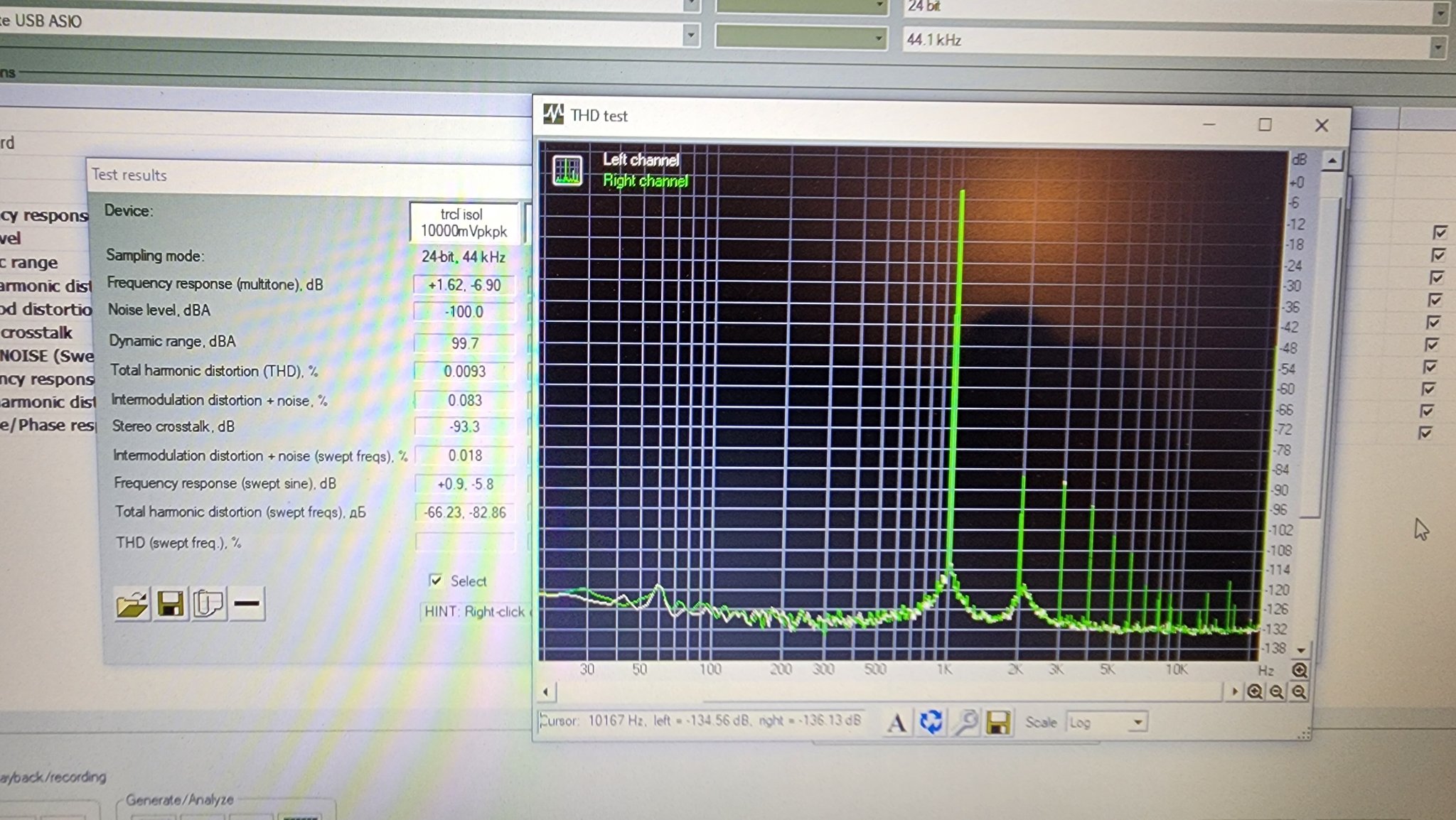

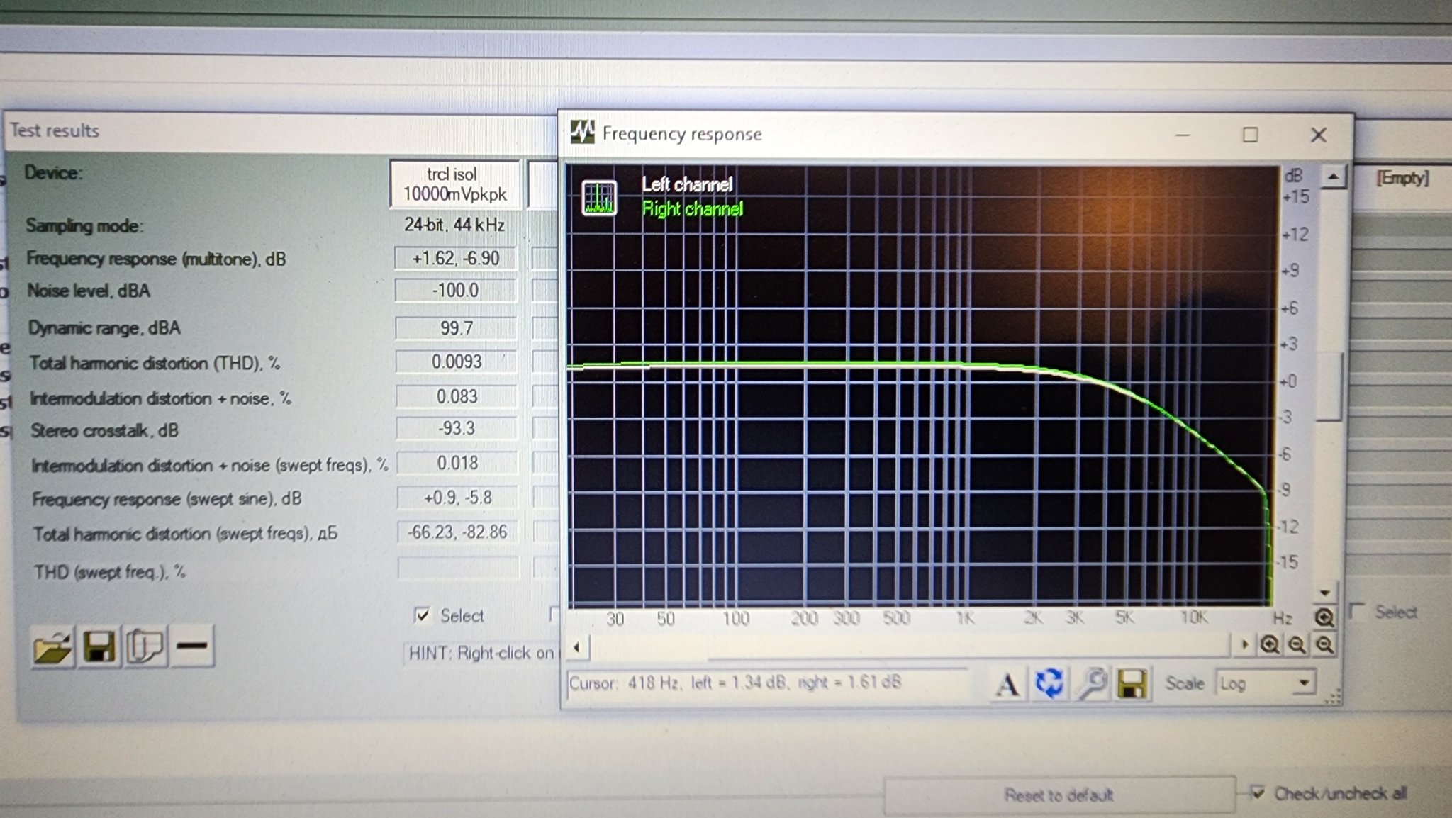

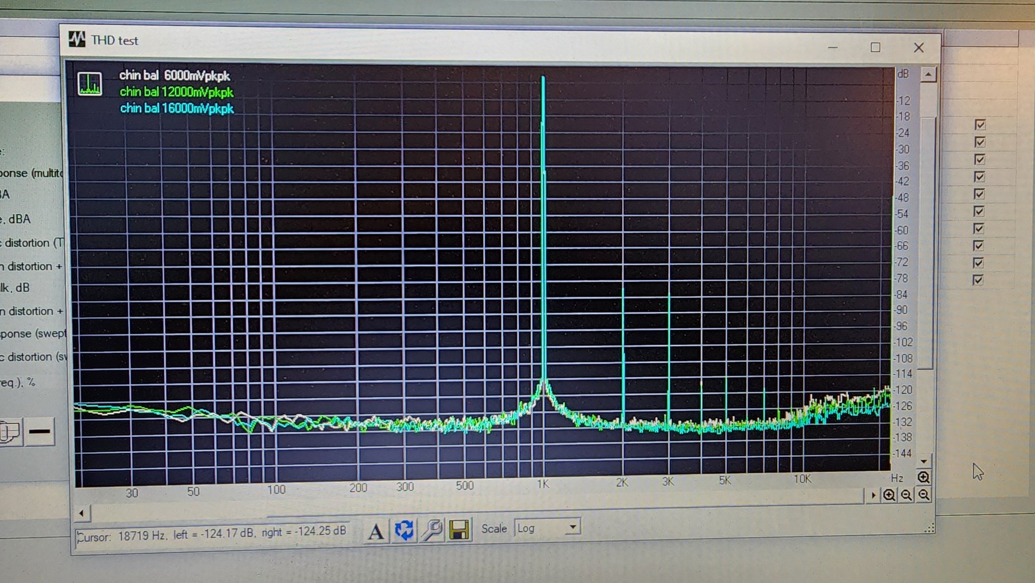

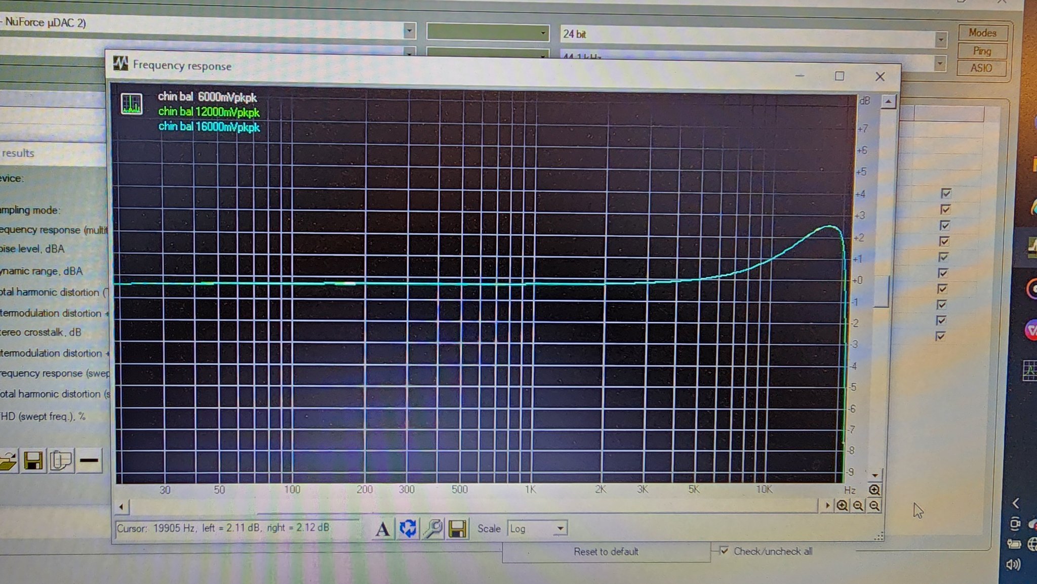

Well, its so ugly outside that i decided to do some more work on big edcor. Instead of autoformer, i simply wired it as transformer. It has four identical coils, so one can do pretty much anything. Used the same coil on input, and three other coils in series for output. Separate grounds, not that its any groundbreaking stuff. This perfectly fixed the low frequencies, ruller flat bottom. However, top rollof is still there, 9dB at 20kHz. Measured very low THD, 0.009% at 10Vpkpk output, very clean. Required ~3.2Vpkpk input for that. Nice decresing harmonics. Surprisigly no 60Hz polution, nice clean -130dB noise, no hum. Breaking ground, or removing cover helped.
Unfortunately highs rolloff is nature of the core, does not depend on wireing. Still can be used if eq is applied.
Interesting - I’m glad you wired it like I mentioned in post 47 (I have no idea how you wired it for the bandpass response you posted after that though!). So the bottom is flat which is good. But top end is STILL rolled off?? 9dB down at 20khz, not good! Can you ask Edcor what is going on and how we need to wire it for flatness at 20khz? Perhaps its due to the interleaving winding nature of this design. Of course, they don’t publish measurements like they did with Mx5cs series. That would be nice to see and to clarify. The Mx5cs looks flat as a pancake.Well, its so ugly outside that i decided to do some more work on big edcor. Instead of autoformer, i simply wired it as transformer. It has four identical coils, so one can do pretty much anything. Used the same coil on input, and three other coils in series for output. Separate grounds, not that its any groundbreaking stuff. This perfectly fixed the low frequencies, ruller flat bottom. However, top rollof is still there, 9dB at 20kHz. Measured very low THD, 0.009% at 10Vpkpk output, very clean. Required ~3.2Vpkpk input for that. Nice decresing harmonics. Surprisigly no 60Hz polution, nice clean -130dB noise, no hum. Breaking ground, or removing cover helped.

P.S. Another thought is to wire all the secondaries of the XS4400 in parallel and check the FR. Pins 4,7,10 together are (+) and Pins 6,9,12 together are (-).

Down by 5dB @ 10khz. No flat response in sight. I wonder if this is intrinsic to this XS4400 transformer design. You’ve measured it as an autoformer as well as a conventional transformer both with secondaries in series then in parallel, all with the same result.

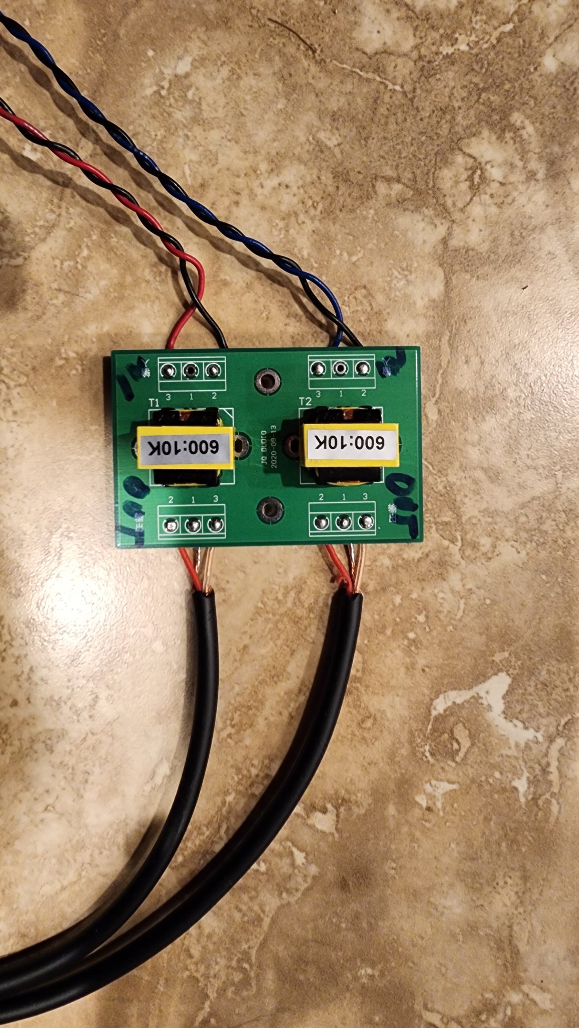

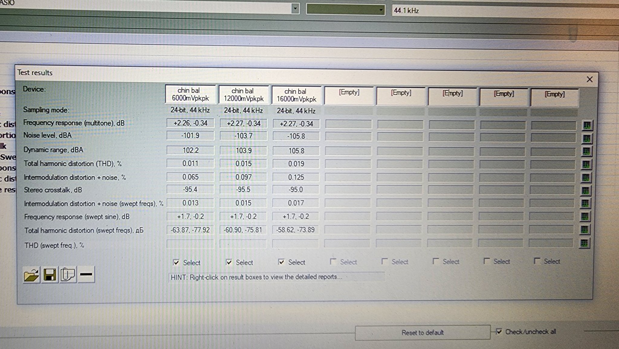

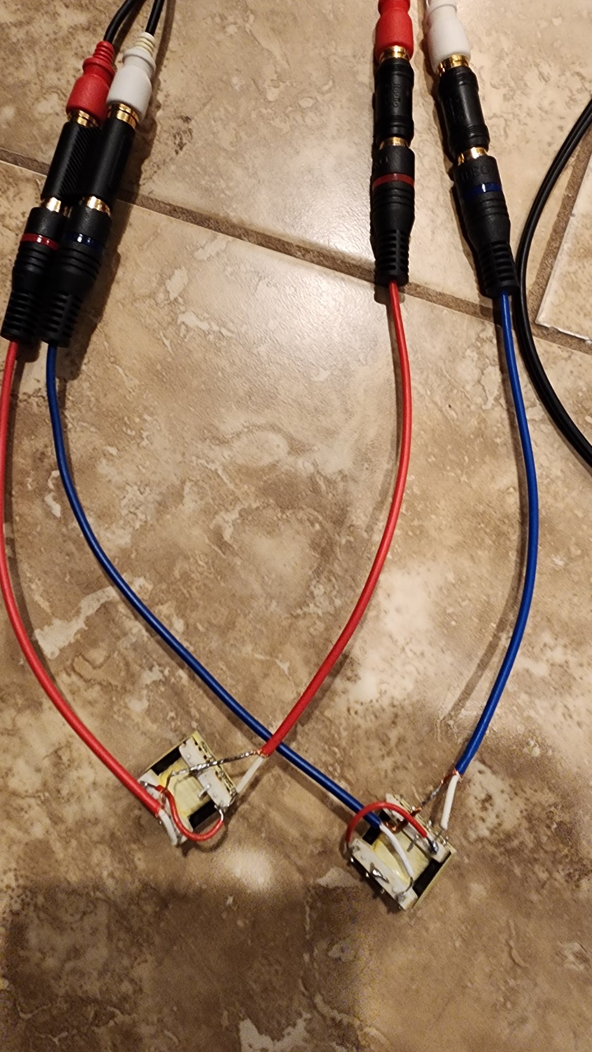

And now for that small audio transformer Triad.

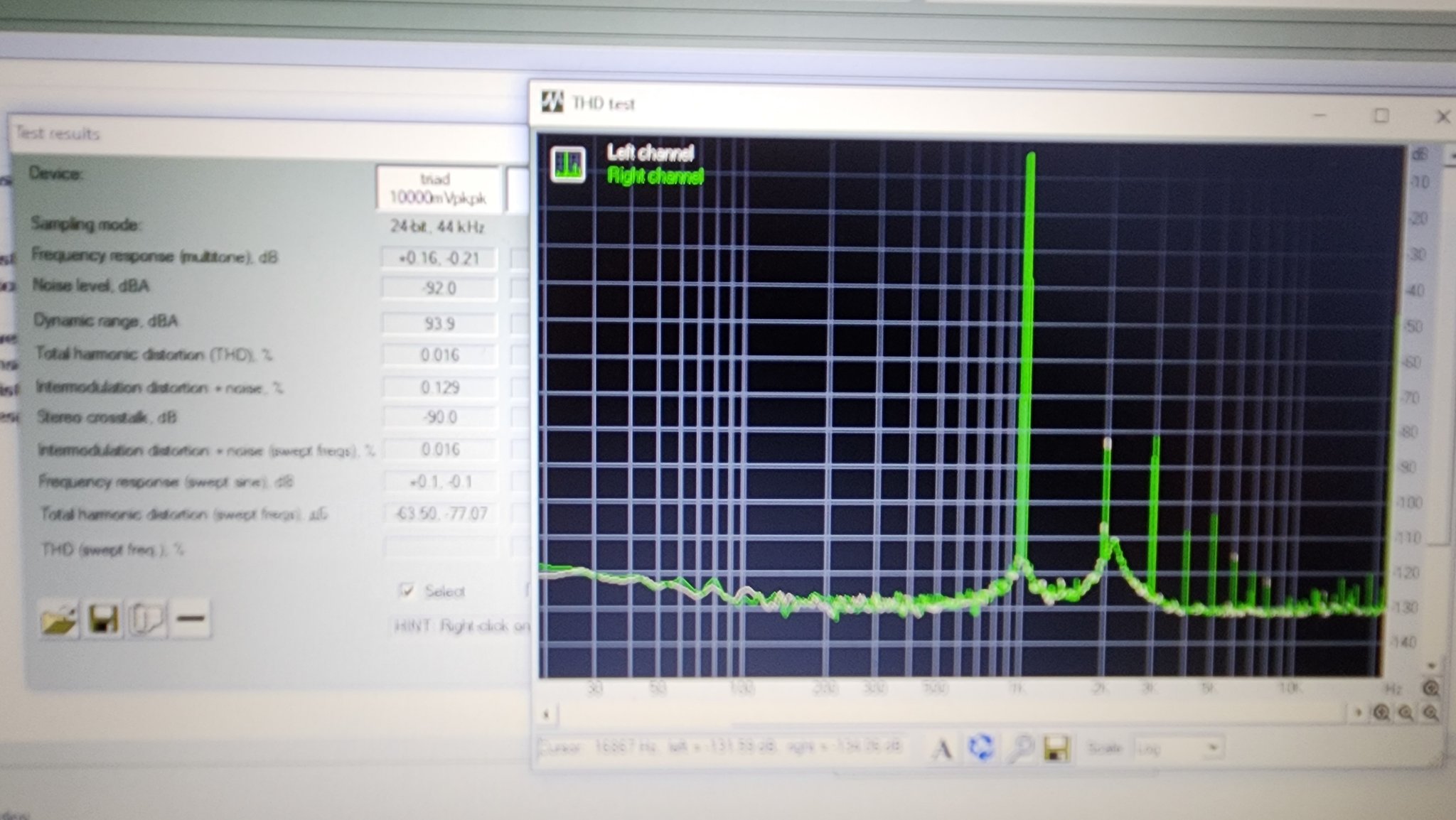

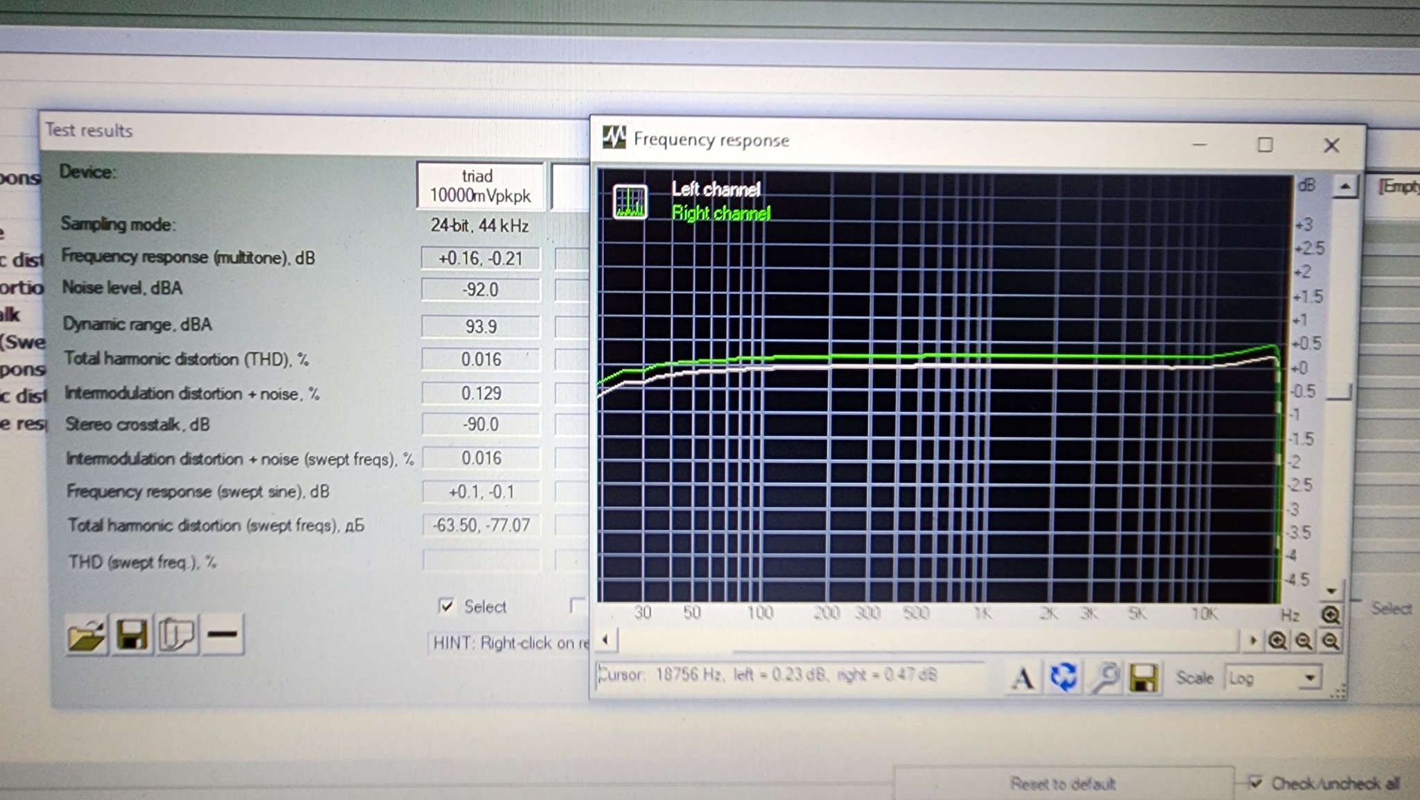

Its not mic transformer, its an isolation transformer, or balancing transformer, with four identical coils. I serially connected each two on each side. Both sides are likely 10k ohm, but i did not bother with dats3.
Resistance is identical. I wired all coils in series as autoformer. Measured at 10Vpkpk output, applied about 5Vpkpk in the middle. It provides respectable 0.016% thd, nice fr response, just tiny lift up, ok spectra. Can be used as isolation transformer, or balancing, or even as 2x gain step up transformer. Lots of posibilities.
