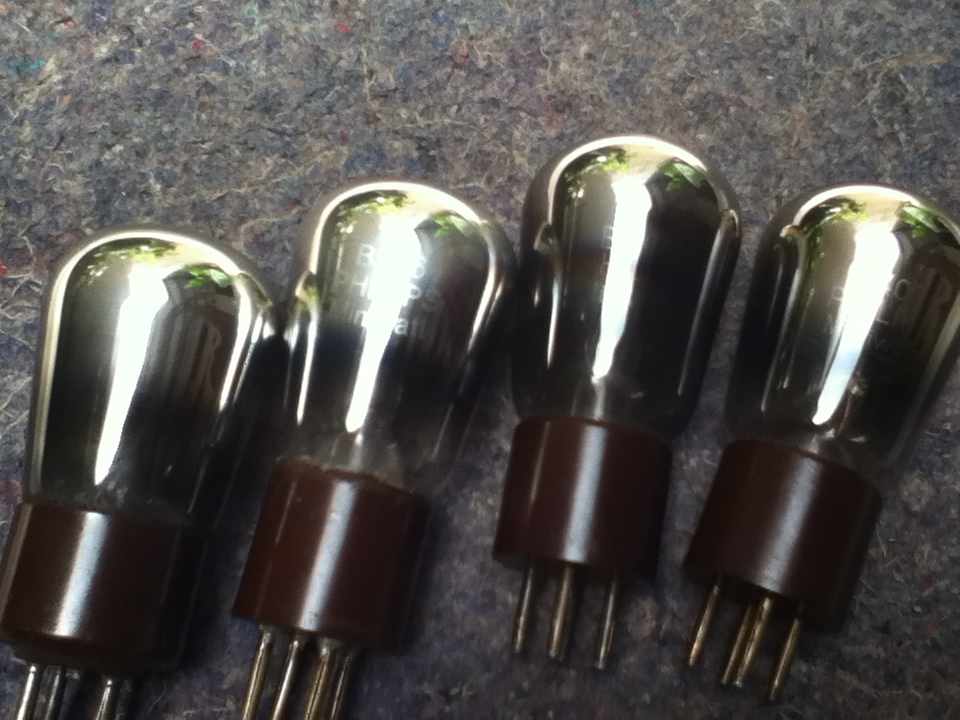

B406 is a tube that my first fell in love with the tube system.:)
When i go to my friend's house, and i listening his system whit B406.
This tube is amazing, I love the vocals sound natural, mellow, slow impression music, my favorite when combined with AZ1 valvo being so real life. (this opinnion is my personal assessment).
This tube may be rare and vintage from 1925, may be not popular as 26.
But I was lucky to get it. My references are triode dick's.

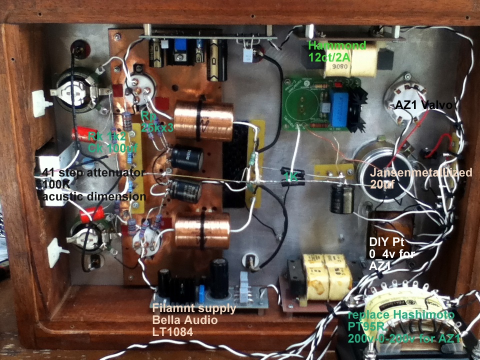

I am using now is a single B406 with ground cathode. enough for me, although small gains.
I still have one more, the newly completed, following the advice of the Manta with OTL. schematic basis of Cleo 4 from Triode Dick's.
I not yet tasted. i will waiting you and friends come to listen together.:D
Thank you, for your support my friends.

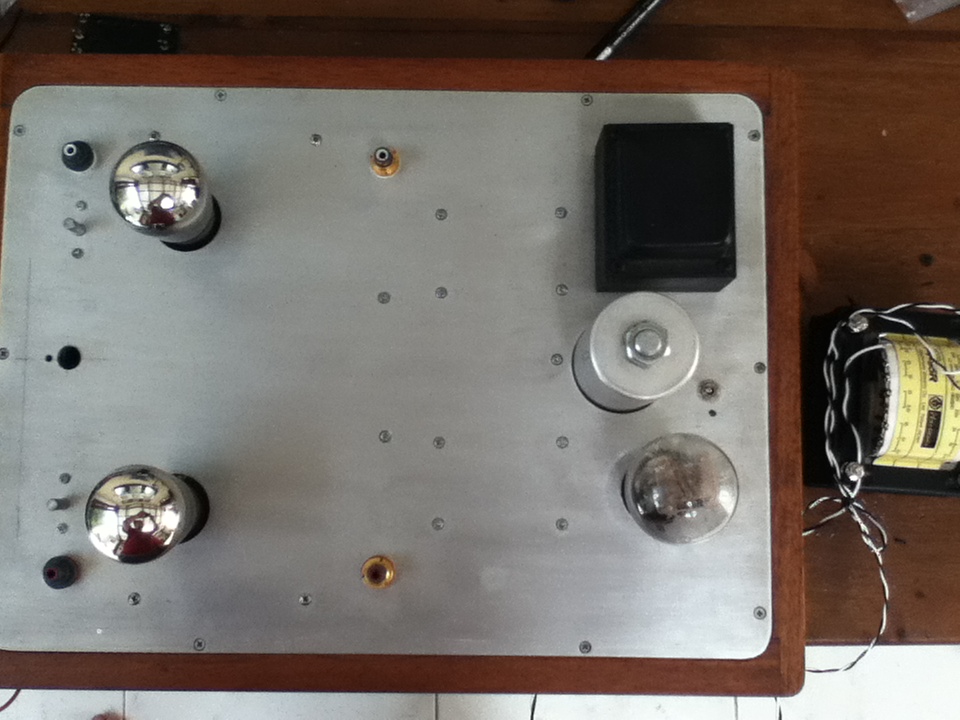

I have another B406 preamp.made that as third diagram of Manta but not used line OT (used R-C=0,45uf)
Rect: AZ1 VAlvo ,
C1 (powersupply) 20uf Jansen Cap Metallized.
if friends have experience with this cap. please share.

Replace B406 with phillips B403.
singel stage B403 gnd cathode
tried add PT hashimoto PT 95R for rectifer AZ1 (200-0-200)
and filement stay from another PT diy 0-4v
B+ 220v
va 95v
Vg -17v
Ra 3x25K
Rk 1k2
Ck 100uf ( i not yet replace with 100uf/50v) because i want step down vg to -15v next.
sound : all around is good and i like.........:D
