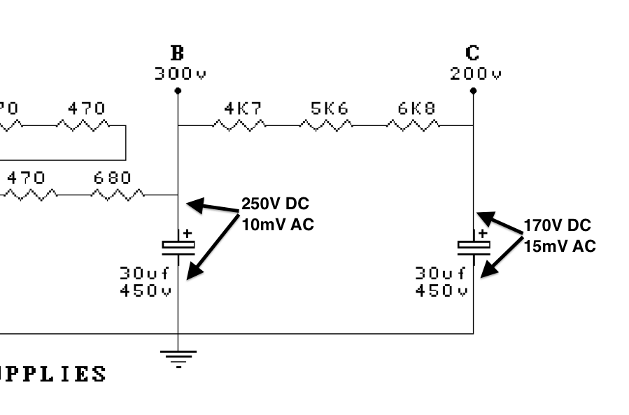

Took voltage measurements of the smaller filter caps, and here is the results
250VDC & 10mVAC (Should be 300VDC, but I have a 100W bulb in line with the power cord.)
170VDC & 15mVAC (Should be 200VDC, but I have a 100W bulb in line with the power cord.)

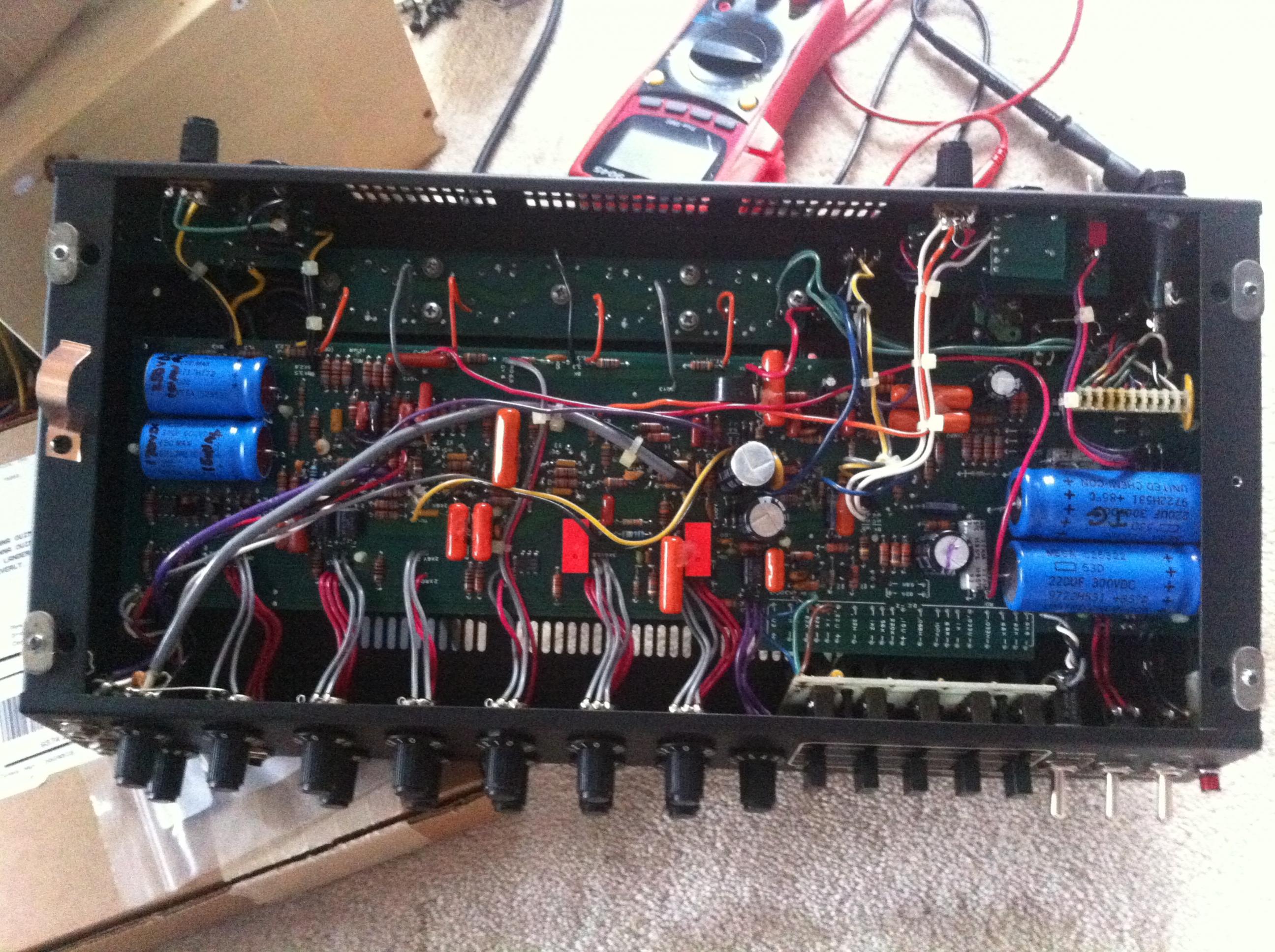

Can't measure the main 220mfd 300V caps because I can't reach the other side of the caps unless I desolder a bunch of wires and pull the board and jumper everything back in thanks to the MB's terrible design. 😡😡
I don't think I really want to do the repair, but I do want to at least find the fault.

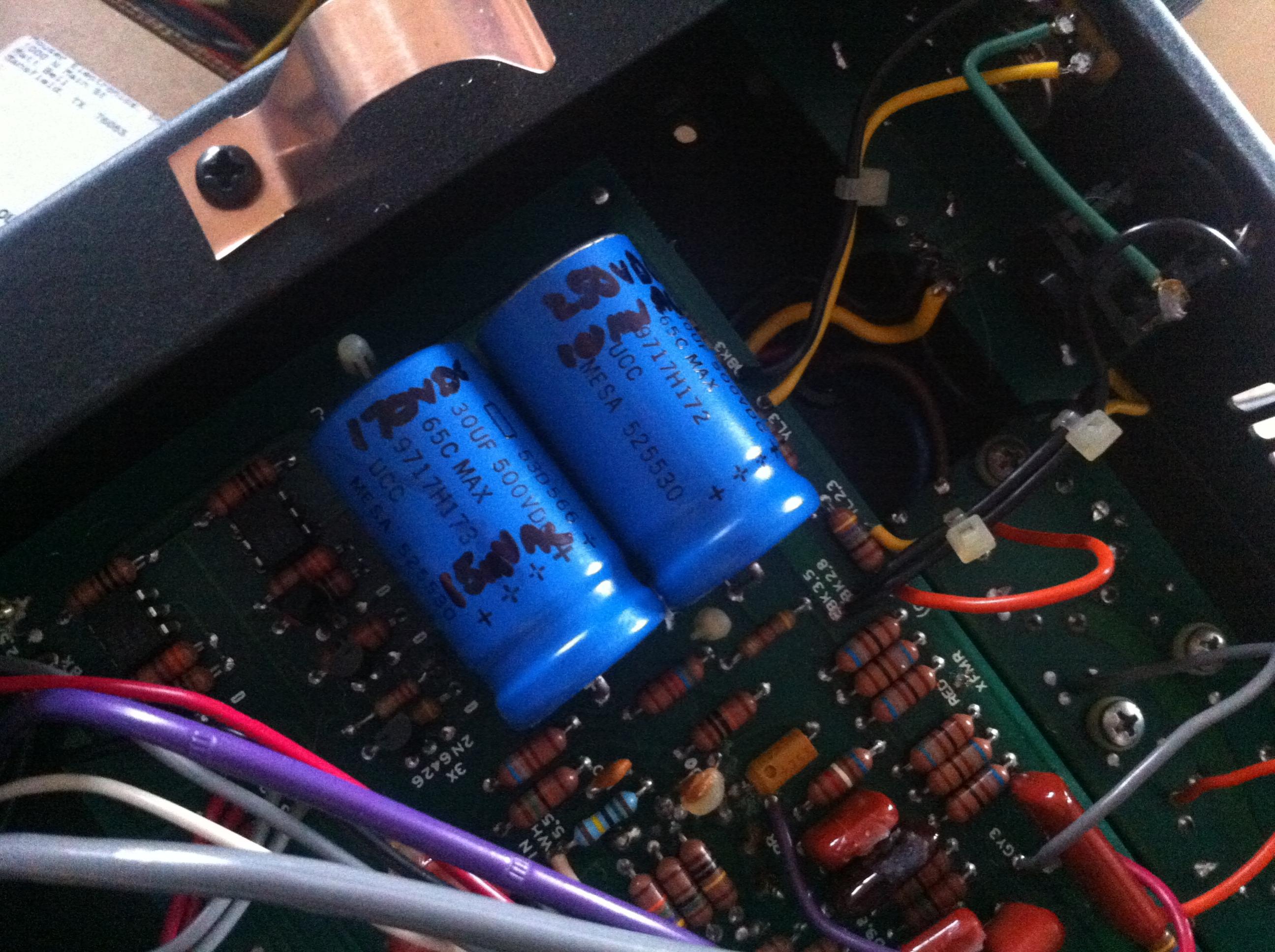

Still messing with this PITA. I decided to replace all electrolytic capacitors and diodes. I know shotgunning isn't recommended. As Enzo states "Its like throwing sponges at a rainstorm"
I didn't have high hopes that doing what I did would fix the issue, and sure enough it doesn't.
I know I've said it before, but the is a PITA!! Have to remove all pots, desolder nearly 20 different wires, and maneuver the board out with the stupid plastic nylon standoffs. 😡
Besides sending it to Mesa Boogie.. any other suggestions?

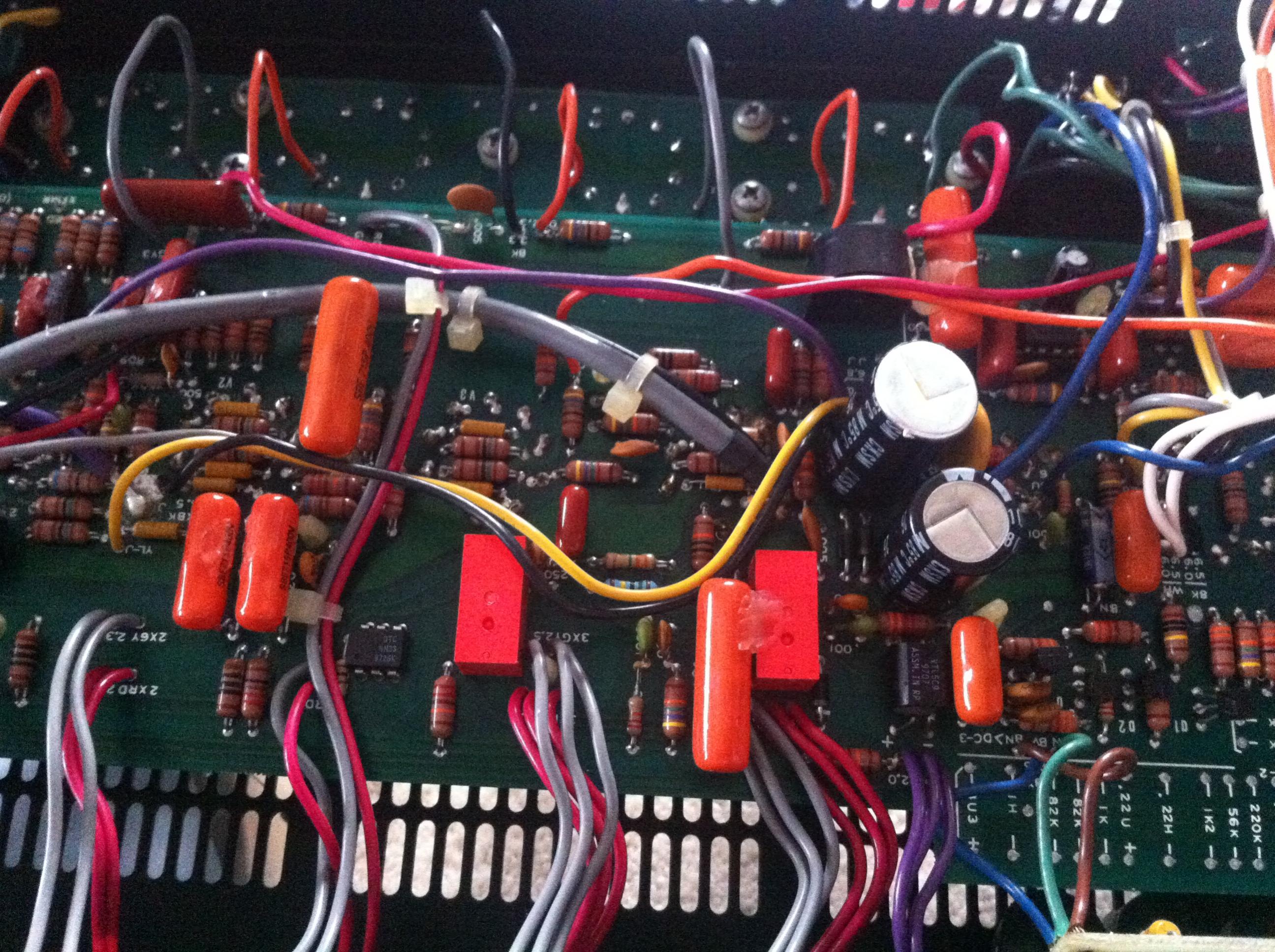

after checking out your you tube vid and the schematic and my failing memory i would be suspicious of the relays and their supply the fact that you get no sound on one channel and the weird fart noise on power down i remember this as clues in previous repairs that lead me to replacing relays only to discover bad zeners and bad 16 v filters in the switching matrix supply
ouimetnick
I replaced all the diodes. 🙁 what do those relays actually do?
one of the relays is channel switching the other is selecting which channel the reverb is applied to.
i was wondering do you have the footswitch if i recall this amps lead channel won't work without it.
or was it something about push pull controls being set right, might be another model i'm thinking of ...
the matrix circuit in these can be finicky
did you in fact replace all the diodes because not all are the same type! which ones did you replace?
