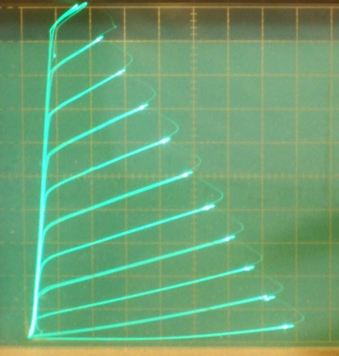

My experience has been just the opposite. The big hot octal tubes develop loose bakelite bases when the glue to glass interface fails. So many old octal tubes with adhesive tape wrapped around the base to glass joint. That's why they came up with the octal button bases later, which are more like Compactron bases.
If you have cracked a Compactron, Novar or Magnoval base tube, then you have a bad socket. Lots of old TV sets had cheesy sockets with tin plated socket pins that soldered themselves to the tube pins in the heat. A quality socket doesn't have such problems.

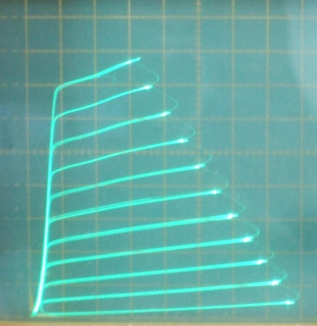

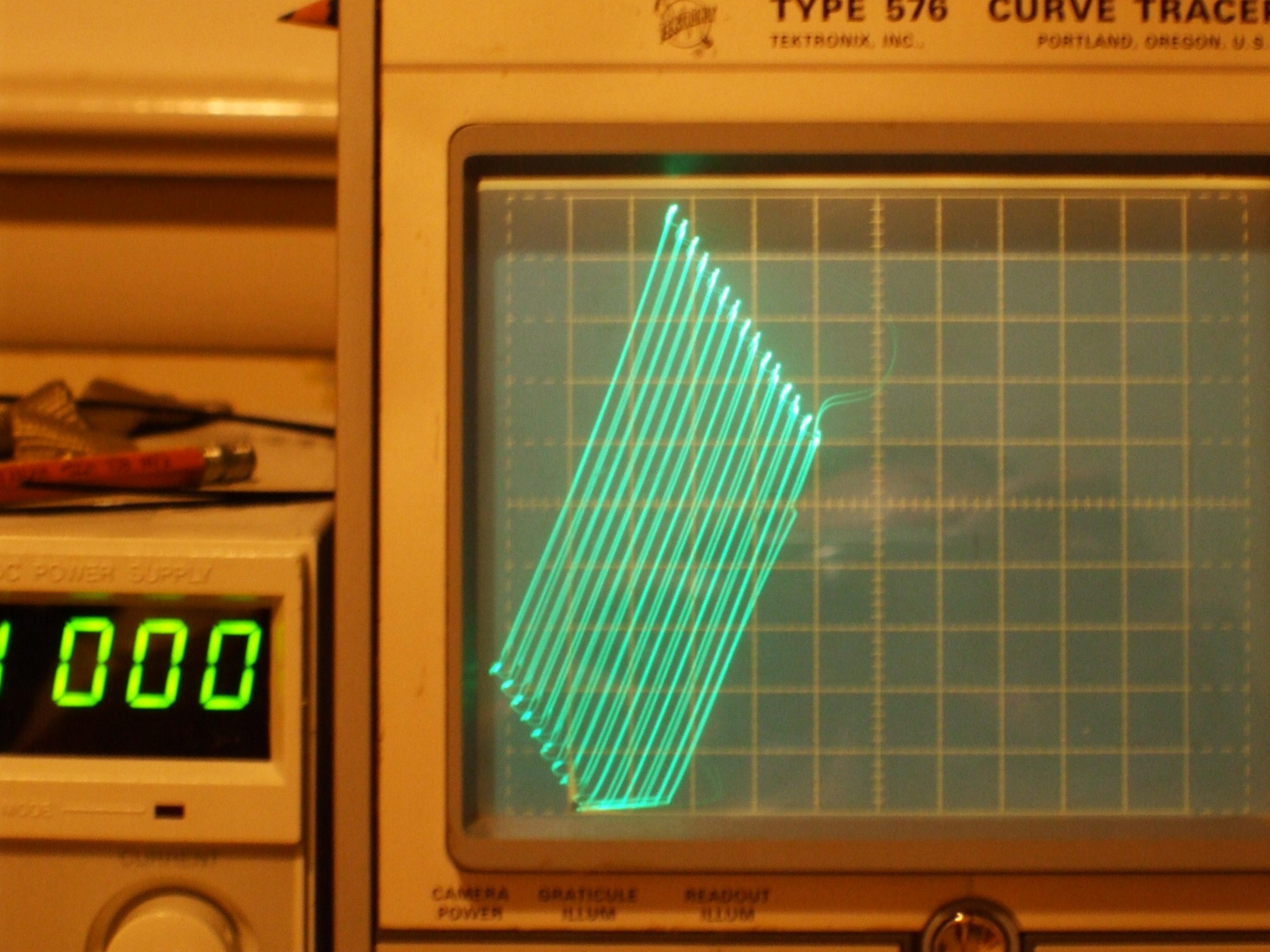

For audio purposes, the lower gm "audio" tubes generally do have a straightforward linearity advantage (if you are not using the extra gm for N Fdbk that is). However, with N Fdbk, even just local N Fdbk, the balance can tip the other way.
This is especially apparent with the latest design developments using TV "Sweep" tubes. Crazy drive has given us constant gm (versus plate current) beam pentodes without even using N Fdbk (feedforward actually).
Then the "new" series Schade local N Fdbk (UnSET, CED) can produce Triodes from "Sweeps" that rival, if not exceed, the best DHT triodes. (no plate curve rollover from mis-match between grid1 and plate or grid2 characteristics, greatly reduced distortion.)
Finally, Crazy Fdbk, combined with the "new" series Schade scheme (UnSET, CED) has now given us "Triodes" with constant gm and straight line plate curves. A Load Invariant constant gm lack of distortion. This is the proverbial "wire with gain". This has long been the mythical Holy Grail of tube design (or any amplifying device). Like Alchemists turning Lead into Gold. It's for real now. These are exciting times for those in the know. I would even say an historic moment.
One can exceed the quality of the best DHT tubes now without having to use extreme HV B+ or high primary Z OTs. One can make a cheap 211 or 212 Amp equivalent for a few hundred $. Without hazardous HV or compromised OT frequency response, and with low output Z. Maybe no flashy big transmitter tube look or heater illumination, but it's now a practical DIY project for everyone. Where is Heathkit when we need them?
a) Crazy drive
b) "new" series Schade (UnSET, CED)
c) Crazy Fdbk with the "new" series Schade drive
d) some $1 TV tubes don't even need any circuit tricks.
just for comparison:

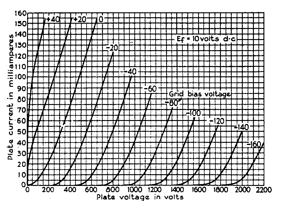

e) 26LX6 native beam pentode mode
f) 26LX6 Crazy drive mode
g) 211 DHT triode
Unfortunately, many of the once low cost TV Sweeps are approaching about 1/2 the price of "audio" tubes now. With demand will come new production eventually, hopefully, like the cap-less PL509.
