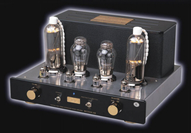

This 300B driving 805's appears to be almost a direct copy of the MingDa MC3008AB of which I have one of the first production units (s/n 10). It had power supply issues which I fixed by replacing the entire power supply with a much improved model inside a larger custom enclosure of my own artistic design. I also went to great lengths to engineer a complete integrated cooling system. Those 805's dissipating 120 watts each as radiant heat really cooks the adjacent black transformer enclosure (which was not ventilated), and the acrylic top cover. The factory supplied output iron is generously sized and the audio circuit is well conceived. If the power supply has been improved this amp represents really good value retailing under $1,000.00 US.

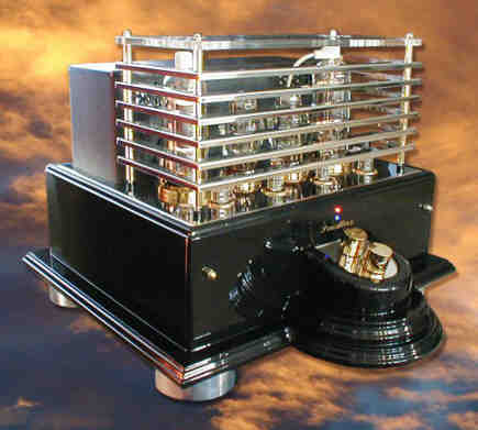

Here is a picture of my custom work. 18 coats of piano black lacquer on a hard maple, copper lined box. The now about 130 lbs. beast is large and contains about 10 transformers including a large Hammond plate xfmer and choke input filter on the high B+ rail. Original HV supply was a C-R-C doubler circuit (that melted taking the power xfmer with it). My heavily modified amp has been in almost daily use for more than two years with no problems.
I love this amp so much I'm sure I'll never part with this unique personal DIY custom copy It has the SET magic I love and the power (40 watts RMS/ch) of a push-pull.
This is the first showing of this project on DIY forums. I was keeping it under wraps.
