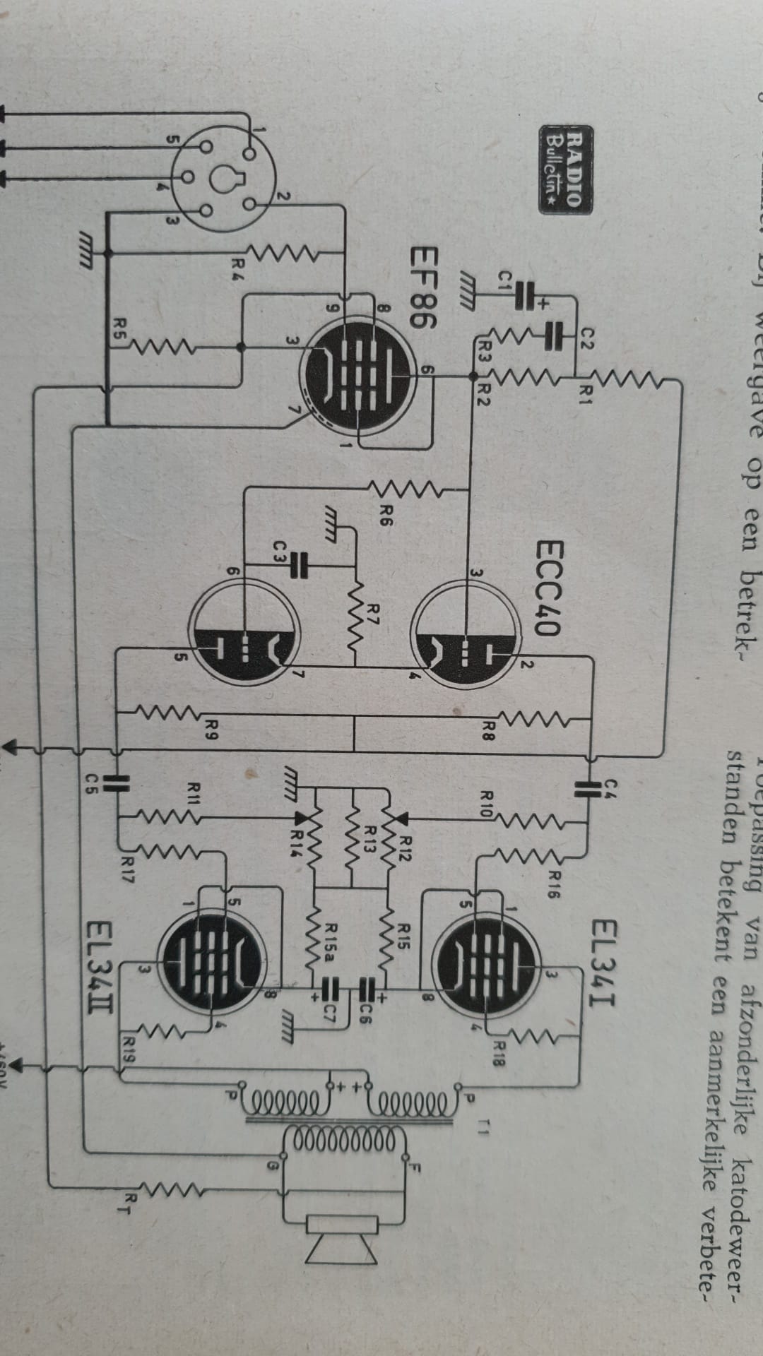

This sort of the same, from an 1958 book. R15 = 500 r13 = 75 R12/14 47 K.
Indeed like someone said a "too hihg"Rk and some postitive bias to thr grid. This makes things more stable. And all the tube current does not need to go through a pot.

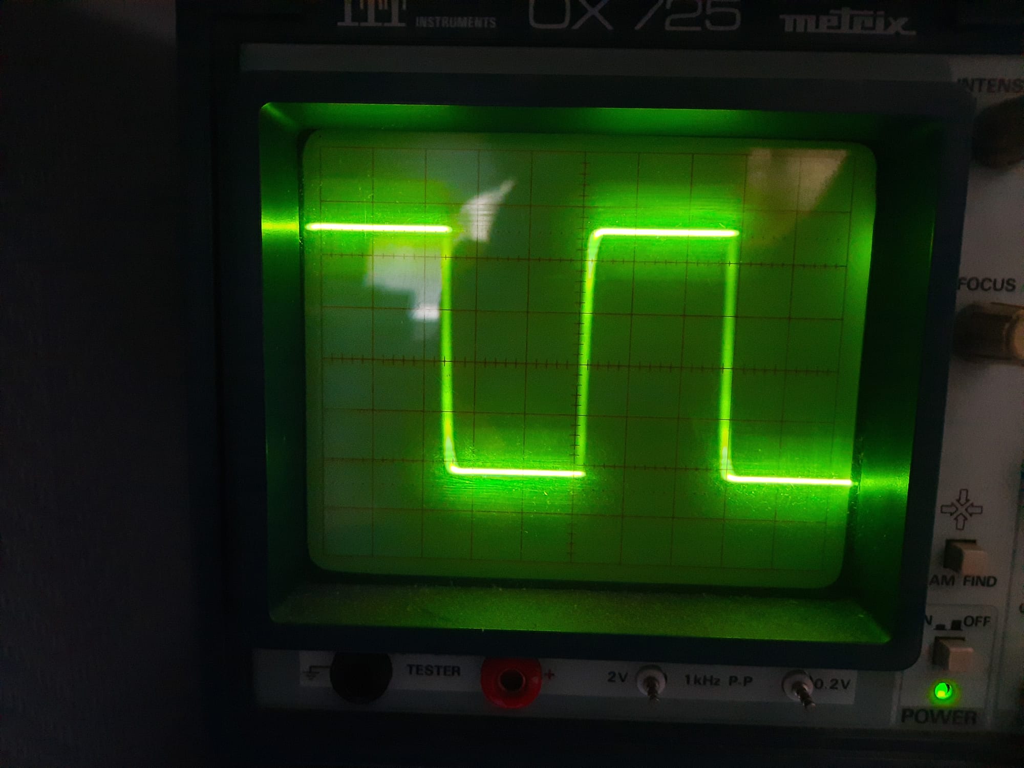

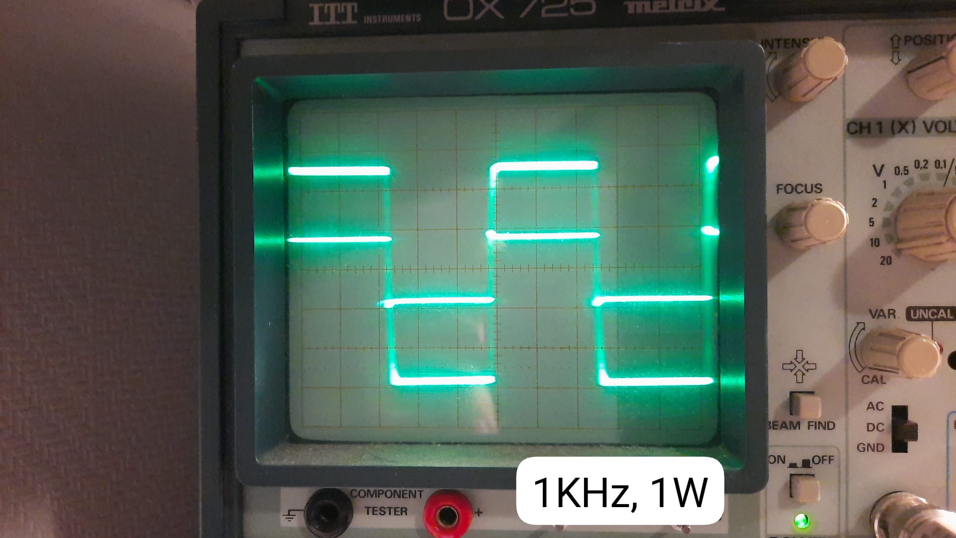

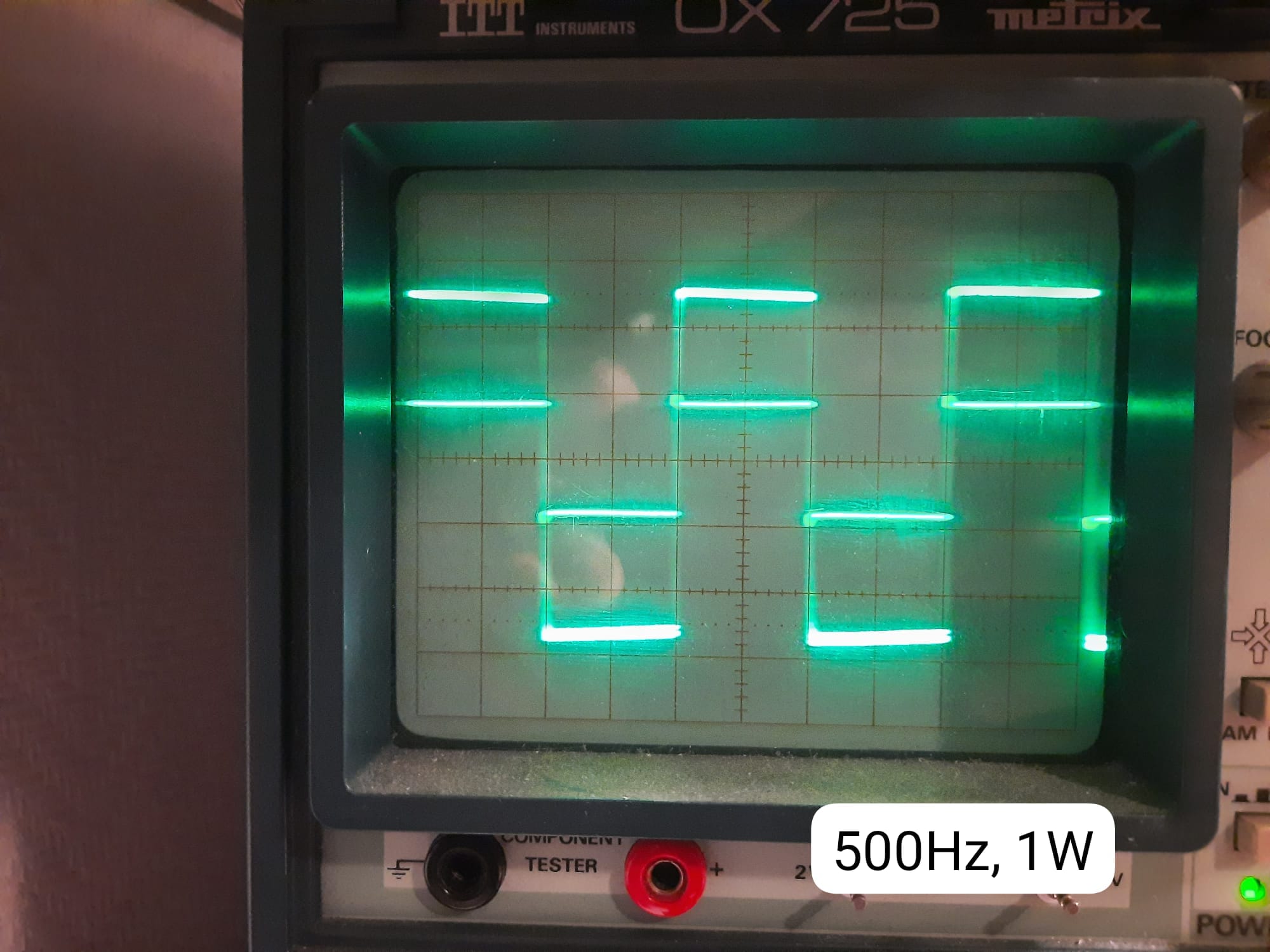

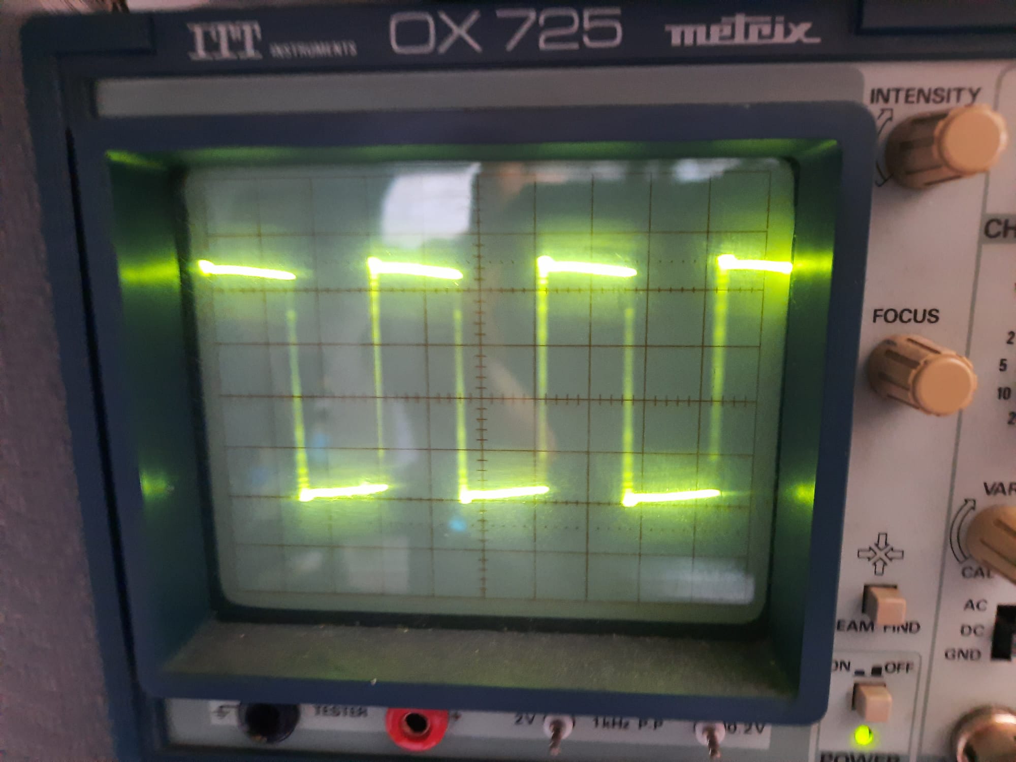

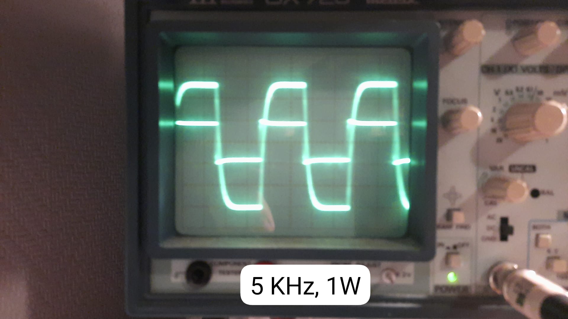

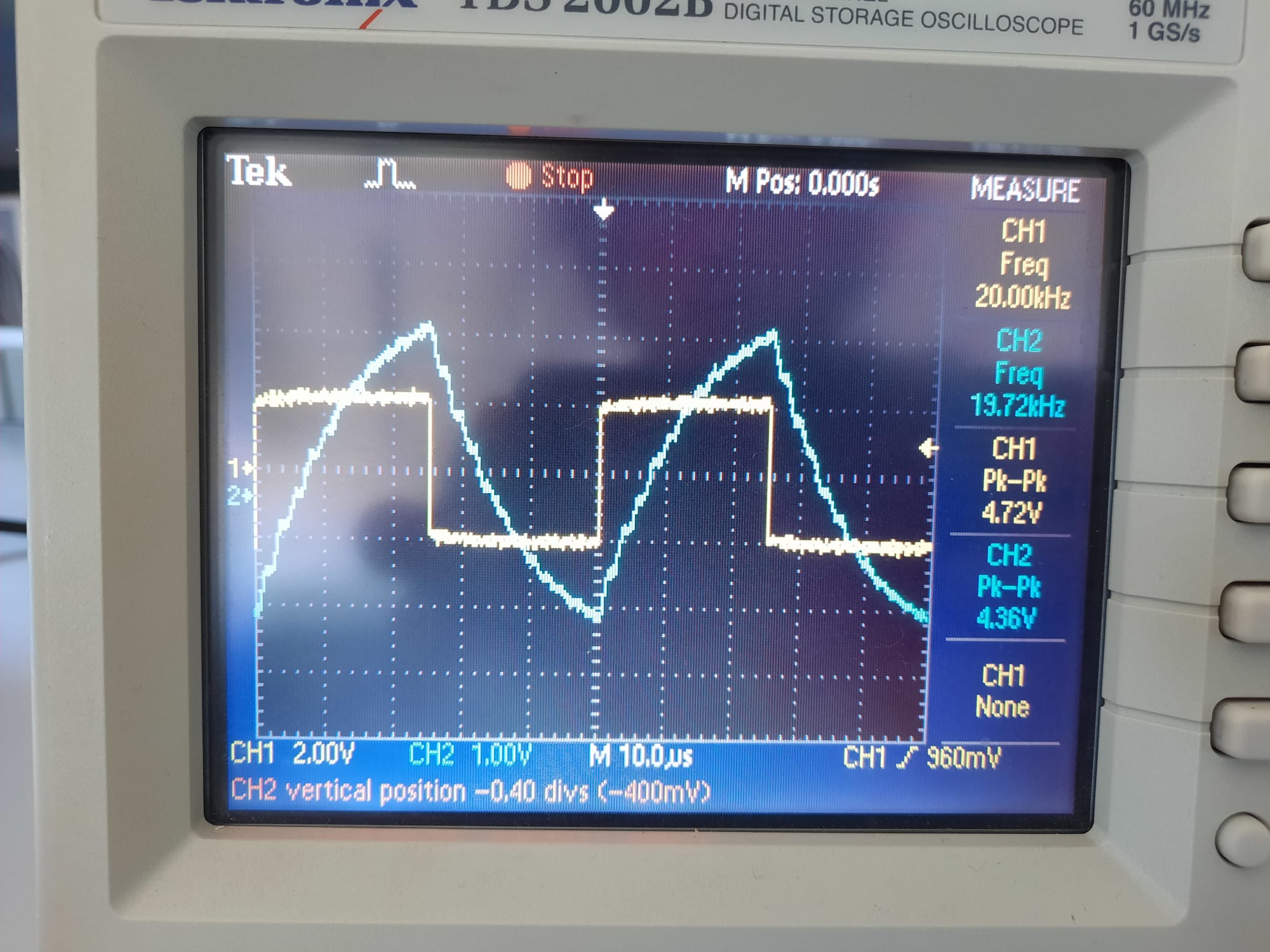

this is the result of the square wave.Can you post the 1kHz 1W square wave response?
Good, try to tame down that overshoot by adjusting the input stage RC network, by increasing the C.
Be sure to load the speaker output with an 8R load for this test.
Much better. You may want to add a Zobel across each amplifier output for using actual speaker loads.
The usual 0.1uF pp film in series with 10R 3W or 5W should work ok.
If there's no room inside the chassis, the Zobel can be external, across each amplifier output.

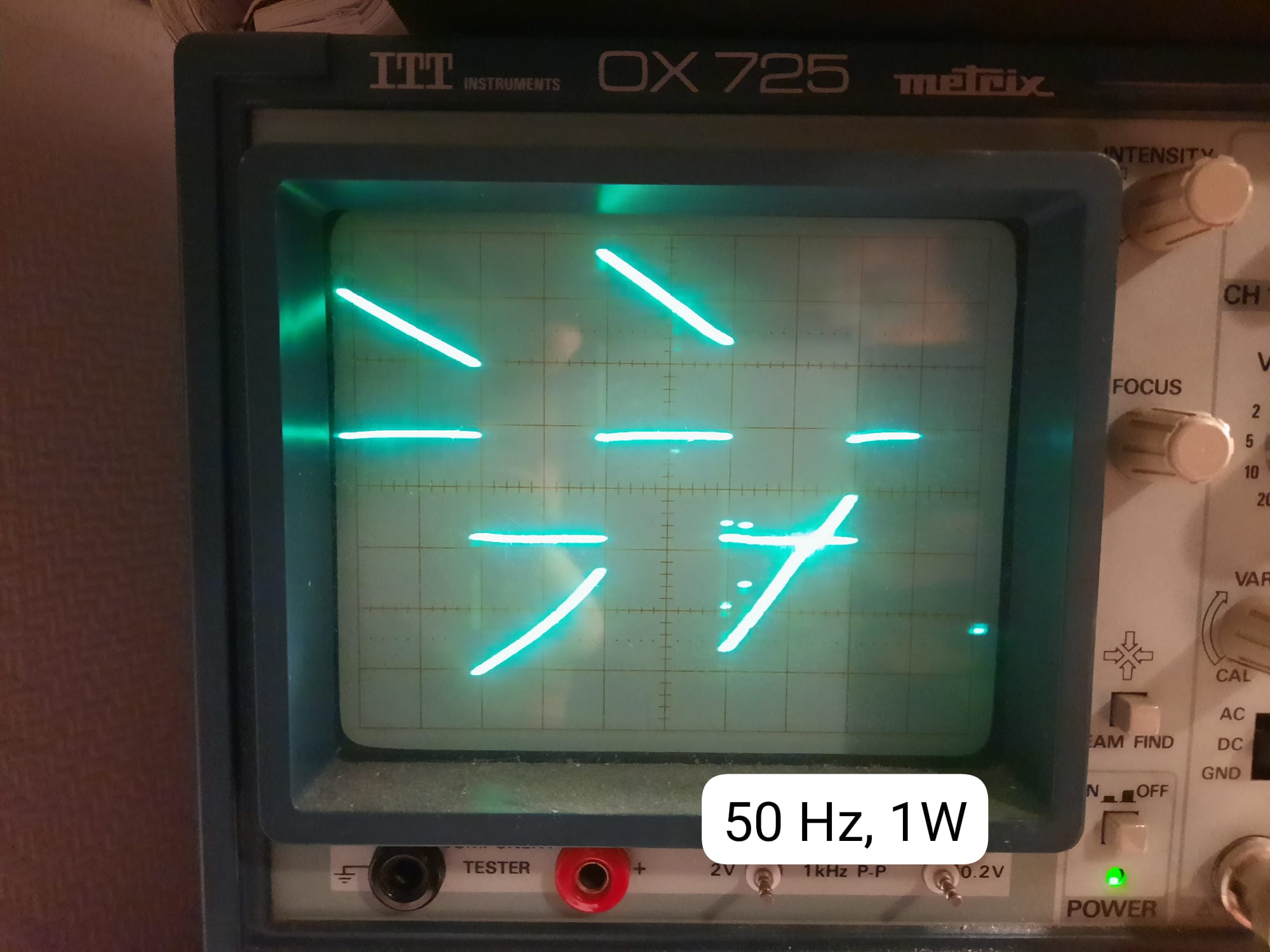

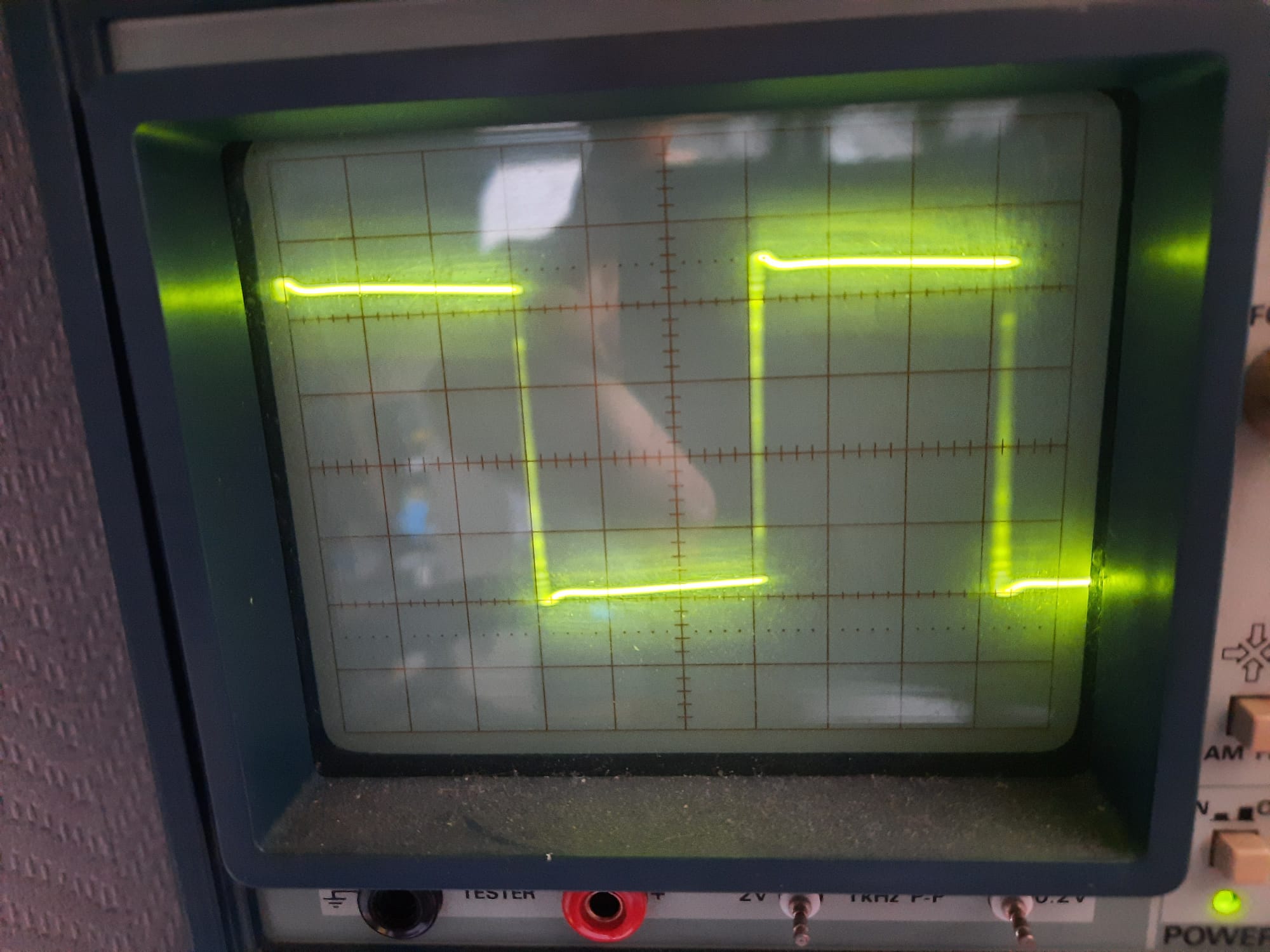

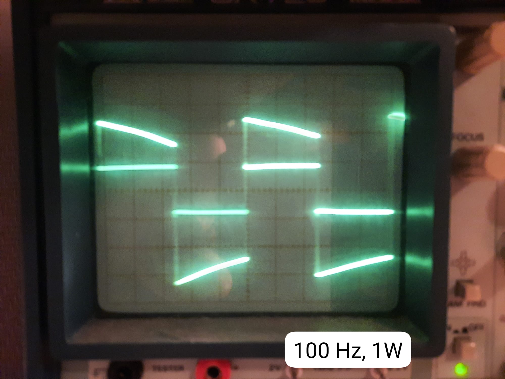

How does a 1W, 100Hz square wave look into a dummy 8R load?
I will test the 100Hz tomorrow.
Are there more frequencies I should test?

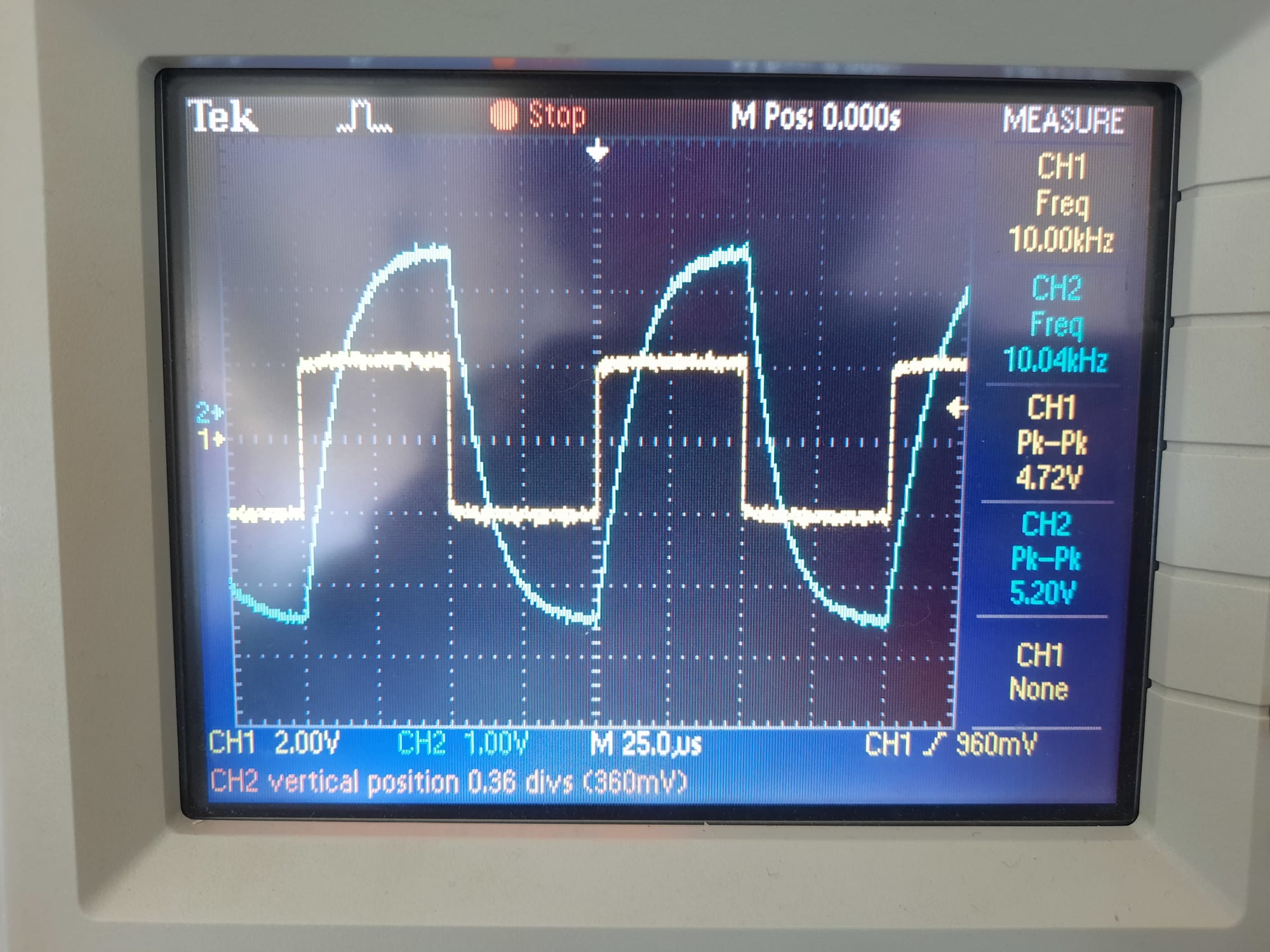

It dit take a little longer for me to do the tests.
But with the zobel network, this are the results

Looks good, and the no-overshoot square wave is better.
If you are inclined to experiment further, try cutting the value of C in half.
Around 0.047uF, depending on what values you have around.
If the 10kHz square wave is still monotonic, that will be good.

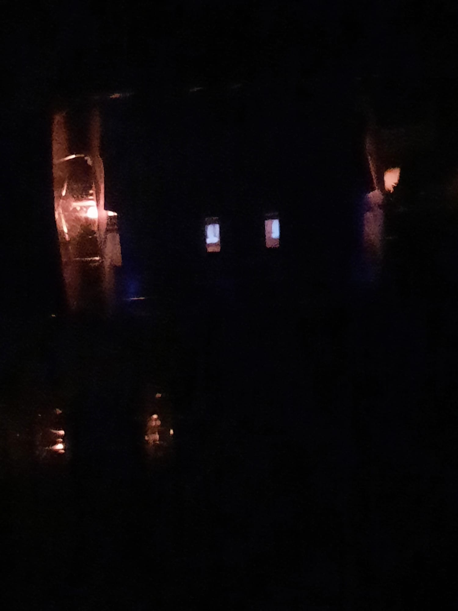

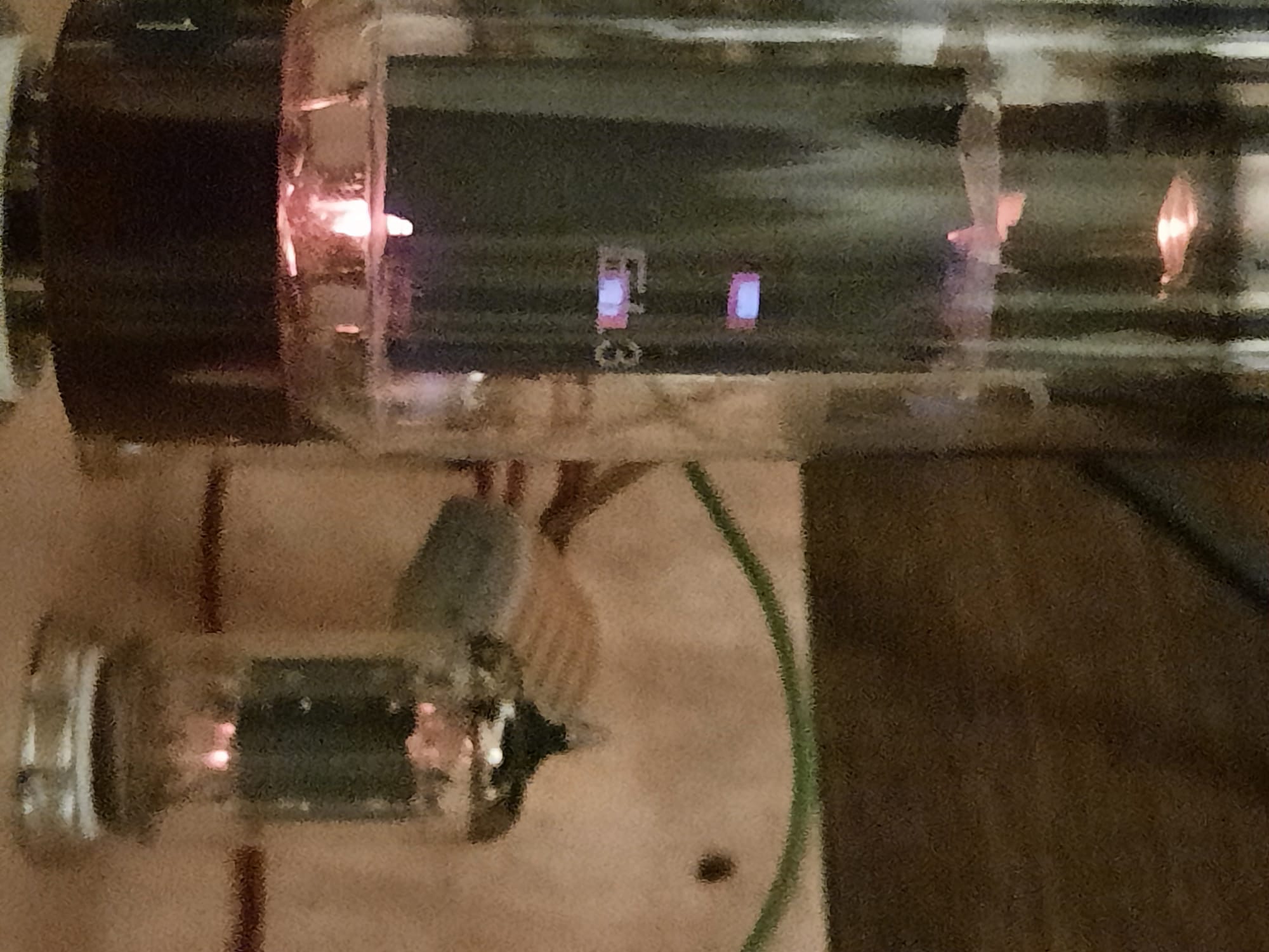

I also notiched that my tubes are glowing blue on the inside.
Is that normal?
I am going to use bigger capacitors for my power suply.
at this moment I am using a 47uF cap.
Is that normal?
If using a capacitor input filter and tube rectifier, make sure the tube can handle the input capacitor.
The blue is ok.
The blue is ok.

2. Often, some blue glow is normal.
Sometimes it is not.
Your picture does not have enough detail to show the difference.

You will need another resistor ot ground piint at the 10 ohm cathode resistors so that the plate current has a place to go.
The grid bias can be around -30 volts for this tube.moving this with a pot between -30 to -40v will balance the tubes.

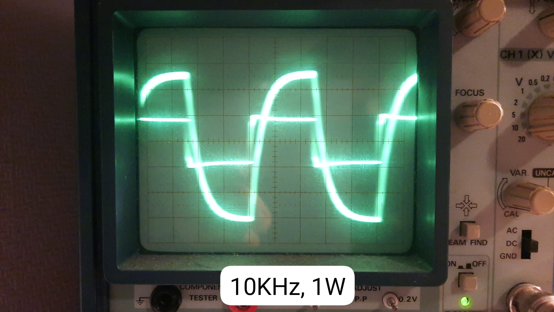

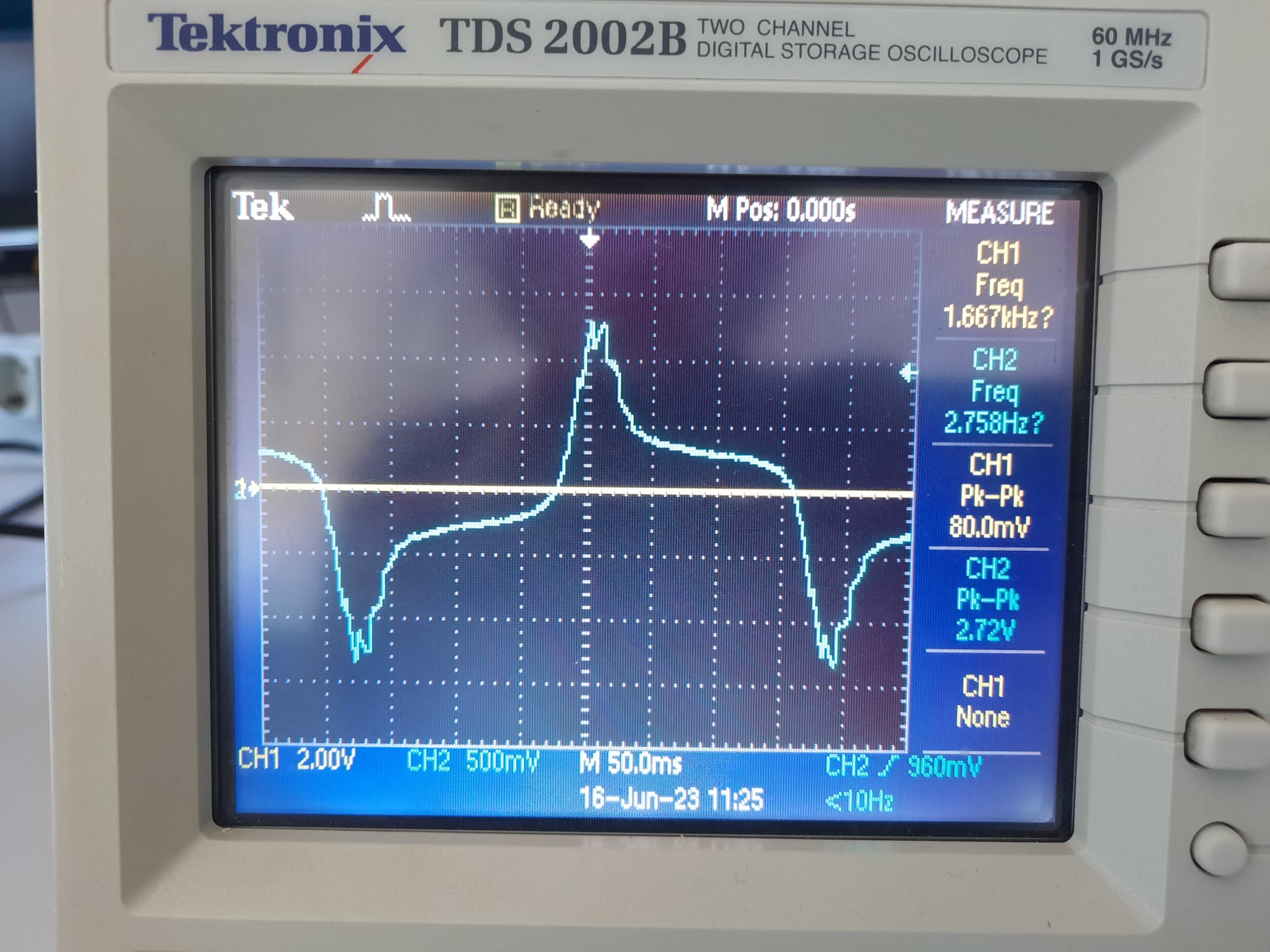

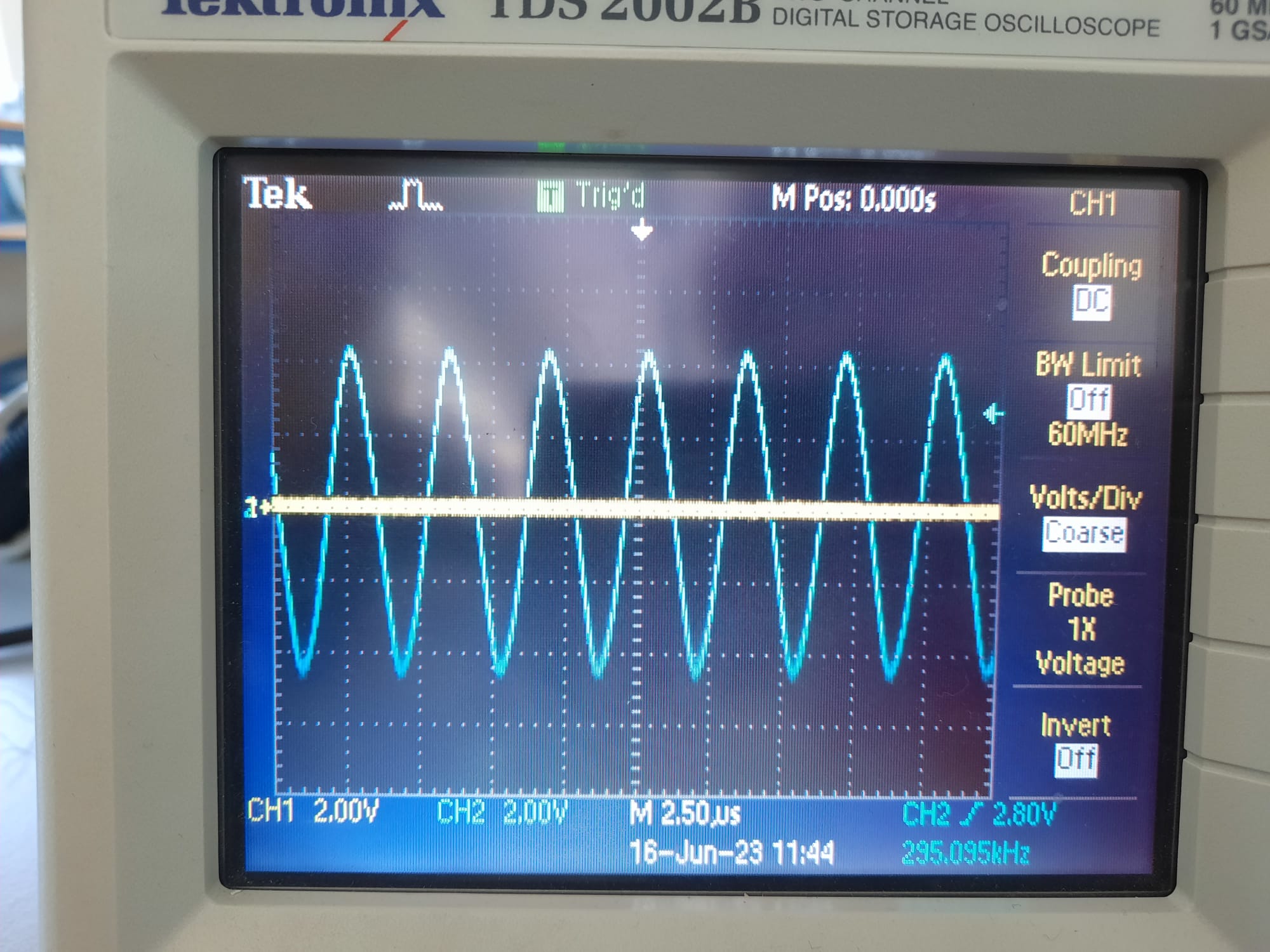

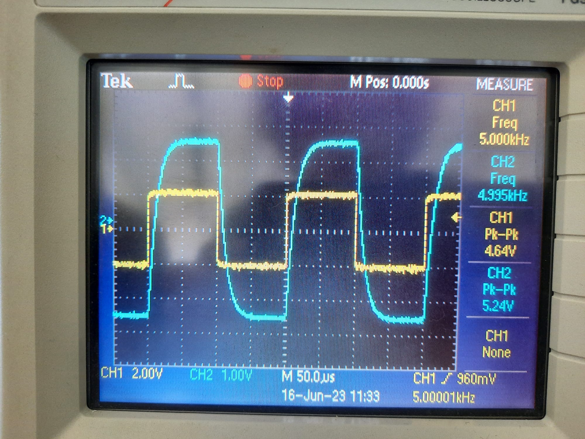

So, today i have made some pictures using my schools equipment.
The square wave tests are looking pretty much the same after changing the capacitor.
But i have a better picture of the hum that my amplifier has.
At the speaker connection i see a hum with a frequency of 2,75 Hz.
I need to search where that comes from.

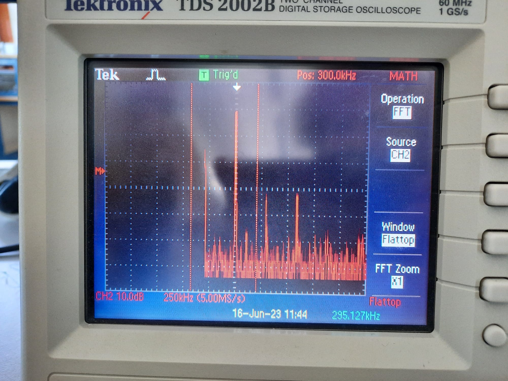

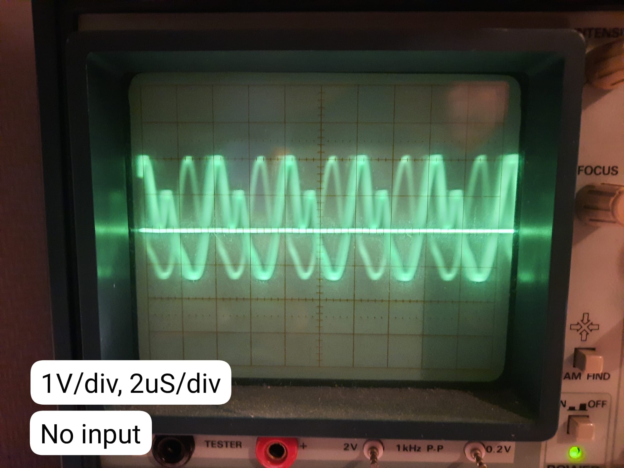

But then i did also look what my EL34 has as input.
And with no input, there is a 300KHz signal (8Vpp).
That should not be there, as far as i know.
I also did a FFT (fourrier analyse), there i saw that i also have some harmonics of this frequency.
There I saw that 600, 900 and 1200 KHz are present as well.
Should this be a problem with the feedback?
Because at this moment, i dont know where i should look for this problem.
finaly, i tried to measure here and there with my teachers.
And when we placed the oscilloscope on the 2 speaker wires,
the hum almost dissapeared completly. there was only 20mV amplitude left.
I can't speak to the hum issue, but those square waves are too rolled off. The amp is really rolling off on the high end. What you had the first time was better, IMO. A little overshoot on a 10K square wave is fine. There's is no ringing so the amp looks pretty stable. I would either remove the zobel network as not necessary or reduce the phase lead cap across the feedback resistor.
