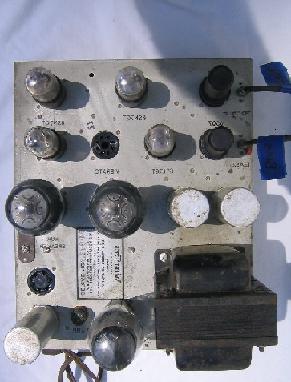

Hi Everyone.
I'm new here and a DIY type guy. I like drag racing and electric guitars and amps.
I have a Wurlitzer #6144 tube amp and would like to make it useable for an electric guitar. Any input from the members sure would be great.

Hi Paul, suppose you should be a rocker !
I'm a new here in diyaudio too but a veteran in wurlitzer 6144. Originally, the amplifier was used in an antique organ to push a jensen 12" field coil speaker(F12N). Hence, You need to have an operation on "SWELL" female socket, also need to plus/put in a wire inside the circuit. Beside, 3 of the tubes(6sl7, 6sn7 & 6sq7) close to the edge of chassis are not necessary and you can remove them from the amp.

The OPT is on the bottom side of the chassis. I have this same amp and could also use some help on this. I have the swell pedal connected but cant get a clean signal out. Also Relion could you explain "also need to plus/put in a wire inside the circuit"
