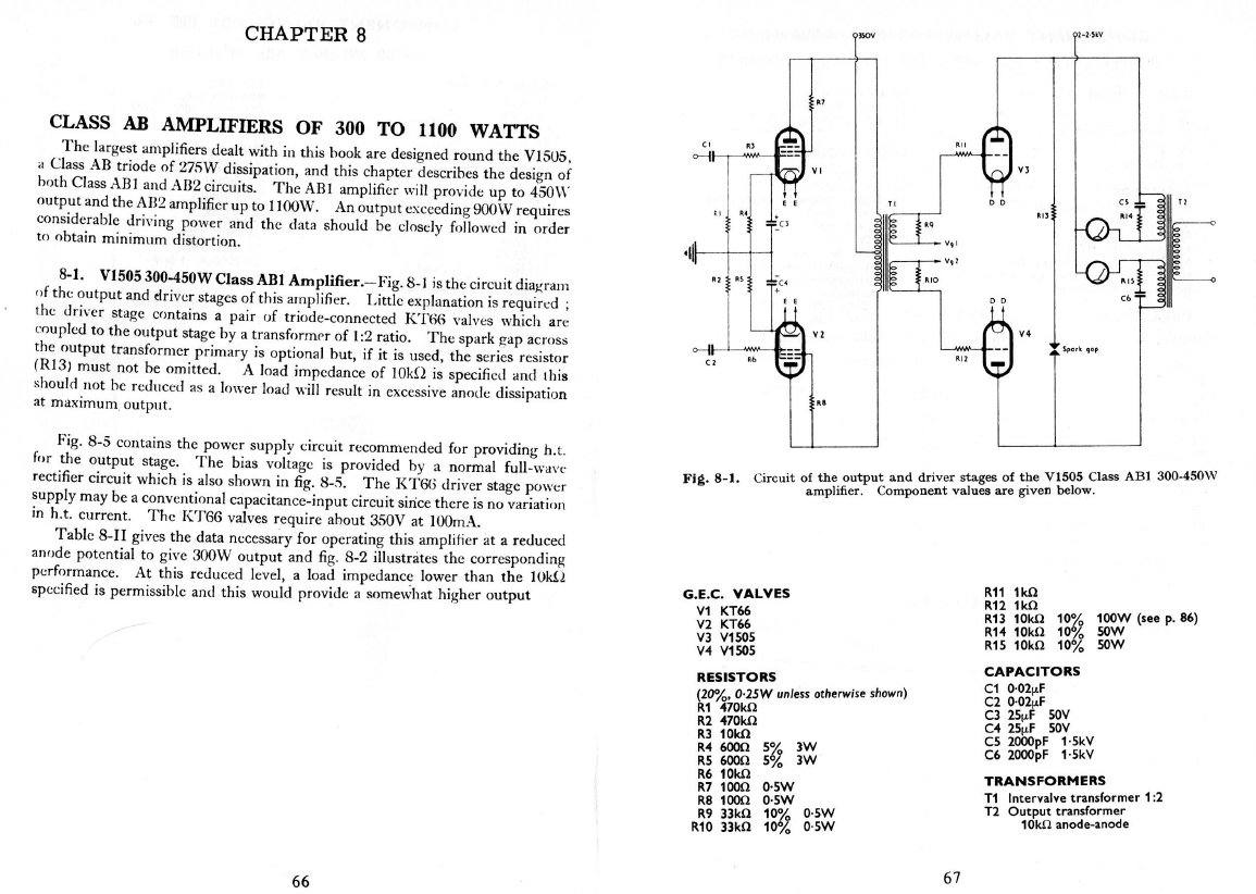

Spark gaps have been used extensively in the past to protect audio output transformers and transmitter modulation transformers.
I remember seeing a lot of tube sockets, tube bases and transformers ruined by arc burns, indeed sometimes a tube base could be saved with a saw cut through the burn. Many tubes with a saw cut go on and last for years.
I have seen many amplifiers with spark gap protection showing obvious signs of spark gap erosion with the rest of the circuit functioning normally.
The spark gap was placed across the transformer winding never from plate to ground as once lit it would continue to burn on the DC supply. When the spark gap fires its resistance will drop to low ohms or less so a load resistor must be placed in series with the spark gap. I remember a guitar amp that had a spark gap made on a tag strip; it seemed to do the job.
From memory I think the gap is about 1mm for 3kV.
Spark gaps have no parasitic load and very low capacitance.

I have enclosed a schematic from Babani #12 book on amplifiers.
