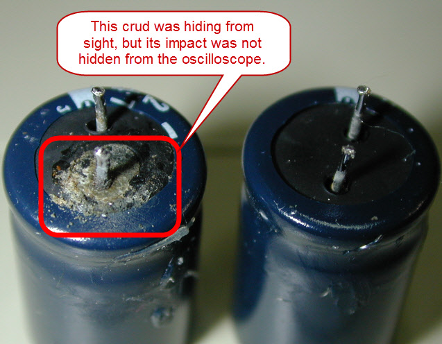

I have a small 6 watt custom amp head I bought years ago from an individual on craigslist, and have never had a problem with it until recently. I've had a couple times where it would turn on but not generate any sound, but I believe this was due to the power tube being not seated properly. I recently bought a set of replacement tubes, and today it was working fine when suddenly after a few minutes I heard a quiet pop and hiss then it went totally silent. The only tube I didn't replace yet is the rectifier tube. All tubes light up, the fuse looks find, and I've tried using another speaker cabinet. Any ideas where I should start?

First visually inspect all electrolytics, looking for bulging or leakage.
If you find anything replace those caps with equal sizes and maybe a higher voltage rating if you have room.
Many modern electrolytics are designed to safely "explode" (split at top):
Old leaky caps
Old leaky caps

After the caps are discharged, the cheapest ones can go bad in 6 years or less. I would just replace them all, freight is a minimum of $7 and the tools will be >$50. ESR checking meters that will check caps up to 10000 uf are $150, so I don't own one. Try to buy 3000 hour rated life or up caps. farnell.com has the cap life in the selector table, other vendors make you download the manufacturers datasheet and read it. Some vendors don't have links to the manufacturers datasheet, and some won't tell you the part number or vendor of the cap. Old stale e-caps are a waste of money, the air has been attacking the rubber seal since the day they were made.

In the shop at recording studio, we always replace all electrolytic caps on vintage gear as the first step to restoring their function and sound. Old caps go in garbage.
