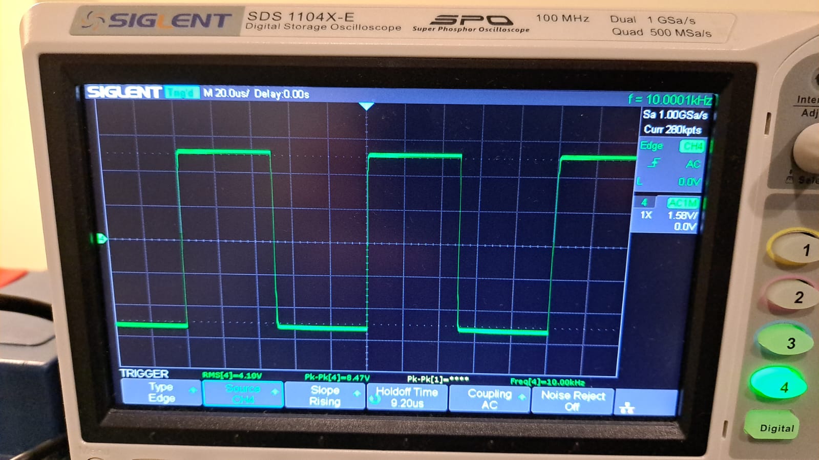

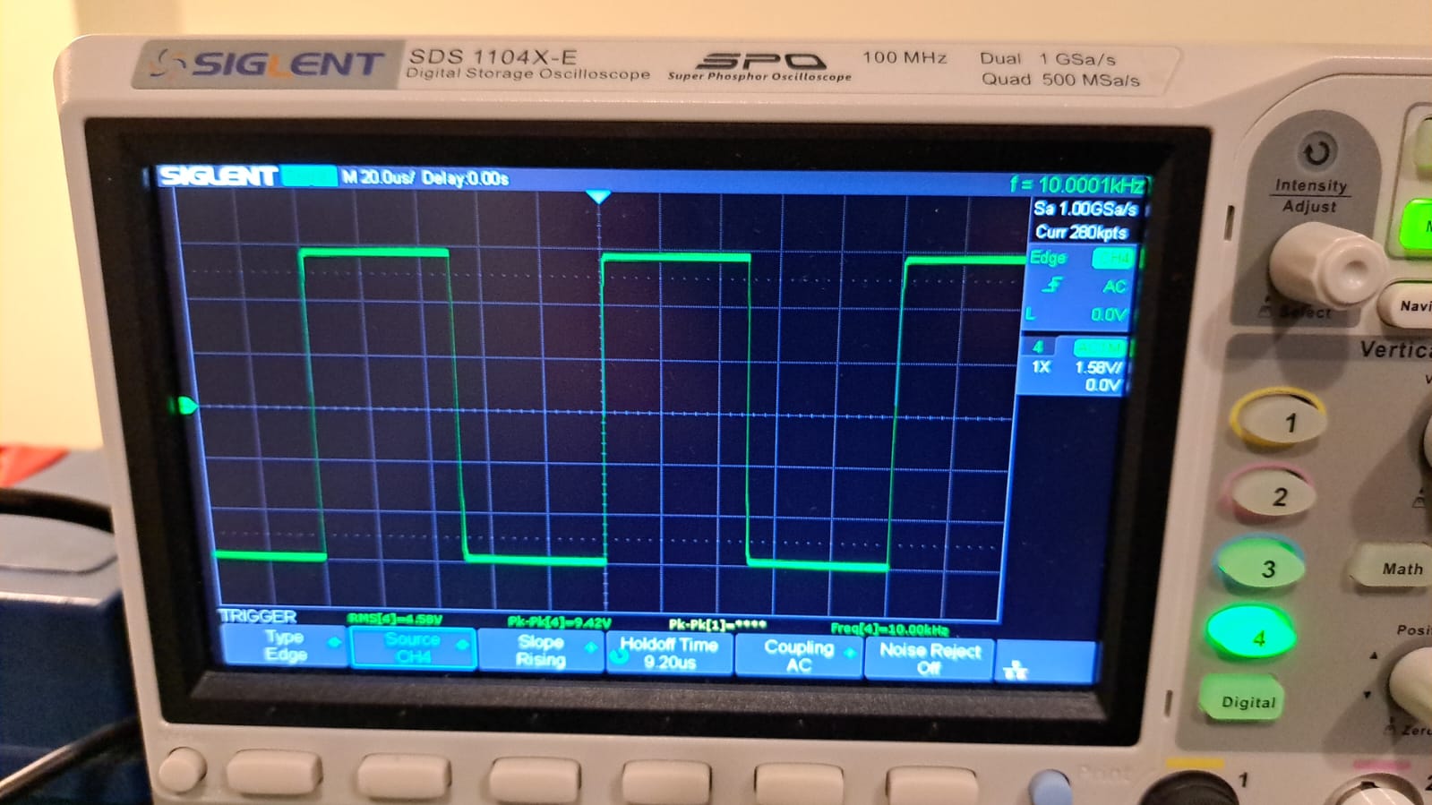

Tube amp noise
At 10Khz

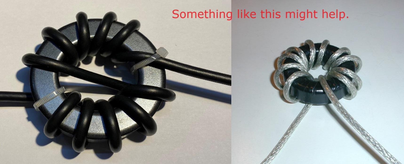

So the ISP router is injecting interference into the speaker wiring. You could try putting small inductors in the preamp output and the speaker wiring see photo:

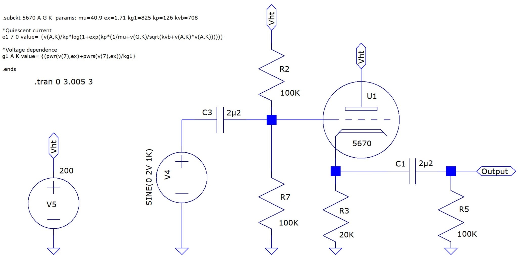

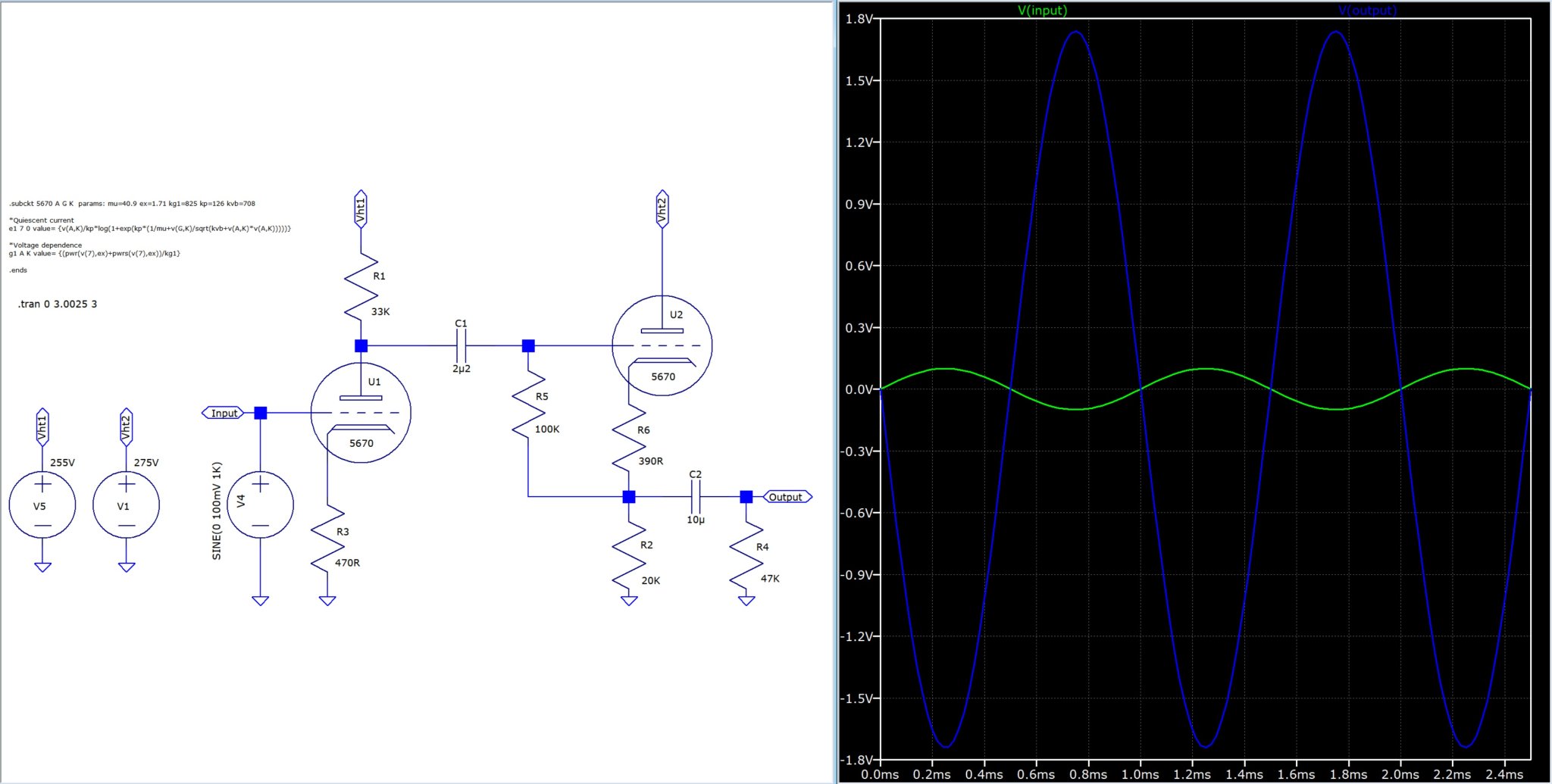

The value of C5 depends on the input impedance (resistance) of your amplifier. Making R16 47K establishes an output impedance for the preamp and holds the output end of C5 down to Ground at DC. If there was no R16 (or if it was 1000K (1Meg) as in your schematic, when you turn on there would be 160 Volts at the preamp output for a short time.
The 47K resistor ensures that C5 charges up quickly (to have 160 Volts on one side and 0V on the other side) faster than the valve U1 can warm up.
Getting back to C5 lets say you connect an amp with an input impedance of 10K Ohms to your preamp, the time constant (with R16 as 47K as well) would be 8246 *2.2 x 10e-6 which is 18milliSeconds, that would impact the low frequency response of your preamp, 20 Hz would be attenuated. So 2.2 uF is a bit small, it is OK if your amp input is high impedance but 4.7uF would be better and 10uF even better. Its not a big thing, you could leave it as it is, but make sure it can isolate the maximum possible B+ HT (not just 160 Volts).
Also R14 at 470K is a bit high, I would put a 100K resistor for R14. It will establish a good DC level across C3 faster.
As I said before its a nice looking preamp and nicely built. It is a nice circuit with low THD.
The first tube U4 introduces some THD (-50dB for small signals) the Cathode follower U1 introduces no THD.

That's impressive! With those arrangements I would leave C5 alone as 2.2uF and 630 VDC also I would leave R16 out altogether as long as your amp input will establish a stable DC level across C5.
Your preamp is a good design hard to improve on it. The only comment would be - if you increase R21 in the Cathode of U4 from 470R to 1K0 it will improve the THD and reduce gain by about half, worth doing if your system can work with the preamp gain reduced by half.
Valve circuitry is always very forgiving at switch on. The valves are all open circuit and gradually start to conduct as the heaters warm up. It gives time for decoupling capacitors to charge up.

The slow drift (58s) is probably the valve warming up settling your circuit at the moment has a somewhat undefined DC level where R11, R13, C5 and R14 join. That's part of the reason I was mentioning the follower circuit in post #37.
As the circuit is now, if you have no output connected and R16 really is 1 Meg Ohm and R22 is 2.2 uF just those two components will take most of 10 seconds to settle.
Then with R14 at 470K and C3 at 2.2uF those two components will take most of 5 seconds to settle. So the rest of the 58 seconds must be the valve warming up and maybe the power supply ramping up B+ HT.
Suggest you make R16 100K and R14 100K. Also consider trying the follower circuit in post #37. For that circuit you can leave B+ HT at 275 Volts or reduce to 200 Volts. With that circuit current through U1 Anode to Cathode is about 6mA so even at B+ of 275 Volts dissipation is less than 1 Watt. For that circuit the heater should be at half of B+
pscan, any suggestion on how to make a shield to overcome this interference?
thank you
According to my experience, the way this issue has been dealt in the past does work. To shield the components inside the chassis, I use a fully enclosed metal chassis with many screws closing the metal bottom lid. I attach potentiometers and connectors directly to the chassis, this way radio frequency cannot enter trough holes or open slots. Front and rear panels, when they are needed to conceal screws, are attached to the chassis with short spacers at the four corners. Interference also enters trough the exposed tubes. I use tube shields to cover standard tubes such as ECC83; or internally shielded tubes that have been designed as dual diode plus triode or pentode audio amplifier stage for radio receivers. They are nice tubes meant to amplify small audio signals, so they are linear, with little or no microphonics, and almost no mains hum leaking from the filament. And most of them are internally shielded, external shield is not needed. If exposed tubes aren't required, I've found very effective the kind of construction that was popular in the early 1960's: tubes mounted horizontally on a internal vertical support (or PCB) that runs from side to side of the chassis.
