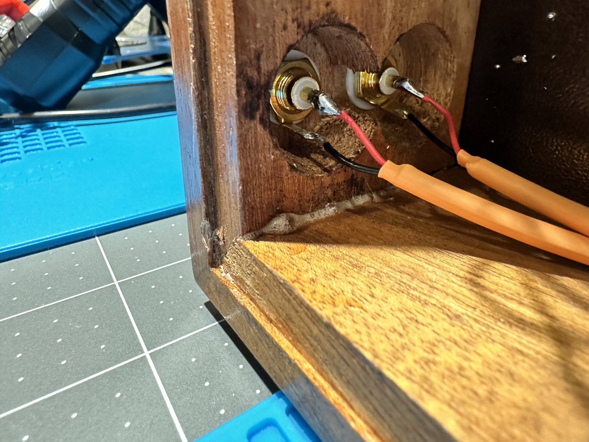

I would say the black wire is going in at one end and screen coming out the other. But its hard to tell. Bets are it's around the green blocks. China stuff can be very good I've used JLCPCB a few times and they are first class. I've also bought stuff from China and its cheap and does what it says.
The two green wires should be going to the same place on the main PCB. The picture is not the clearest. I would also expect to see a ground from the headphone connector to the main PCB too. Oddly I only see it go to one side of the headphone jack it should go to both and this is the diagram on the WEB. From memory all 3 contacts break so that would leave the headphones with no ground.
The heat-shrinked black is screen braided with negative RCA wire. Red that comes out of the same sleeve is RCA positive. 2 green wires ultimately lead to star ground on the PCB. Wiper red and black wires lead to the 2 grids at the tube socket.

This should be testable with an Ohmmeter. Ask yourself: what kind of wiring issue could cause this symptom? One where hots and grounds are reversed on both channels. Should be visible with an Ohmmeter from the outside of the box, including the location. If swapped before the volume control, continuity from one channel's hot to the other's ground will be independent of volume control position; if after, will vary with pot position; assuming common-grounding at the pot.

95% probability you have miswired signal cables/connectors so focus on that.
5% there is something wrong with the amplifier, and that´s only because it´s DIY, so suspect.
Waste of time. It's a phasing/connection problem. Voltages are irrelevant.

And of course…you all win and I am a dummy…
The problem was on the output side!
2 things, but only 1 big thing:
L and R wires were connected reversed to the output jack.
The headphones jack was faulty and didn’t make contact with the sleeve of the male jack.
I only had to play with jumper cables to figure this out, but I was so keen on the problem being on the input side or the circuit, I missed the obvious.
