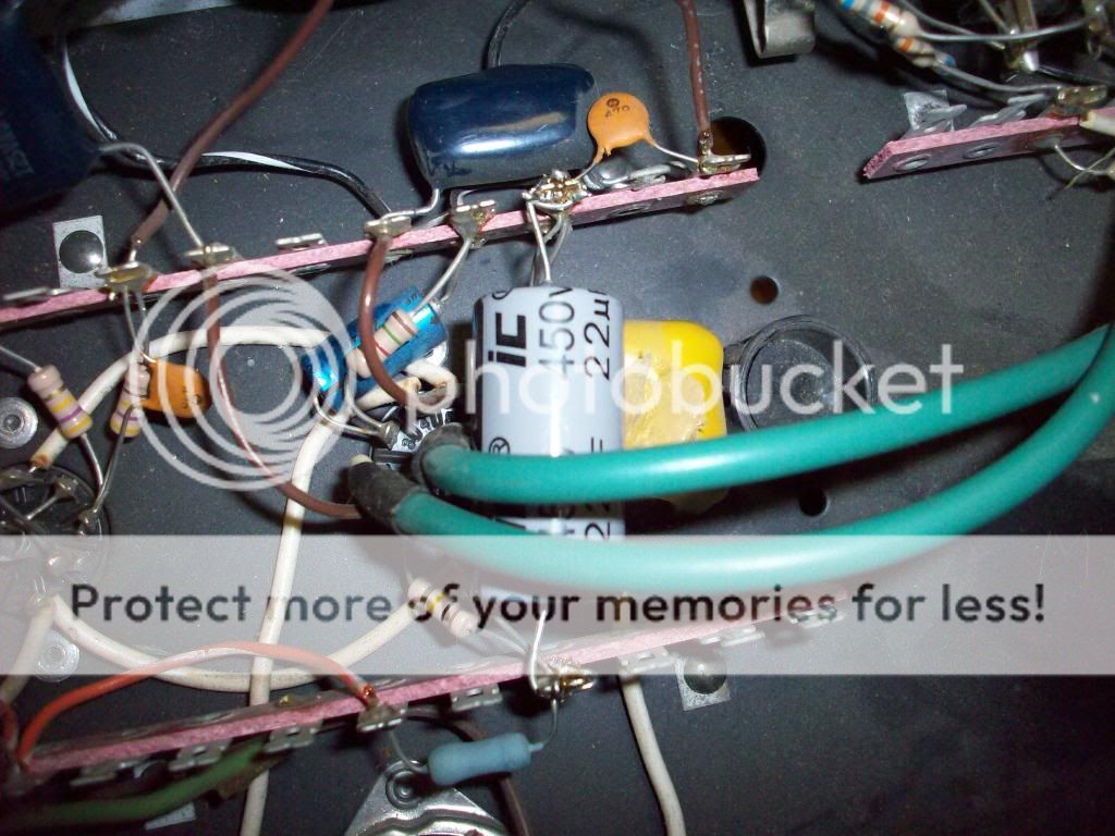

I just changed 4 coupling capacitors, tested the amp, and it worked fine. I then moved to the electrolytic caps. I replaced the 68uf @63v axial with the closest thing, a 56uf @63v radial cap. I replaced a 22uf @450, then I replaced one of the multi section filter caps. I had marked everything and soldered (very amaturely) everything just how it should have been. I had to reuse the 470 ohm resistor and the 8.2 ohm resistor, because I didn't have any to replace them with. Then I powered up the amp, all the tubes lit up fine, but when I hit the standby switch, no sound or buzz whatsoever comes out of the speaker. Here are some before and after pictures to give you an idea, and maybe help me out.

I hope it's nothing serious like a borked OT or something like that, and only something simple like bad resistors on the leads of that filter cap. Any help would be massively appreciated, I've been having trouble focusing on anything besides worrying about my amp for two days. I've even lost some sleep worrying. But mostly, I just really want some very loud music in the house.
I see you missed the advice to change one thing at a time, then ask for help if it doesn't work. We'll have to start at the very beginning. Do you have a 600 VDC meter, and a couple of clip leads? There should be a wire running from the line end of one of those black diodes to a 450 V cap. clip the leads on, turn meter to 600 VDC, then turn it on a minute, then back off. What was the voltage at that cap? The black lead (negative) should go to the frame somewhere.
I though you were going to buy individual caps. I see in after, a can still hooked up. You replaced a can with a new can?

The usual hookup is rectifier line to a cap section, then to the plates of the power transformers. Also through a resistor to another cap section, then to the plates of the grid driver tubes for the power tubes. Then though another resistor to another cap section, then to the plates of the input tubes. The voltages of the 4 sections should be something like 400,300, 250,225, depending on what actual tubes you have. You do have two big tubes (power tubes) don't you? What are they? You can look up the datasheet on triodeelectronics.com. The plate is the part that looks like a T. The plates of the two big ones may go to a transformer (OuputT) and the first high voltage cap may go to another winding of that transformer.

Okay, on the 68 cap at top, make sure the negative line goes to the left. On the 22 @ 450 the plus before looks like it is to the left. Make sure that + is down on the bottom. I think.
Oh, and to blow a transformer it would probably stink. With those cheap 1n4007 rectifier diodes, you might blow one of them, or maybe the end out of a cap if it is hooked up wrong. The diodes are about $.20. If One is blown you will have 500+ AC between the two non-line parts of the two diodes (use 2 clip leads) and no DC on the common lines parts. I think the lines of the diodes should be joined together in this amp, they do that inside the tube on a tube rectifier amp. If the only problem is that the inrush current of new caps is too much for the rectifiers (too loud, in other words) you can put a 100 ohm 4 W resistor on a terminal strip between the lines of the diodes and the first B+ cap.
