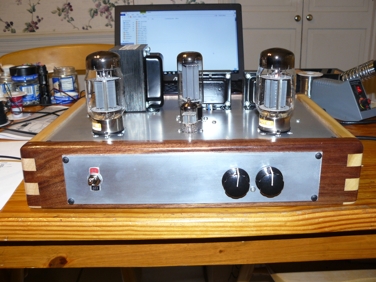

I recently finished Michael Abdullah's KT-88 amplifier and it sounds really good with my horn speakers. For cost, simple to build and great sound with efficient speakers it is hard to beat. Here is a guy that recently built this amplifier on youtube with a detailed build guide and parts he used. YouTube I started with part 10 showing the results he obtained. I have many tube amplifiers, SE 300B, SE45, tube lab SSE, plus 5 or 6 more along with 7 up and running Papa clones. There are a lot of similarities to FW amplifiers and tube amplifiers. Papa has talked about this a lot himself. Simple circuits with few parts. It all becomes whether you want a SS or tube amplifier on which one prefers. I like all of my amplifiers.
