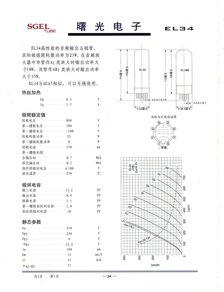

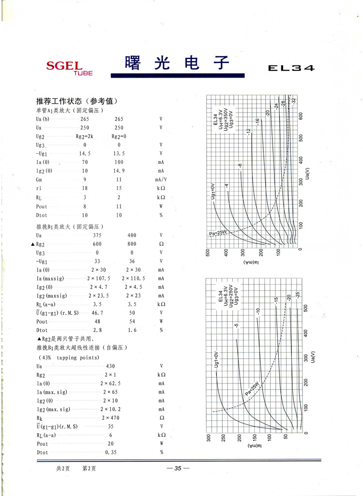

One more thing, do you have any advice or information as to which datasheet is associated with TAD EL34B-STR? I don't think the one on their website is usable.

In case of uncertainty, we usually choose to trust the most original information😀,Take the official data of Shuguang Electronic Tube Factory as the standard.please Look at this🙂
