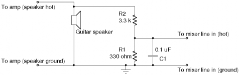

I figure I will not waste my breath arguing with the drummer and install some resistors to pad down the output in order to send it to the mix board. I personally think this will sound horrible at the mix board and I feel it will effect the tone through the speaker by loading the amp differently now. Won't the resistors flatten out the response characteristic of the speaker? If I use large enough resistors where it isn't affecting the loading then I don't know if it will drive the mixer. I figure the mixer input impedance is <10k. Most I have seen are 1k-3k. I honestly care less about the mixer sound but I still want the sound through the speaker to be the same.
My amp is a custom built 12 watt push pull 6v6 tube amp. I was thinking of a resistive divider of 100 and 10 ohms, that should bring the 10v signal down to 1v or less. I was looking through my resistor drawer and I don't have anything less than 100 ohms so I don't want to order a 10 ohm resistor and pay for shipping or drive a half hour away to RadioShack if this is all for nothing and a waste of time. So if anyone has any experience doing this please share your results, it will be greatly appreciated. I am sure other tube amp users will find this information useful.

If you want to make a line out on your speaker leads, it ought to take more than 10 ohms.
Instead of 100/10, how about 10k over 1k, or even higher. Certainly 11k parallel your speaker will not affect the speaker tone in any way.
By its nature, this sort of circuit is unbalanced, so it will be a high Z output. If you want to feed it down a snake, then add a transformer after this.
Many amps have made a line out by divider across the speaker.

If you want to make a line out on your speaker leads, it ought to take more than 10 ohms, but still keep the 100 ohm on the "top" resistor. Total resistance 110R.
I have the 100 ohm resistors but not the 10 ohm ones which is why I said I might have enough to parallel down to 10 ohms. The "top" resistor is still 100R, total resistance is 110R.
The issue I was pointing out with using a larger resistance to not load down the amp is a high source resistance to the mixer, too low a resistance and it loads the amp and changes it's characteristic tone.

Consider that power = V^2/R and therefore if your amp is 12W into 8 ohms,
then it will provide 12 * 8/110 = .87W into the series resistors you plan to
use. The 100 ohm should be 1W rating if you are going to crank the amp.
Nothing wrong with using a 110 ohm load, should work fine. The 10 ohm
shunt provides a low output impedance, good for driving long cables.

Danger, Will Robinson! I wouldn't put a cap directly across the amp output (speaker), I think that may harm the amp. Sometimes amplifiers will become unstable and burst into oscillation if the output is loaded with a capacitor.
What will work, is to put a two-resistor voltage divider (R1,R2) across the guitar speaker. The two resistors are chosen to divide the voltage down, so you get a reasonable line level across one of them (R1). Then put a capacitor (C1) across that resistor, to create a low-pass filter. The amp itself won't "see" the capacitor, because the other resistor (R2) is in between the amp's output, and the capacitor.
The attached schematic shows the plan. The 330 ohm resistor (R1), along with the 0.1 uF capacitor, forms a low-pass filter with a -3 dB corner at about 5 KHz. The 3.3k resistor (R2), along with the 330 ohm one, divides down the speaker voltage, to generate a line-level signal across the 330 ohm resistor.
I'm guessing a little as to the value of the 3.3k resistor - its value depends on how much signal the mixer wants at it's line-level input, and how loud you like to play through your guitar amp. But if 3.3k turns out to be the wrong value, you can easily change this to suit you, or replace it with a 5k trimpot in series with a 1k resistor, so you can adjust to suit.
If you need to change the 3.3 k resistor, here's how to do it: play through the amp at your intended practice volume, with the line-out signal (across the 330 ohm resistor) running to a line-level input on the mixer. If the mixer gain needs to be turned way up to get adequate signal, then *reduce* the 3.3k resistor in the attenuator, so you get a hotter signal to the mixer. I would try halving it, say 1.5k, which will give you roughly 6 dB more signal.
Obviously, do the opposite if the signal to the mixer is too "hot" - in that case, *increase* the 3.3k resistor. I would try 6.8k, which will halve the signal (-6 dB) to the mixer.
I hope this works for you - I've had good results with the two resistors followed by a Danelectro Fish-n-Chips graphic EQ pedal, but I've never tried the single first-order low-pass filter at 5 KHz.
Oh yeah - half watt resistors will be just fine, unless you plan on using a 100 watt guitar amp. :eek:
The capacitor (C1) only sees a line-level signal, so use any inexpensive non-polarized one you have lying around in the junk box. Polyester, Mylar, film, ceramic, whatever. As long as it's rated for at least 10 volts, you have a nice big safety margin.
One last thing, just to make sure: the guitar speaker must remain connected to the guitar amp the whole time. It provides the 8 ohm load that the amp must have at all times. Tube amps can get seriously unhappy if the load is removed from their output. You probably know this, so I apologize if I'm telling you something you already know. I just wanted your amp to stay safe and healthy.
This is a simple circuit which only provides an unbalanced signal to the mixer. To avoid hum, make sure the guitar amp and mixer are plugged into the same mains circuit (adjacent wall outlets, or adjacent outlets on the same power strip).
