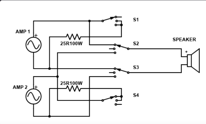

Attached is a schematic of amplifier selector with dummy load for safely switching tube or solid state amplifiers. The selector is a Grayhill 44A45-02-03S three position shorting style rotary switch, one per channel. Center position is for "speaker off" to prevent both amplifier outputs shorted together.
The reason of using shorting style (make-before-break) rotary switch is to ensure both amplifiers will be connected to a load at all times, either to the speaker or a dummy load.

Relay with make-before-break contacts is hard to find, I utilize a make-before-break rotary switch to control relays for speaker and dummy load.

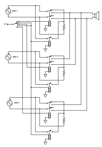

Relay controlled A-B-C amplifier selector:
It utilize a SP5T make-before-break rotary switch to control relays for speaker and dummy load connections. In order to ensure load (speaker or resistor) is always connected to the amplifiers, the circuit need an extra switching position in between A-B and B-C.

The output should be connected to the resistor before the speaker is disconnected , a moment
with both speaker and resistor as load does not harm a tube amp, but a moment with no load could.
The trick is the make-before-break rotary switch, when the switch move from "A" position to next position, the spst relay will engage the dummy load resistor to "amp 1" before the dpdt relay break the connection of the speaker.This is'nt good enough !
When the switch move from that position to "B" position, the dpdt relay will engage to the speaker before the dummy load resistor disconnect from "amp 2".

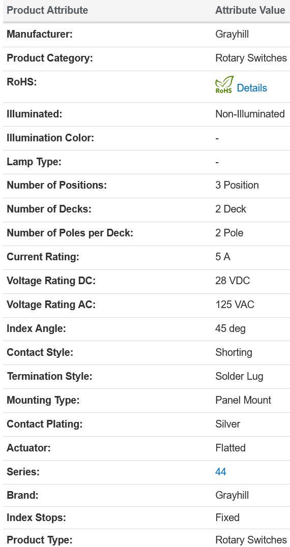

The Grayhill 44A45-02-03S three position shorting style rotary switch current rating is 5A.The 1 Inch diameter series is rated for 1 Amp. That is all!
1 Amp rms and an 8 Ohm resistive load is 8 Watts.
Low power amplifiers should be OK.
High power amplifiers and 4, 6, 8, 16 Ohm speakers may be a problem.
Your Mileage May Vary

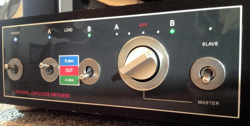

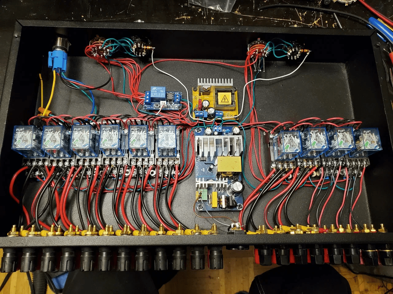

My friend wants a switcher can safely switching tube or solid-state amplifiers to one pair of speaker, so I built two identical speaker level amplifier switchers and one line level switcher for him.
I put a master/slave switch on the amplifier switchers and use DB9 cable connect them together, so he can easily use that for mono blocks or bi-wire/bi-amp system. If both amplifier switcher set to "slave", the line level switcher will becomes the "master" switcher and switch the source/preamp to the amplifier input.
The line level switcher will mute the input signal while switching for additional safety, it also shorted the input of the amplifier that is connect to the dummy load, so the dummy load can use a lower wattage (5Watt) resistor.

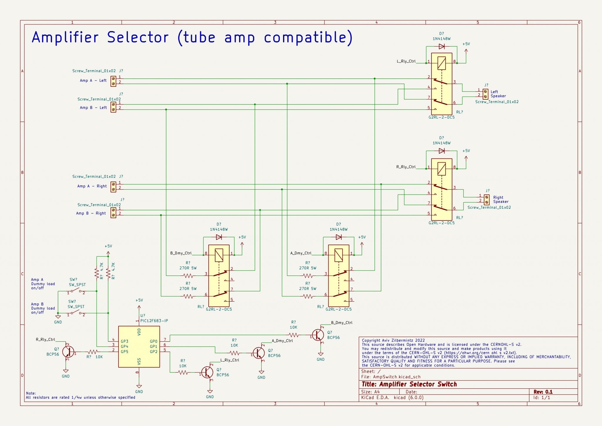

After some thought, I tend to go for the uC controlled relays based design, as it gives much flexibility when it comes to switching sequencing. I made a first design draft, would appreciate your feedback. One comment regarding this design- as for now I'm considering A/B only, I chose switching the speaker terminals using DPTD relays in order to save two relays. There are some drawbacks to this design, but it can easily be changed to pure single pole per amp contact per channel in case more than two amps have to be supported. The control logic should work more or less like this:
Current stare: Active amp is connected to speaker out, its dummy load is disconnected. Non-active amp is either connected to it's dummy load or open (depending on the switch position).
Transition: connect dummy load to the current active amp (unless its dummy load switch is set to off) -> switch the main relays -> disconenct the dummy load from new active amp (in case it was connected).
