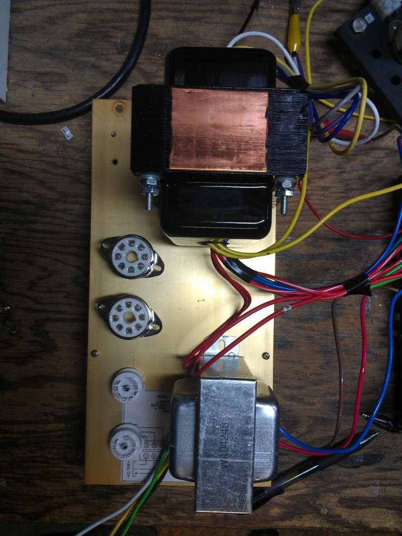

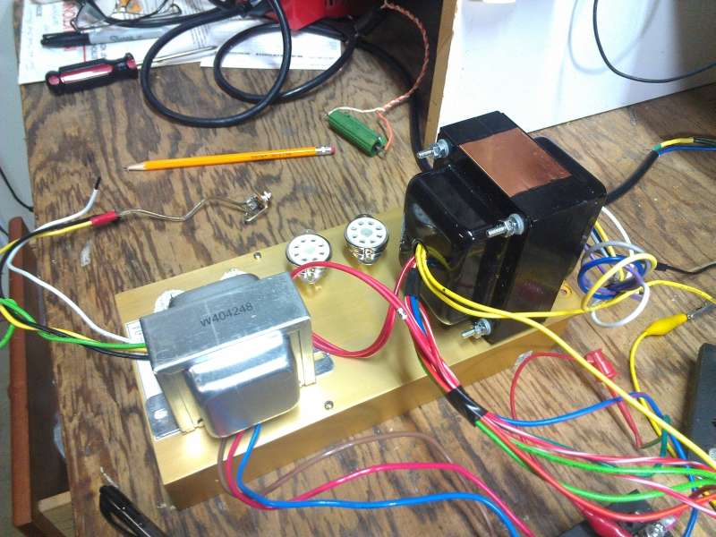

Tube amp chassis layout proposal
The amp will be a Bassman AA864 (with an AB165 preamp). Have it working fine on a breadboard, and want to stuff it on this 5-1/2" x 11" chassis. Eyelet board is 11" x 2", will run the entire length underneath. Xfmr cores are positioned perpendicular. Pots in front, AC, fuse, spkr jack & bias pot in back. Anyone see any major problems with this layout? Wire lacing will be tight (and critical to avoid hum). Thanks!

Looks like it's going to be pretty tight. You might have some interactions between the output transformer and the preamp section as the output transformer will likely be sitting over top of your gain stage components. I usually like to keep anything away from the gain stages. I don't know how well shielded your output tranny is, all that power from the tranny might "bleed" into your gain stages then amplified, might result in feedback. You can try it where it is and if there is no issues, great. If not, you can always relocate it.
Cheers
Apply power to your power transformer with a load.
connect voltmeter to output primary and see if you can move the output transformer to ward your power transformer without picking up hum. You could also use headphones connected if you don't have a sensitive volt meter.
I've been trying to use a small chassis, and am having trouble figuring out where to put the potentiometers.. All the real estate near the tubes is full of resistors and caps.. The area in the back near the transformers is all open, but I don't want to run my signal directly under the power supply components. I'm about to give up and go to a bigger chassis..
So, make sure all your controls will fit.
Great comments thanks! Wicked1: I had to relocate my vol pot on a Princeton clone to reduce hum, moved it so that shielded runs in and out of the preamp were the shortest.... Mike567: I will test OT and PT orientation under load - as they were (and are) wired to my breadboard when I took the pic. Poacher: Shouldn't the chassis shield the eyelet board from xfmr RF?
Not necessarily. Even if did, the output tranny is still right beside the preamp tubes. Just good practice to keep unwanted signals away from the preamp tubes. You will notice this as a common practice among commercial manufacturers. But, since this is DIY, you can try it where it is. Maybe you won't have issues. Reading from your last post, it might already be soldered in. You can always move it away, like mounting it to the speaker frame or in the cab somewhere.

Building a tube amp into the smallest chassis possible is usually a mistake - just look at all the early/mid mesa stuff: too small + poor layout + bad design decisions = a good oscillator.
It is easy to make the amp dead quiet and have great note articulation, just by following correct wiring methods. TUT3 shows how and there is a chapter about the Bassman showing both a tube-recto version and a conventional form.
For pedal compatibility, better to stick with the stock fender input stage. if it overloads, pad the input like they did - that's what the second jack is for - or use a low-mu tube. You would not "maximise gain to improve headroom", rather, you would do the opposite.
Note also that Fender's layout used a rather large eyelet board that occupies nearly the entire chassis interior. This is not necessary considering the simplicity of the circuit. However, some spaciousness in the layout is good inasmuch as parasitic capacitance is reduced. A more careful layout allows proper placement of the filter caps for each circuit allowing proper grounding to be implemented. Random grounding ala Fender is joke and contributes to their noisiness.
The bias pot should not be on the rear panel. Rather, there should be a separate bias control for each tube mounted on the tube plane of the chassis beside each tube. The rear panel should have meter jacks allowing safe ground-referenced monitoring of each tube's idle current using current-sense resistors. TUT3 shows all of this, as well. This position for the bias pots makes it as accessible and as protected as the tubes are.

Am I missing something here or what? I am looking at the schemo of both AA864 and AB165 and they both will need four 9-pin sockets. You only have two on the proposed chassis. Even if you eliminate the bass input there will still need to be three. To have only two 9-pin sockets you will have to eliminate the bass input plus the stage just before the PI.:scratch:
You are right about that; with only 2 stages for the phase splitter and 2 for the preamp perhaps he figures he doesn't need to mix the two channels (having just one) but it's not going to have much gain or drive the splitter very hard. Maybe if he uses a 12ax7 for the splitter instead of 12AT7.
