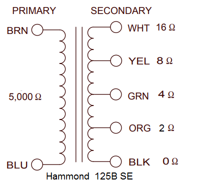

The Hammond could do.It is 5000 Ohm but that's accepable for a EL84.

Thanks for the tip, do you think that one wich seems to be closer would work?

If you use it with an 8Ω speaker the tube get loaded with 14k, worse than the 5k from Hammond.

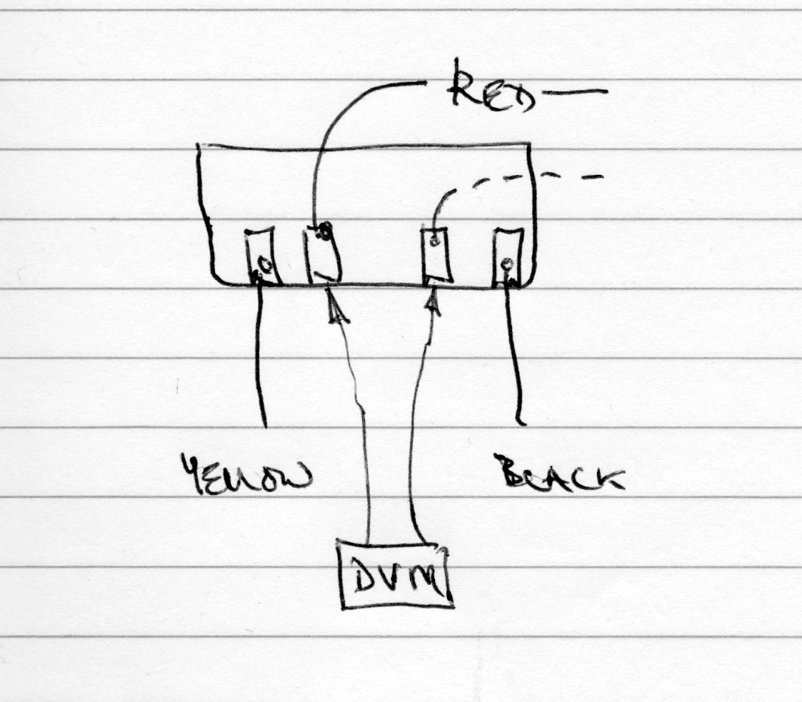

Hi Prologue,
I believe you have missed a set of measurements.
The out side pair (yellow and black) I guess are the secondary as they measure less than an ohm. There is no internal short from your results.
But you need to check the resistance of the middle pair. There have to be 4 wires for the transformer to work. The red one and one which we cannot see on the pictures. I guess you need to measure the red to the 'free' tag. (2k range as before.) Alan
