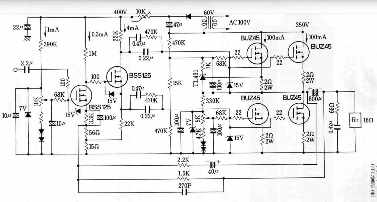

One possible tube amp alternative , Yamazaki SS amp which design tightly follow and is tightly based on the original J.Futterman H-3 OTL tube amp.
, here`s schematic partially corrected by me , but I think that schematic also hide couple of minor mistakes to .

I believe that was no big if any audible difference between many SS amps and that Futterman OTL tube amp on that test , anyway IMHO ...
This Yamazaki SS amp is very very different from tons of ordinary designed AB class SS amp ,
-SEPP orTotem Pole OPS work with very high unipolar voltage +350V
-OPS constantly dissipate around 70W , which make him pretty much A class biased amp ,
- front end work with +400V and is AC coupled to OPS
- two negative GNFB loops is by definition CFA for input (Singleton) BSS125 but in the same time represents strong positive bootstrap loop for second split load P.I. BSS125 , and that was always standard J.Futterman OTL architecture which Julius never changed ,
- both Yamazaki and Futterman likes higher 16 ohm loadspeaker impedance
,on the end I can say that except this Yamazaki amp another SS amp which follows similar but not the same Futterman architecture is JLH1969 A-class amp.
