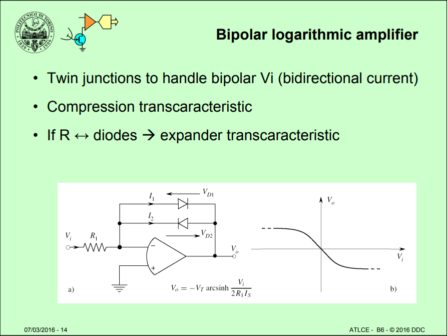

Depends on the circuit. Here's a classic op-amp guitar overdrive element;Which op amp is closest?
For small signals, the trans-characteristic is linear, but then starts to bend as signal level going into it is increased. Put in a wide dynamic range signal, it's going to get clipped. Something like what happens when a tube amp is overdriven; good enough to put in a box with a 9V battery, other support circuitry and sell it.
I dont know what happens when you play recorded music through something like this. I'm sure it would need to be dialed in so that its effect isnt dominating the whole sound, as it is in a guitar stomp box. If that's done successfully, does it end up "warm"?
You can use low voltage Zeners in series with the diodes shown, to get even less of an abrupt change from the linear portion of the transfer function to the curved part.
One would think someone's DSP would allow you to load in any arbitrary transfer function curve file, linear with a slight bend beginning at some amplitude. But no one would want to do that, so I guess there's no market for such an idea.
