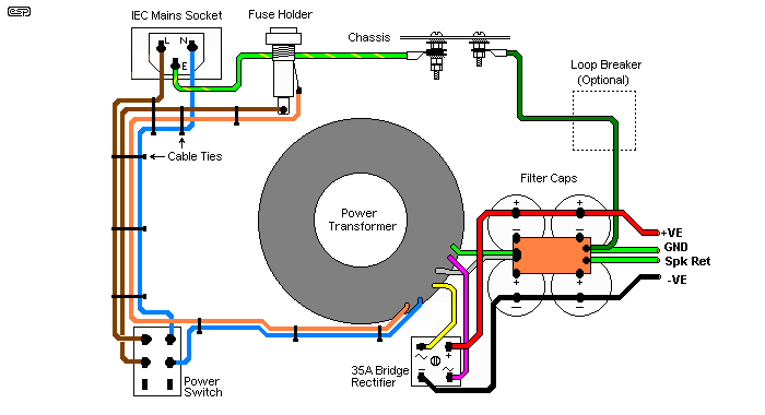

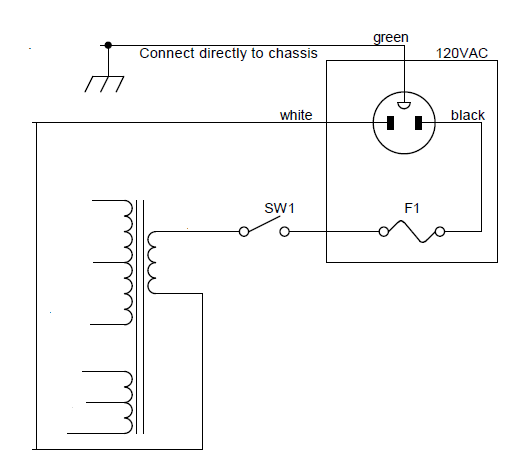

Unless you switch both of the AC lines, that will happen. Or locate the switch on the rear panel.
The switch contacts should be in the "hot" line (black AC wire for USA), if only one switch is used.

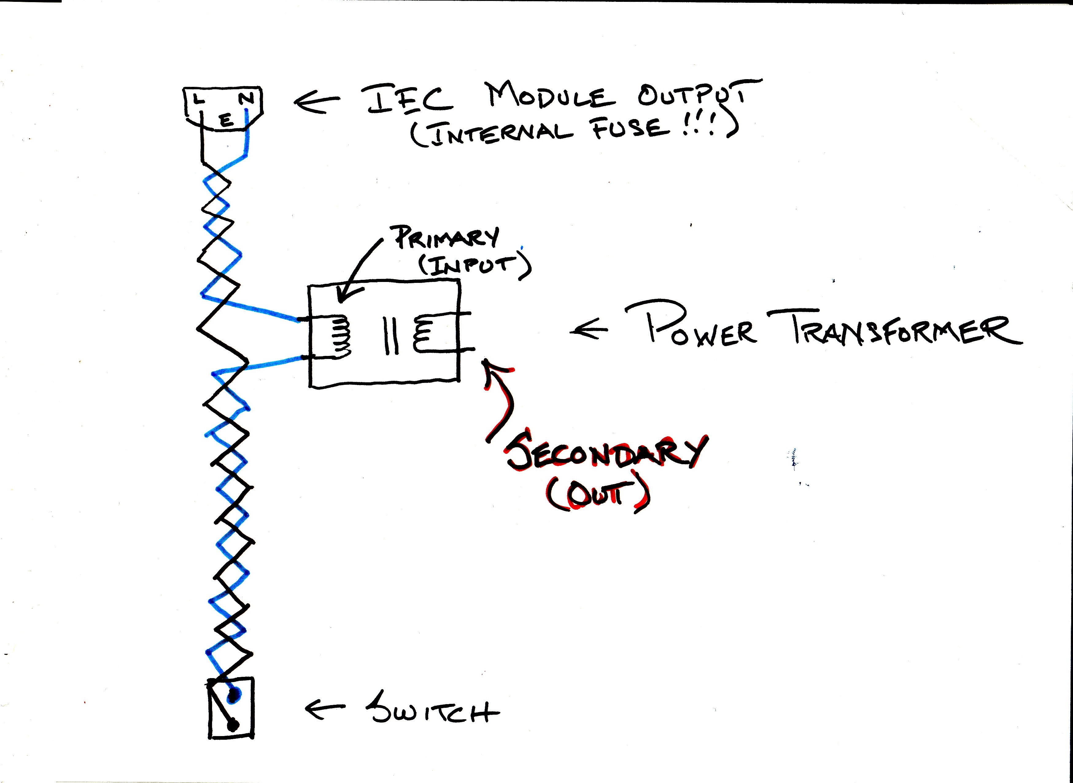

I’m not sure I understand. Does this mean I can just run a twisted pair from the IEC connector to the single pole switch and then solder a twisted pair from the power transformer to the same locations on the switch? That seems to make sense to me.
No, that wouldn't work. The switch is meant to interrupt or connect a single leg of the AC mains power.
My post was meant as an easy way of imagining it if you want to think mainly in terms of a twisted pair.
I usually make my layout such that if IEC is on the left rear, and switch is in the left front, I would place the the power transformer somewhere close to a line between the two, twist up enough wire to run from the IEC module output , passing it close to the connections to the power transformer primary and then on to the switch.
Cutting the (blue wire) so as to be able to use the freshly cut ends to connect to the transformer. (Either directly or to a solder tag strip to which the transformer primary is also connected.) There are many ways to do it to be in accord with the rest of your layout.
Note that I left out the safety ground just to keep the sketch simple. The focus is the twisted pair ONLY.
Also the drawing is only for an IEC module with integrated fuse holder. If separate the fuse would appear in series with the Line output of the module.
I hope this is some help.

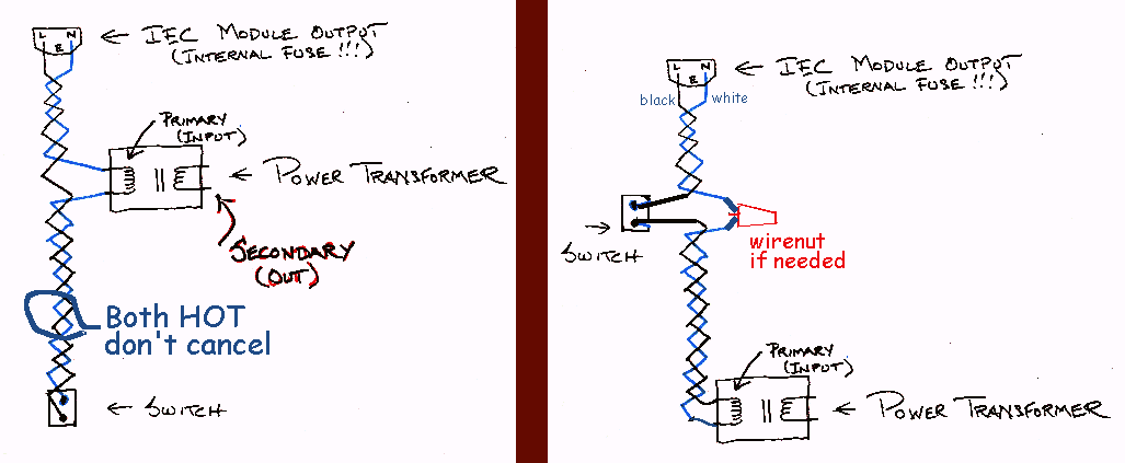

Nice drawing but... aren't both switch wires HOT? So even twisted, the electrostatic field won't cancel?
I think what is wanted is more like this (right side).

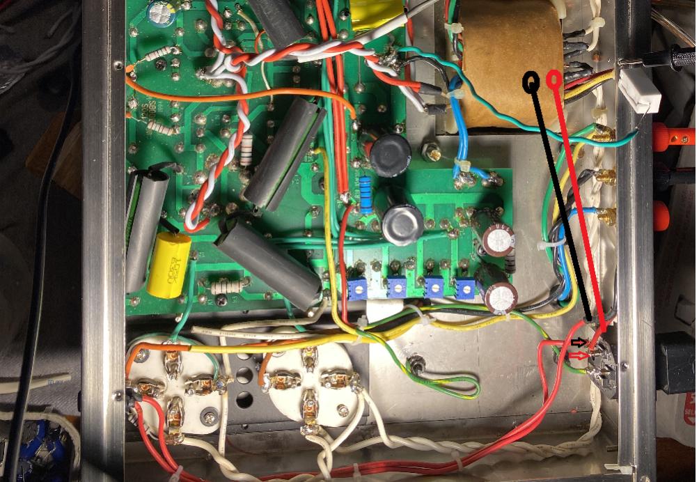

Thanks to everyone who provided input. I sat down and wired the amp last night. It ended up like PRR’s drawing that he provided. I connected the hot wire to the switch. It works as it should and tests okay and almost all the wiring is a twisted pair. Thanks again, everyone!
