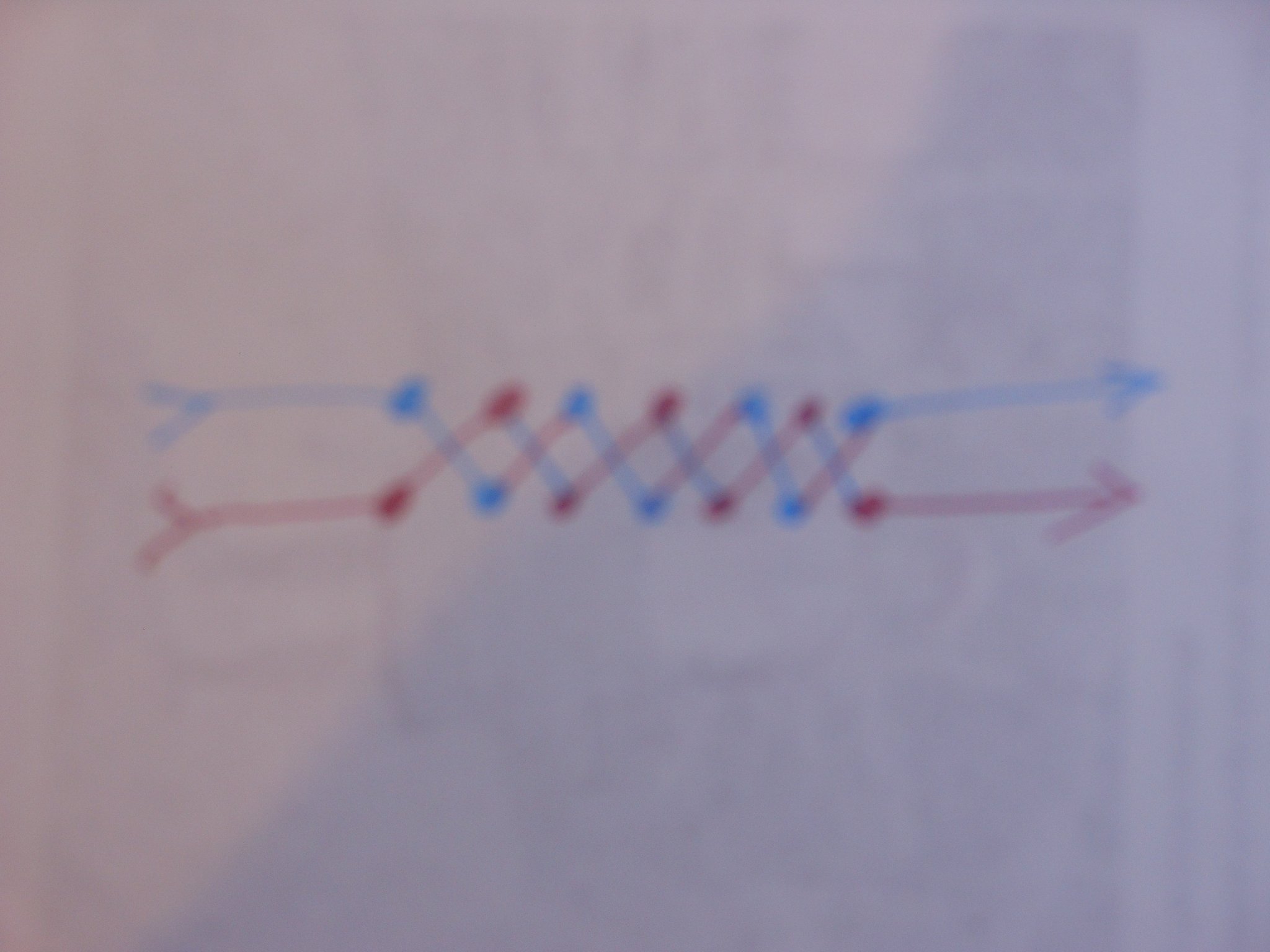

You could do a "twisted pair" on your pcb. Sorry for the pic. quality. E

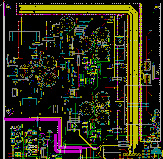

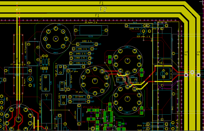

This is the ABA style layout I use for the AC heater traces on the four-layer board in my valve DAC.The idea is that the magnetic field of the left loop compensates that from the right loop. Unfortunately I didn't manage to keep it in ABA style close to the valves, where it actually matters most, but then again, twisted wiring also isn't twisted right at the valve holders.
My DAC doesn't hum, but then again, it's not that sensitive to hum fields anyway compared to a phono preamplifier.
