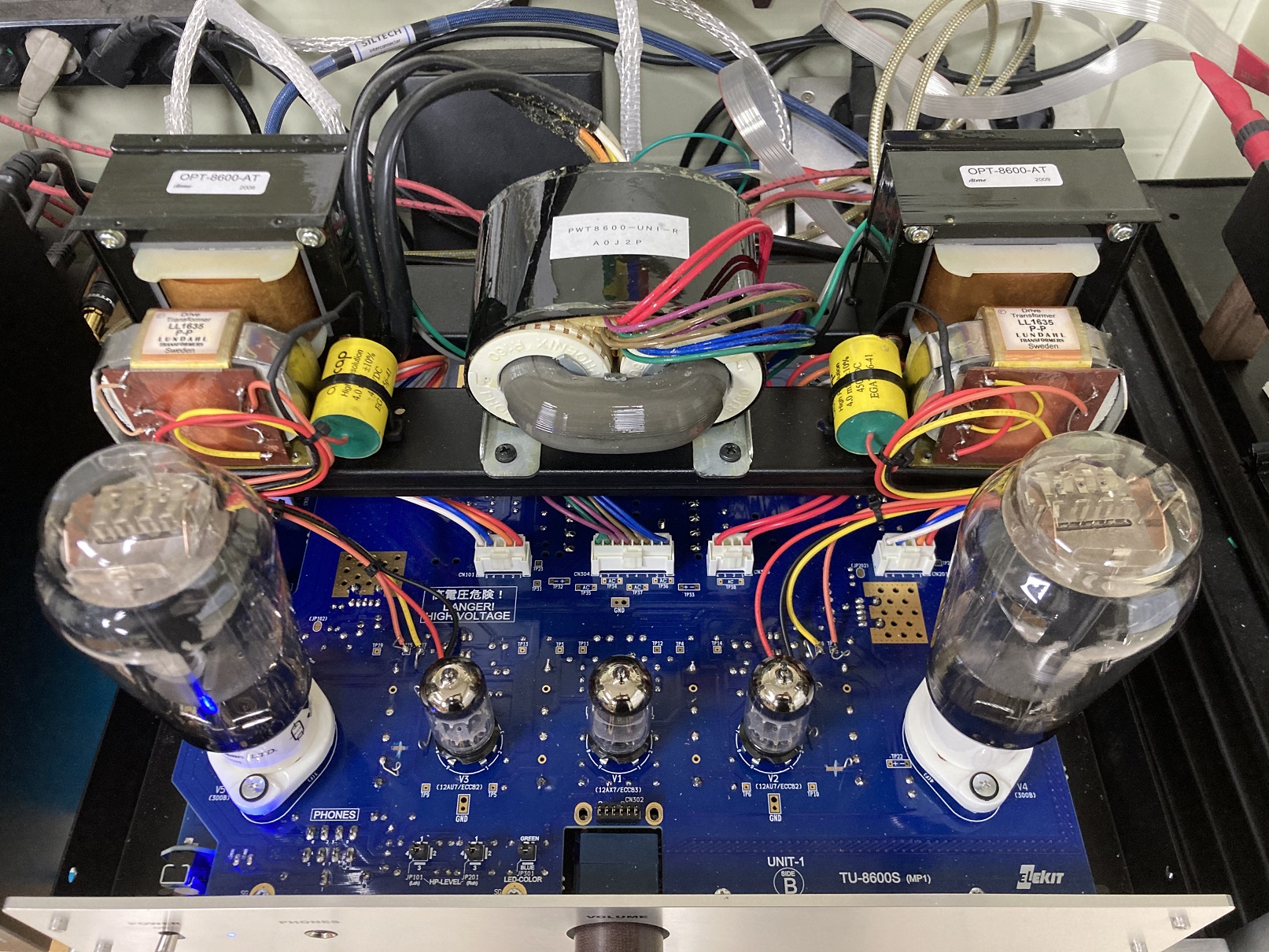

I am another fan of TU8600S and I toyed with this wonderful amp and I thought what I did may be of interest to some.

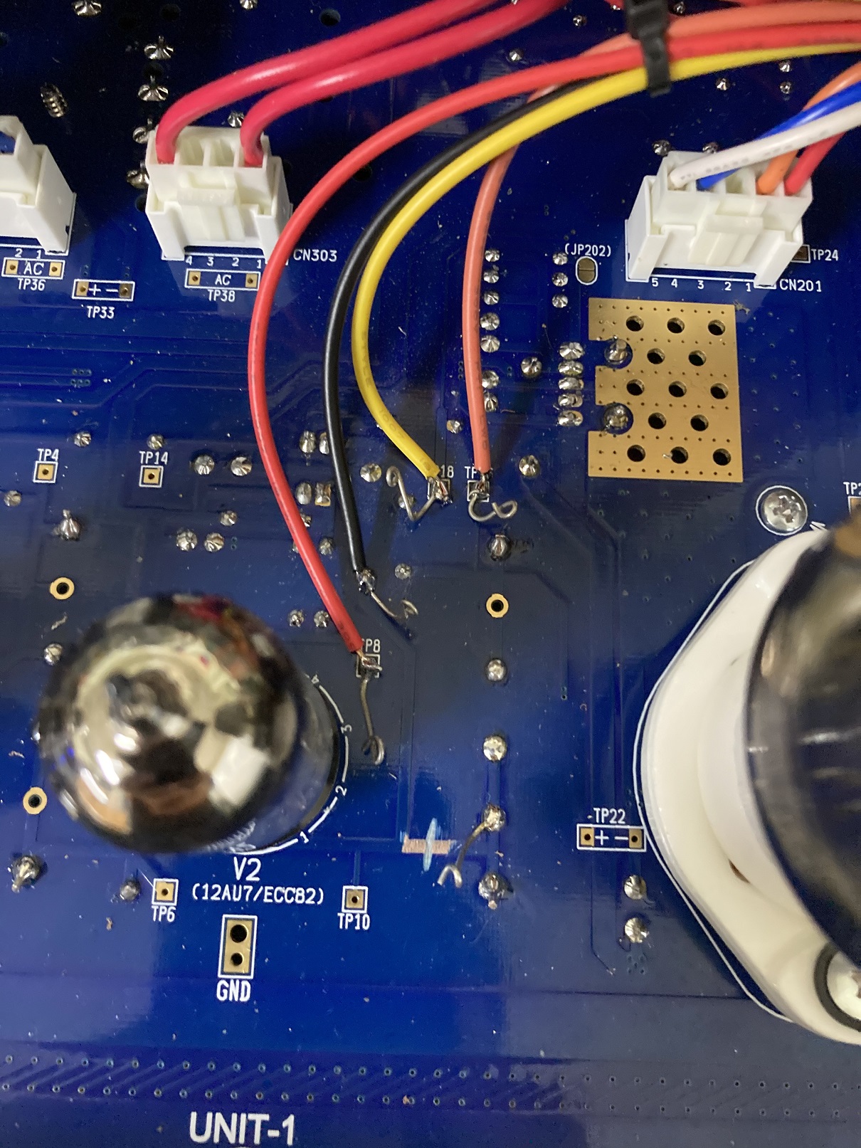

In short, I put the para-feed interstage before 300B without changing any given circuit except not using the C104 and C204.
A Fantastic fact about TU8600S is that it has these TP points that make my experiment really easy.
What I did ;
- remove C104 C204 or just cut the PCB path (in the picture)

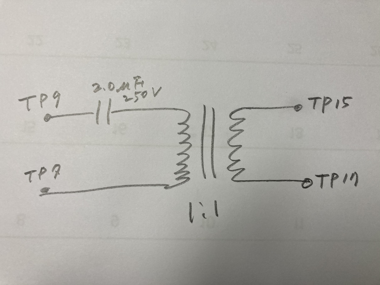

- Use four TPs to connect the 'cap + para feed interstage transformer' (in the hand-drawn circuit..)

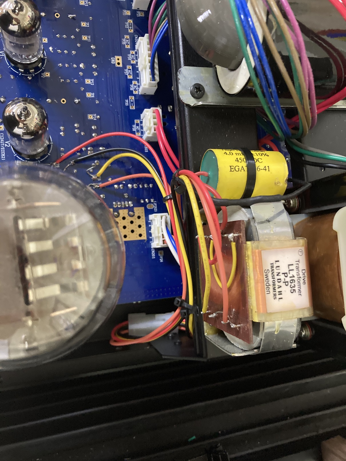

- I used Ludahl LL1635PP. You can use whatever 1:1 interstage. I used PP version because it has no air gap which is an advantage.
- give it some time and listen to it.
- If you don't like it you can put it back to the stock state 100%.

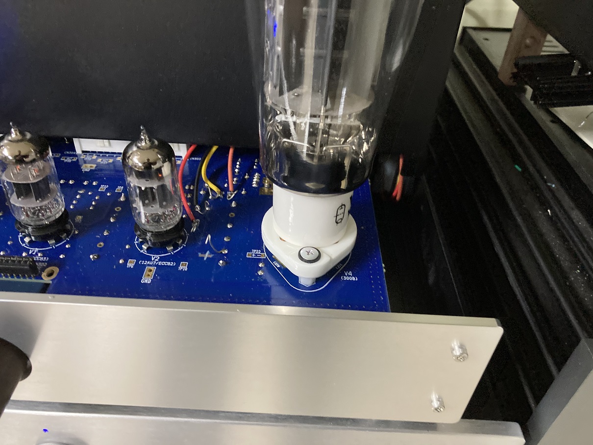

- If you like it move the OPTs(stock version) to the backside a little and fix the LL1635
- I used in-line connectors to compare with the original sound later. 🙂
- beware of the phase of primary and secondary, wrong connection causes oscillation interacting with cathode feedback winding of output transformer.
I was pleased to know that this mod does not change any nice appearance of TU8600S.
About the sound, well I like it but who knows about the taste of who except oneself. As a DIYer, I was once shocked by TU8600S performance and tried to improve my 2A3 SET for some different charm that can be used occasionally with TU8600S.
I can say that my TU8600S has that nice tone of 2A3 now and I am listening to more music. 🙂
