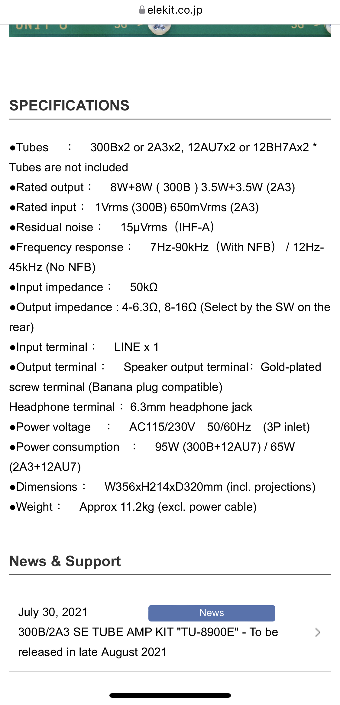

I have attached .pdf Spec Sheet for TU-8900 from hificollective.co.uk Elekit TU-8900E & TU-8900VK 300B / 2A3 Single Ended Tube Amplifier kit | HIFICollective
Even the TU-8600 spec sheet is THD 10%...So if someone has a scope then post what your unit is outputting....As Victor said..."Only your ears can tell you"
