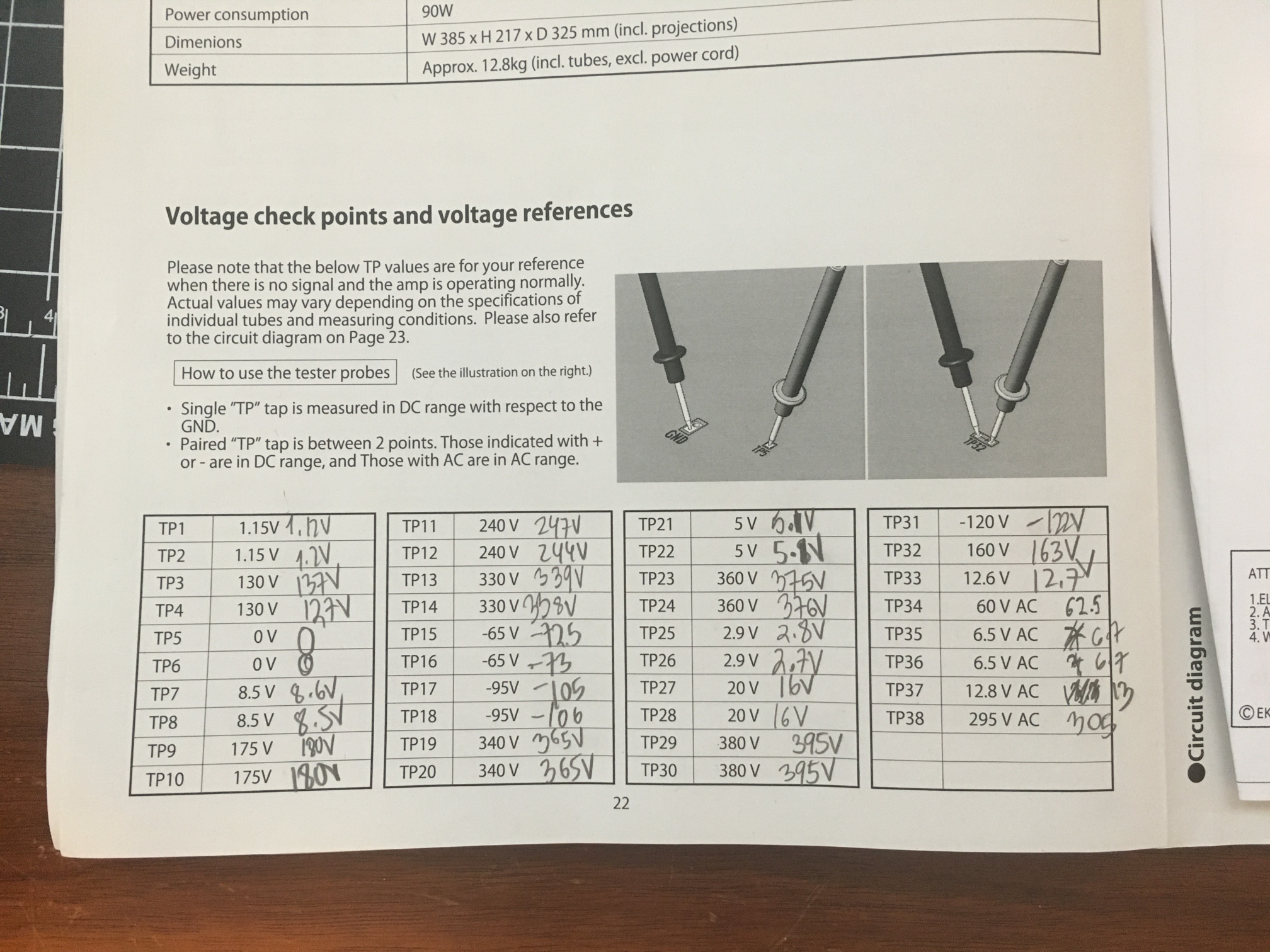

Just completed the TU-8600 and measured the voltages.
They are ~close~ for the most part, but have some variations across the board.
Some points that stand out are TP15-TP20, TP23-24, TP27-30
Is this expected?
I took the measurements right after power-on, so not too much warm up.

There are always variations, especially with tube amps (I guess this is a tube amp). But what stands out are TP27, TP28, here the variations seems large. Without a circuit diagram, no idea what they represent though.

Yes this is the 300B tube amp kit.
I spoke to Victor and he said that these values should be OK.

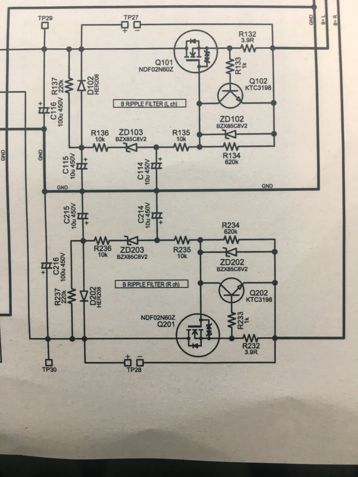

In case of interest, these specific test points are around the transistors.
(I hope its OK to post part of the circuit diagram here.. will take down if needed)

Check your test points after a few months of use. The ripple filter recently burned up on my TU-8600. A couple of months ago I was checking voltages after doing some vacuuming in the cage to remove dust. I noticed a large voltage discrepancy on some of the same test points. A couple of weeks later the ripple filters burnt up. I lost Q101, Q102, Q201, Q202, ZD102, ZD202. after powering on.
I still don't know the cause, I'm stil using the same tubes, and after replacing the shortet and open components the voltages are closer to spec than ever.
It's a long shot but I think I got a funky batch of NDF02N60Z
Correction: I lost the left channel ripple filter but replaced the same components on the right channel for redundancy
