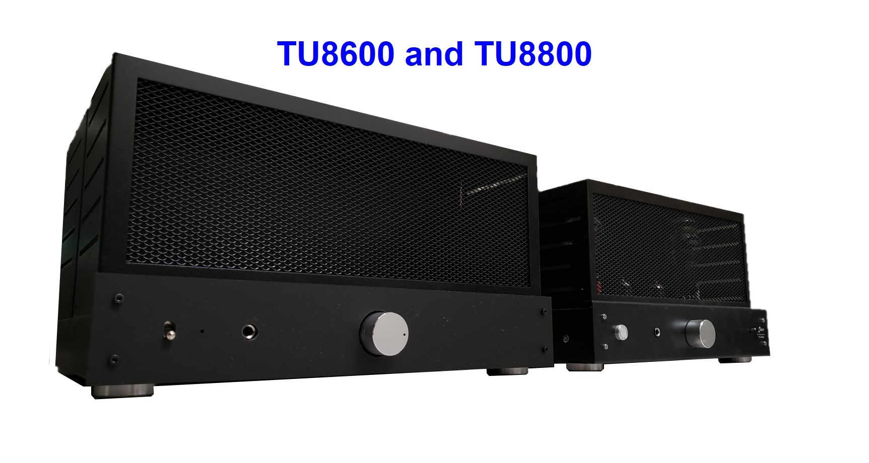

Although TU-8600+Lundahl's transformers were excellent, but my target was an amplifier with all WE tubes.
TU-8600's case is small and outputs of AC power transformer can't support WE274A/B tube rectifier and DC coupling,
so WE417/437- interstage transformer - 300B was the choice.

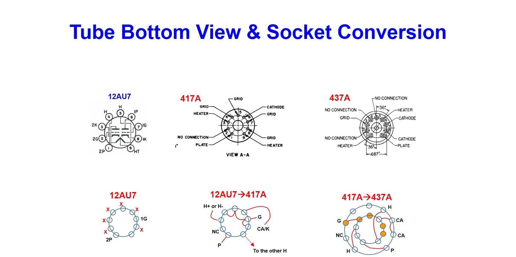

For the interstage transformer, I used LL2756 and wired it to 1:2 ratio to get 2x voltage gain and accommodate the high bias current of WE437.
I re-wired the input tube sockets for WE417, made a conversion sockets for WE437 and made cathode resistors replaceable for adjusting bias current so that I can try both tubes.
Due to WE437's cathode current can be as high as 40mA, add a buffer transistor with heatsink after the high voltage regulator LR8 for suppling voltage to WE417/WE437 is necessary.
Fortunately, all the 5 transformers can be put into the case by turning the power transformer 90 degree vertically and output transformers and interstage transformers 90 degree horizontally.
I also CNC a black matte acrylic front panel for TU8600 to match my TU8800. (note: TU8800's case was also painted to black to match TU8600)
