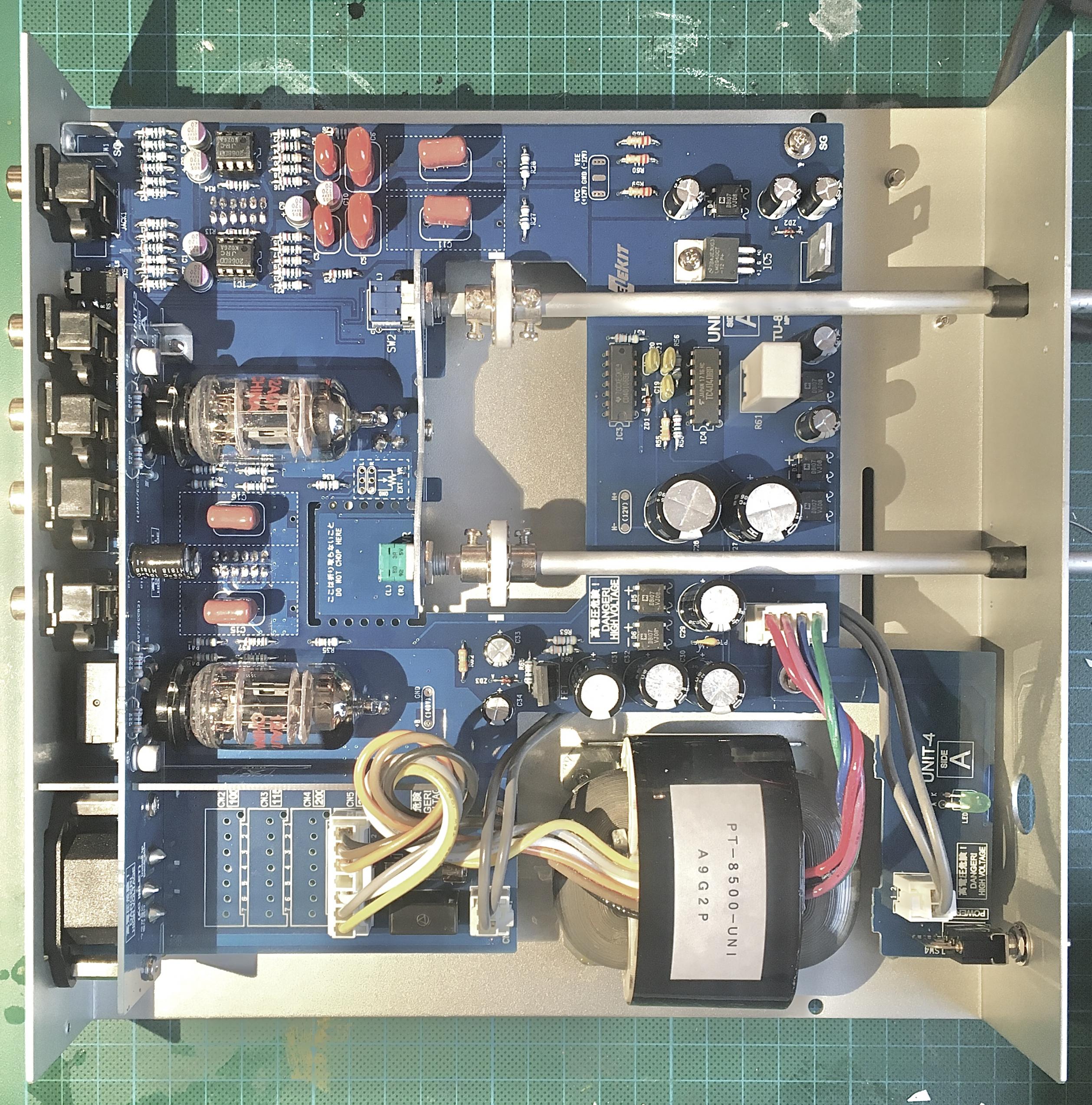

It's working!
"99% is the soldering issue". I guess vkung is the King!

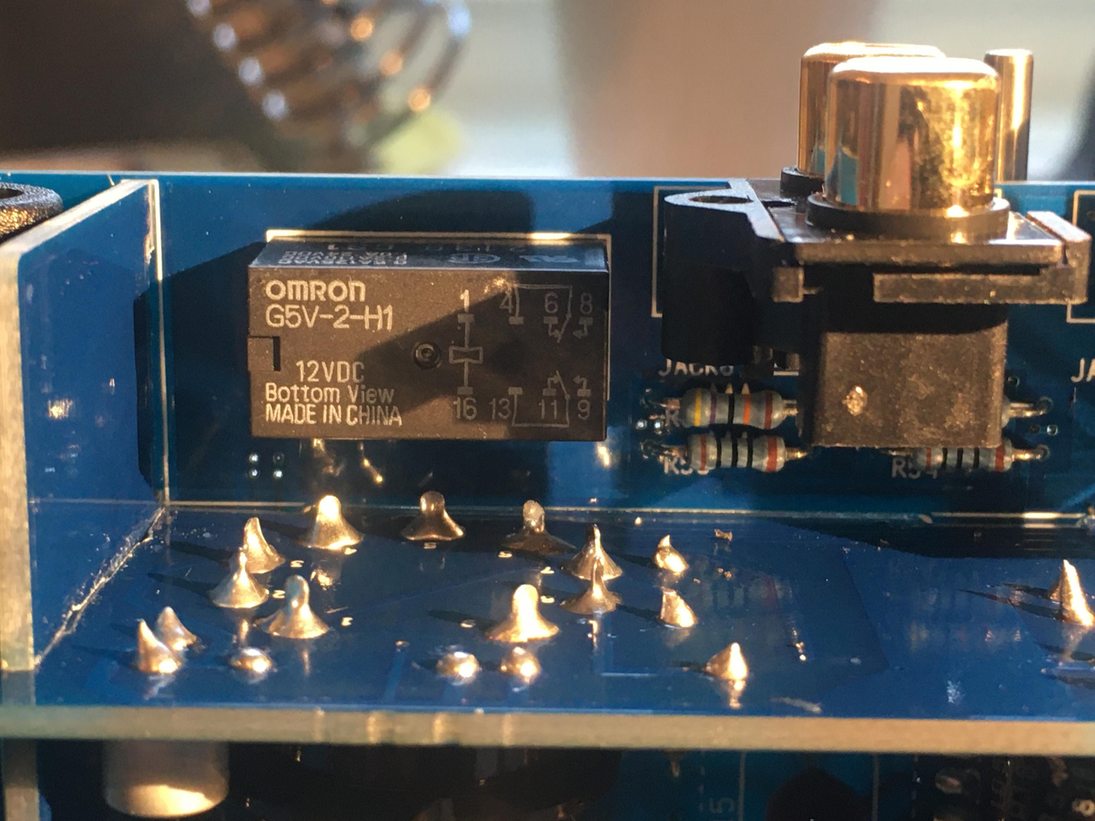

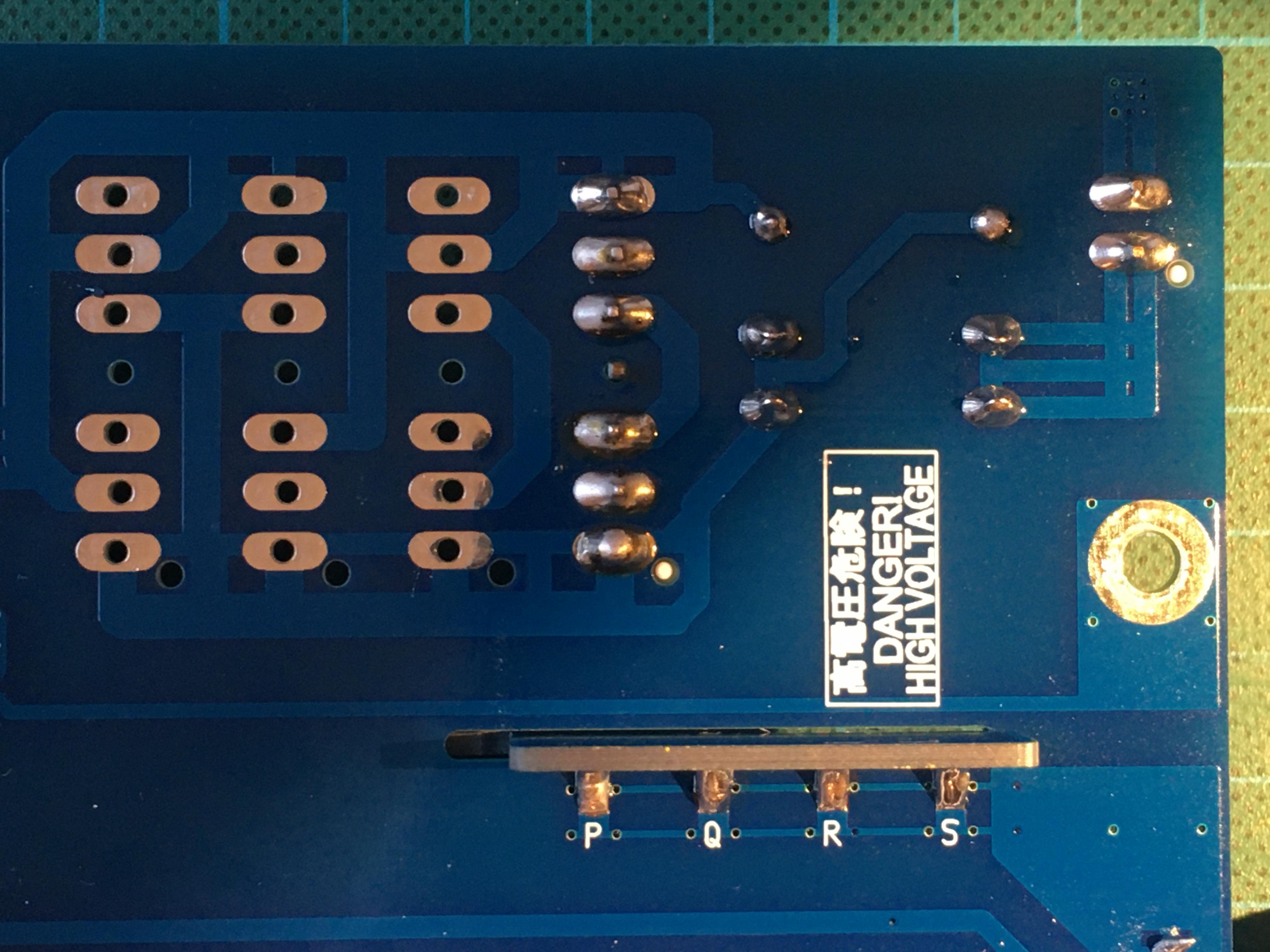

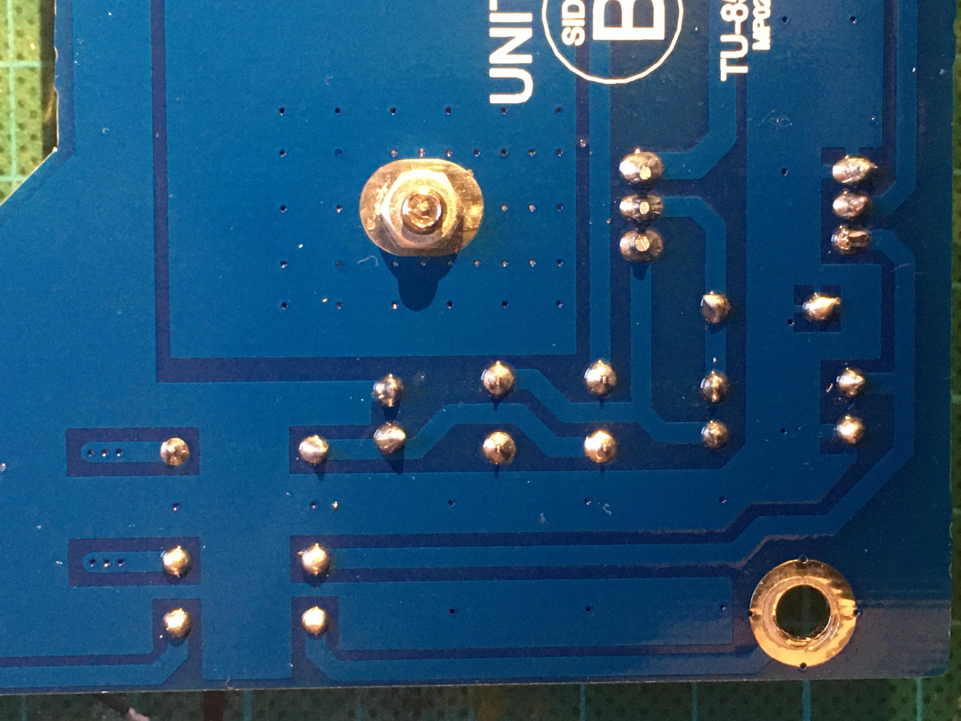

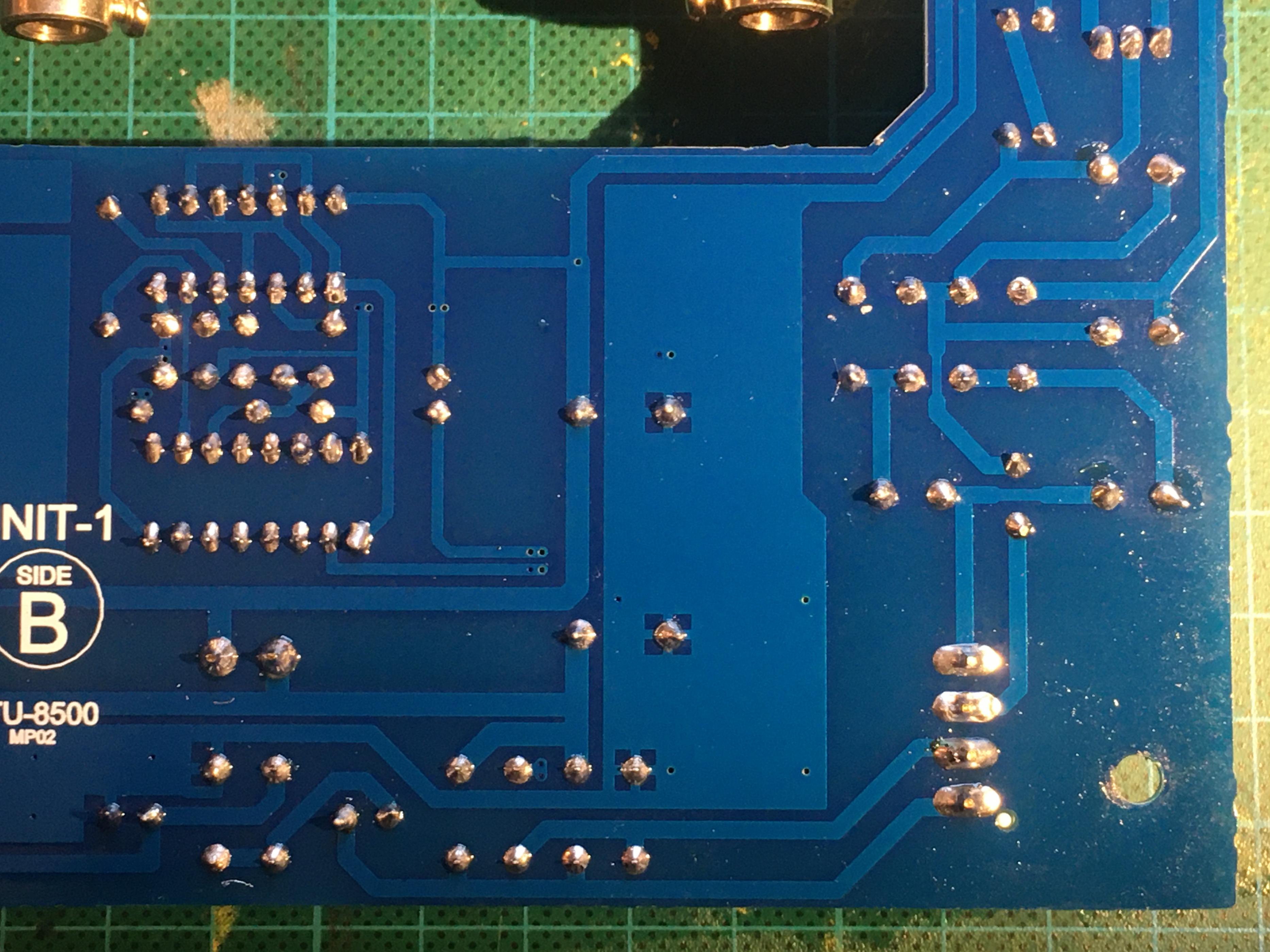

I got my new soldering gun today and had some time alone and re-soldered all bad joints I could see and the 90 degree solder connections (thanks Badchile).
I'm glad I didn't start measuring inside and kill myself.

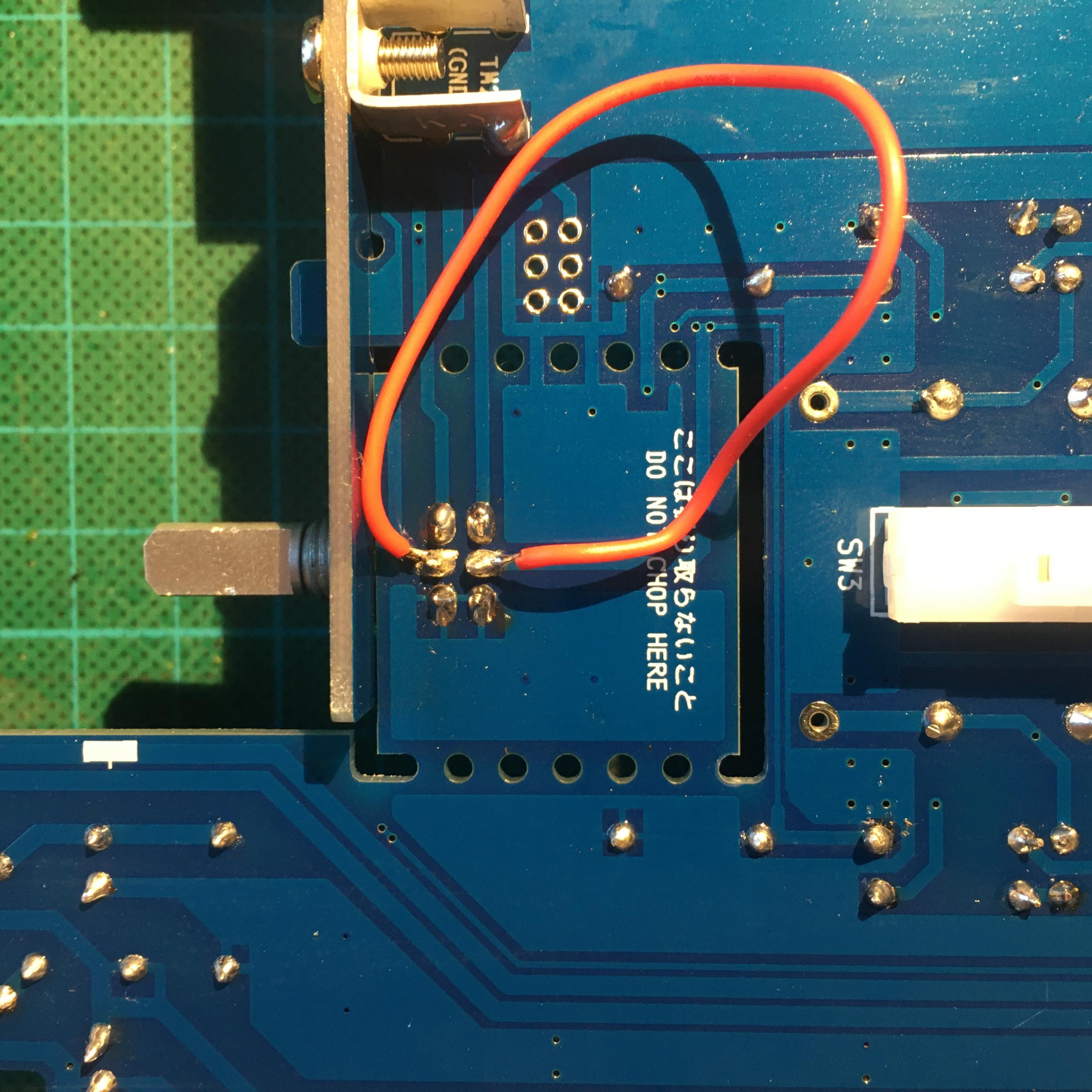

One thing that buggs me is that I'm not sure exactly what was wrong. But 99% sure the Bug was here:
Thanks for all the help! The kit was fun to build and the amp sounds great. I hope I didn't spam the forum but who knows I might stay here a bit more ...
Congrats on fixing (if not necessarily finding) your issue. Every time I listen I'm very pleasantly pleased by the TU-8500. Absolutely not just one of the best values out there, but one of the best, period.
