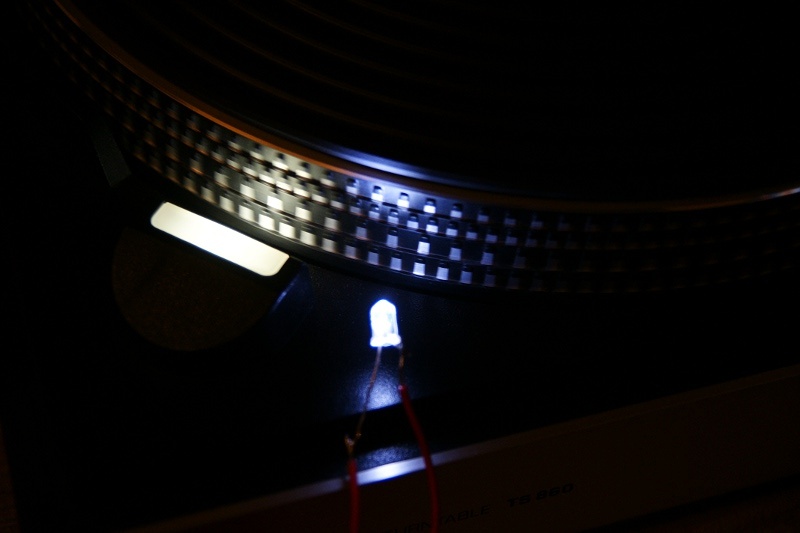

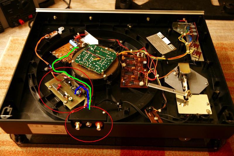

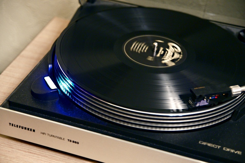

I like led strobes - very sharp image for those markers. (because there are narrow pulses instead of a sinusoidal form).
