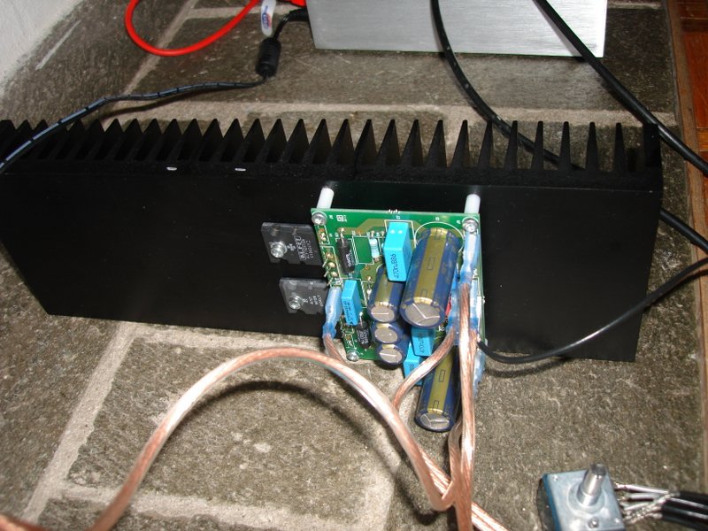

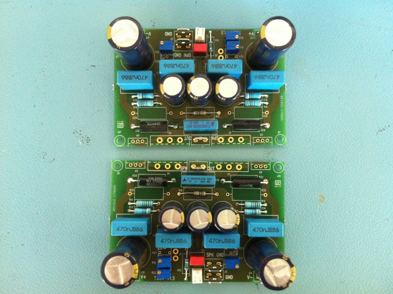

As you know i have laid out the PCB TSSA V1.5.
I will be offering this PCB in three variants:
If there is any interrest mail me on audioparts@sitosite.dk
- Bare PCB - €21/channel
- PCB with SMT assembled €39/channel
- PCB with all SMT assembled and all parts except heatsink - €102/channel
- TSSA module assembled and test on a SK56 150mm heatsink - €253/channel

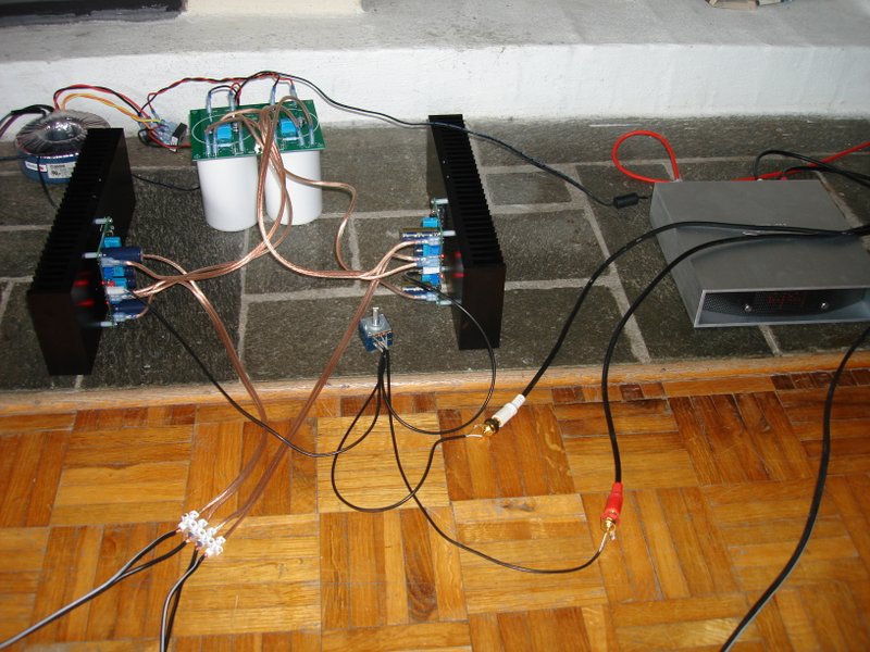

Hi Salas and Meanman1964.
I have attached the measurement.
I will post the schematic and bom as soon as i have tested it with the renesas mosfets

Interesting, it simulates to have more second and what comes out more is the third !
That goes lower when the wattage goes down.
Takes an Lpad to divide signal tapped off the 8R dummy so not to overload the interface's input and see at 1/3 nominal RMS power. That would be more like it in speakers. Square waves at such power would be nice too.
