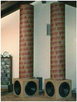

The catch is: is any enclosure insensitive to VAS, good for bass and not huge?
The best examples I can think of would be an IB or big fully-absorbing line (something like the el pipe-o sub, but with more stuffing) - and while they do make good use of floor area, they aren't dainty :)
