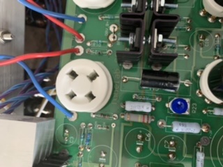

Here's the actual one (click picture for better image). The solder pads on the board look pretty torn up, but I've checked that there's no connectivity issues between these pads. The underside of the board looks much cleaner.
Here are some additional pictures of the board as it is currently. Tubelab SE - KHG album
Those are the exact same fets that are in the board that's in my hand now. Even the SPH30 (date code?) is the same.
Try resoldering the end of R25 closest to the pot from the top. The solder joint looks a little odd, at least in one of the pictures. I have seen some odd issues with solder joints that get thermal cycled a lot, and those resistors will get real hot when the fet shorts out.

However, I did fix the problem! I broke my own rule and did two things at once, so I probably won't ever know exactly what the issue was. I replaced the fet with yet one more (my last new one) and I decided to remove the chance of a solder bridge. Because the pads on top looked so bad, I broke the path from the center fet pin and bent the center pin of the fet and bridged it directly to the B+ pad. Looks crude, but it works! Really appreciate all the help!

Well, I'm back up and running (for a few hours now, anyway). Just wanted to bring this thread to a close in case others experience the same issues.
I replaced R34, since it had blown. I also replaced the right channel MOSFET again, using the one recommended for the TSE II. It seems to work fine. Upon replacing the fet, I did what I did on the left channel and bridged the center pin above the board to the B+ pad immediately in front of it and severed the path on the board leading to the center pin.
I also severed the board between the center fet pin and the left fet pin (the one closest to Q2 if looking down onto the board). I did this on the left channel as well. The board almost seemed hollow between these 2 pads. When I was scraping away all the crud, the knife blade sunk easily into the board at that point. I wonder if this small area is susceptible to shorts - perhaps promulgated by the heat buildup over time? The same happened between the same 2 pins at Q2.
I added a small fan and raised the chassis up to create a bit more airflow. Hopefully this will help keep the temperature down a bit.
