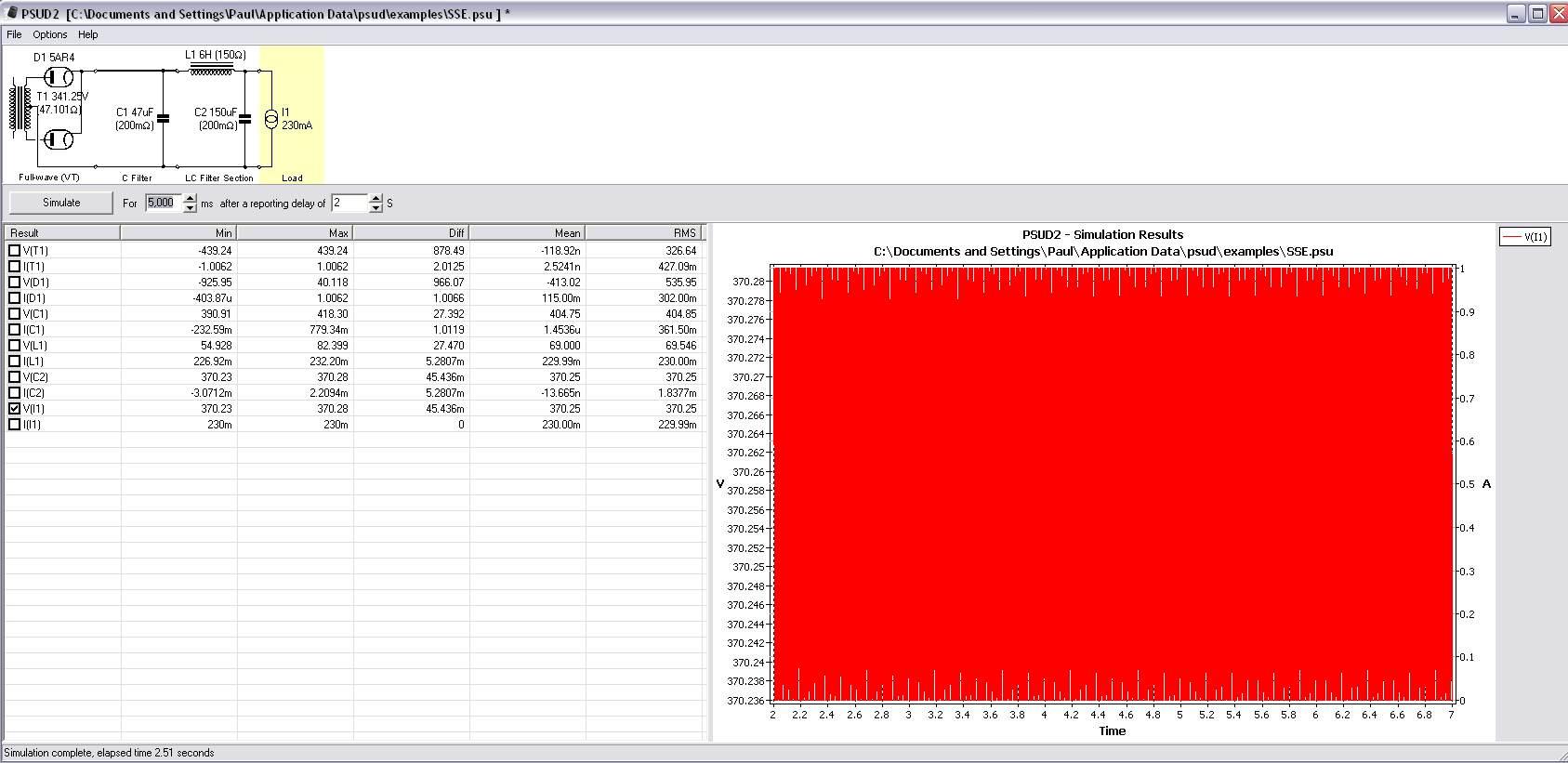

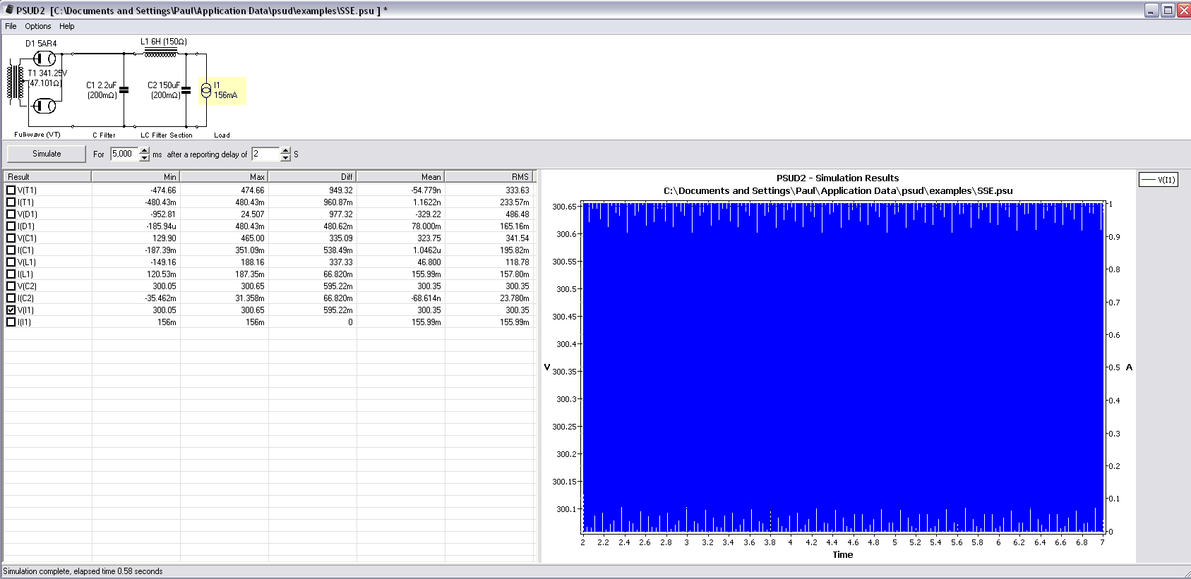

Back to transformers. I am now looking at the 373EX. What a monster! I like the look of the 6.3v winding on this one:
So, no problem at all running 300Bs with this, obviously, and it'll be better capable of powering the 2A3 filaments for sure.
Here's what PSUD2 looks like with this transformer, 47uF C4 and 230mA load (2x 300B @90mA + "board load" @50mA):
And here is what PSUD2 looks like with the same transformer, 2.2uF C4, and 156mA load (2 x 2A3 @53mA + "board load" @50mA):
So, what's not to like about the 373EX (other than the price)?
