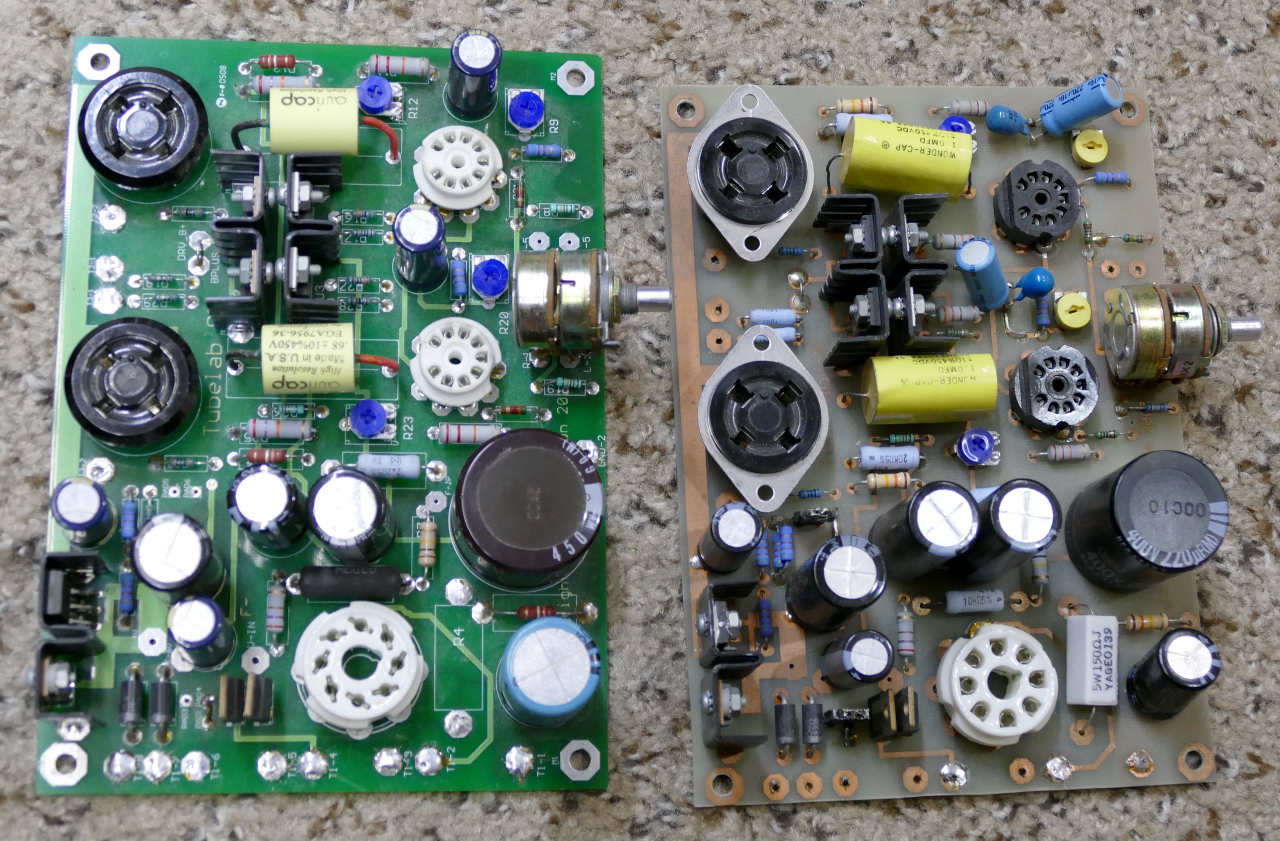

Sorry for not being around much....life gets in the way. Did you ever get this working?
No ... it just sits on the floor collecting dust 🙁
I have yet to pull the legs of the bias circuit. The poor board has been soldered and re-soldered so many times replacing FETs and re-touching all the joints I am afraid to apply heat yet again.
If it were me I would go thru the entire build procedure visually and make sure everything is correct.
I can't figure out where to go from here based on the information available.

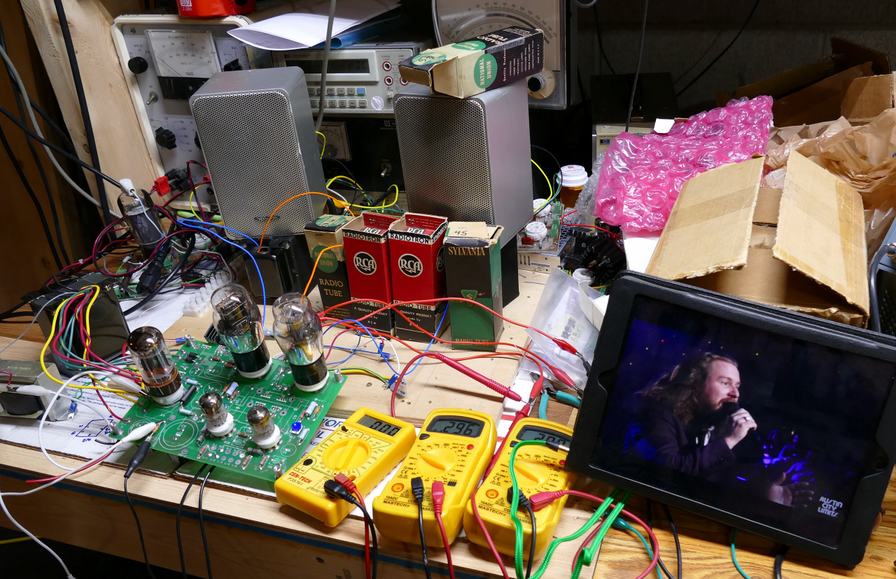

It's ALIVE!
Admittedly a rather low Fi setup, especially those trendy Radio Shack speakers from 1980, but it the best that I can do right now. It took me much longer than I expected to find things like my box of 5842's and a suitable set of OPT's, but I found all sorts of missing things in the process like a long lost guitar amp, and some OPT's that I had forgotten about. These things haven't been seen since I lived in Florida, more than three years and two moves ago.
has been playing for a couple hours and there were NO dead parts.

Awesome! What was the culprit? 😕

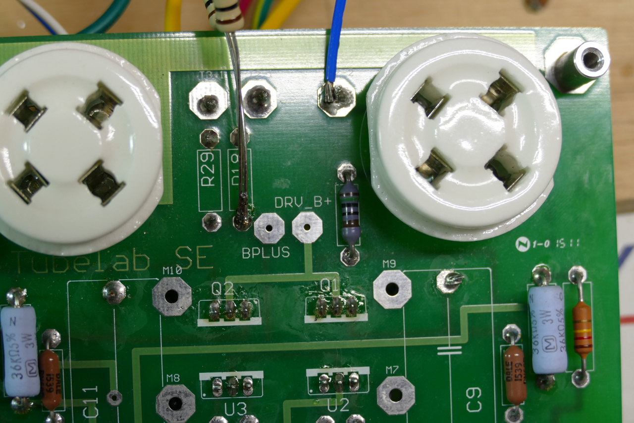

It was so obvious that I missed it until I powered it up and starting poking around with a voltmeter and found no drain voltage on the mosfets. There is a wire jumper that supplies this voltage. It was not installed. This was not visible in the photo that you had posted since it is on the other side of the board.

So, this design feature allows one to pull that jumper and isolate the B+ to the power tubes, from the rest of the board?
In other words, higher than ordinary voltage for the power tubes, e.g. 811 ish voltage, could go to the BPLUS pad, regular "low" B+ voltage to the DRV_B+ pad?

I put those jumper pads in there for what was going to be a 3 stage monster SE amp using the TSE as the driver. Unfortunately only one would ever be built, my 845SE which is sitting on the shelf waiting for something between a power supply upgrade, and a total rebuild. There are multiple instances of exposed electricity up to 1050 volts and grandkids come here.....
Those pads actually only isolate the B+ voltage to the mosfets. The limiting factor for B+ on the board is heat and breakdown voltage in the mosfets. This jumper, and the -Vin pad next to the Fred diodes aloe operating the mosfets from an external power supply. I used +/- 150 volts in my 845 SE, and ran the TSE board from an external 500 volt supply.
To run 811A's or other big voltage tubes, build the TSE with enough power supply to generate the drive for the big tubes, then just tie the red wires from your OPT's to a power supply with enough voltage for the big tubes. That supply never needs to touch the TSE board at all!
I will unhook and pack the board up and send it back to you tomorrow or Wednesday.
Now I feel stupid! How did we miss something so obvious when we had both boards side by side? Thanks so much for checking this out!!!! Send me a PM with what I owe ya!
