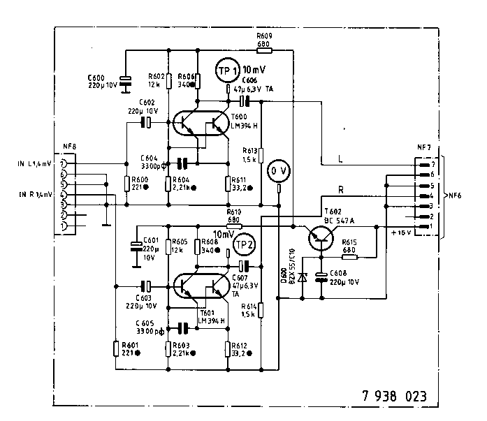

I acquired recently an EMT TSD-15 cartridge (MC) and I would like to know if someone on this forum has "play" with it, and could give me some advises on the best loading network for it (R and C).

No capacitor needed...
Moving coil cartridges are lower impedance than moving magnet, so if they need capacitance to fiddle their response, we should expect it to be a much higher value. Note that the specsheet you linked to notes that the capacitor is built-in, so this implies that if it's needed it's already there. In other words, don't worry about it.
Further, I looked at the diagram for the EMT938 moving coil pre-amplifier for the TSD 15 cartridge. It loads the cartridge with a 221 (220 would be fine) Ohm resistor, but no loading capacitor.

Could you post here, or e-mail me the moving coil preamplifier diagram ? Even if you have the entire RIAA amplifier I will be interested to have a look on it .
Here's the diagram. I didn't notice it on my first look, but there's a 3.3n capacitor almost loading the input. It's there to prevent RF problems, and the cartidge loading is incidental.

Thanks EC8010,
It seems that in my TSD 15 sfl, there is no capacitor, so it's o.k. and like you said this is not the capacitor the most important, but the loading resistor.
Firsts tests seems to lead to a value around 100R.
