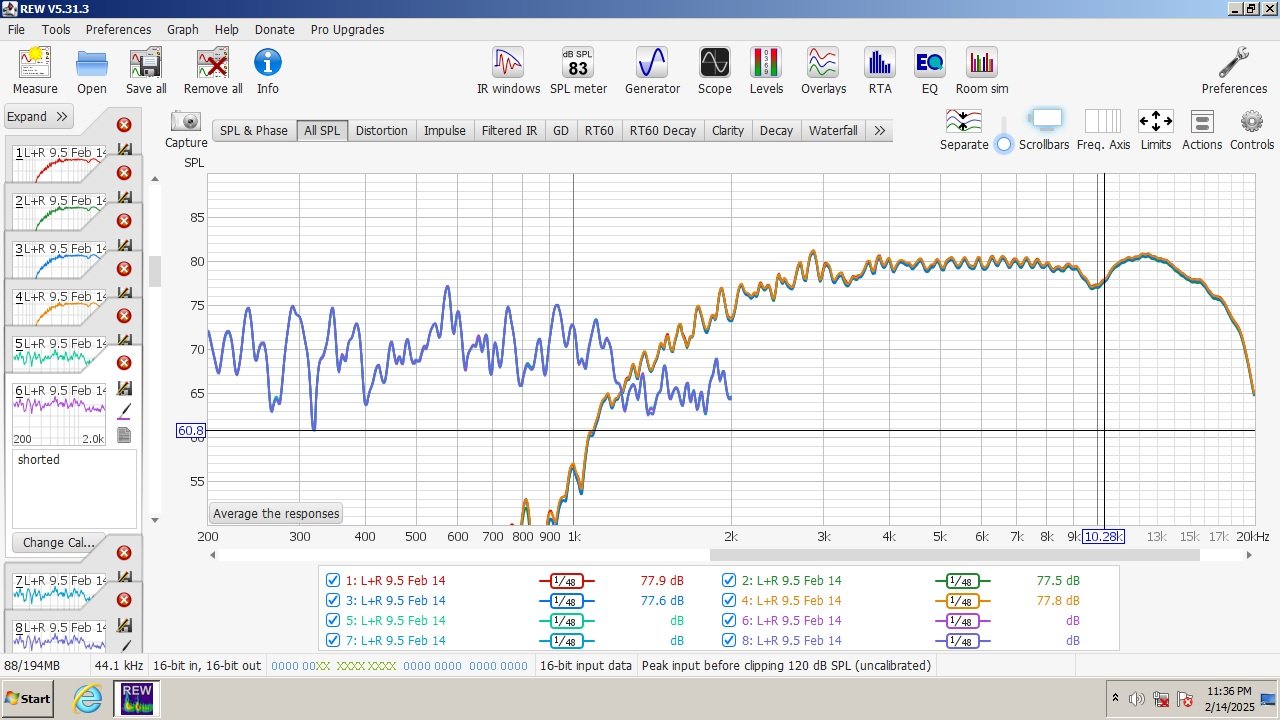

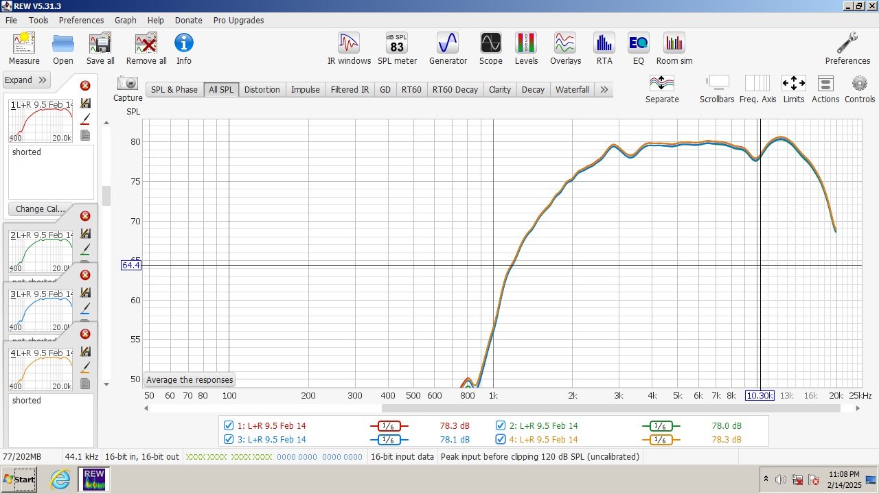

Four tweeter sweeps. Two shorted, and two not shorted. I see no difference.
I can sweep a mid starting at 300hz, but I suspect the same results. I meant to change the smoothing. If there's any difference, I'll comment.

I ran the all the same as temp25. No difference. I saved one set but after I did the planar and mid with the other drivers shorted I didn't even bother saving it.
I also connected them to separate amplifier playing no music. A couple said this would pull the ribbon "tight" and prevent a woofer from moving.
I'm calling TOTAL BS on this theory
This is 3 measurements on top of each other. Might as well be the same line.

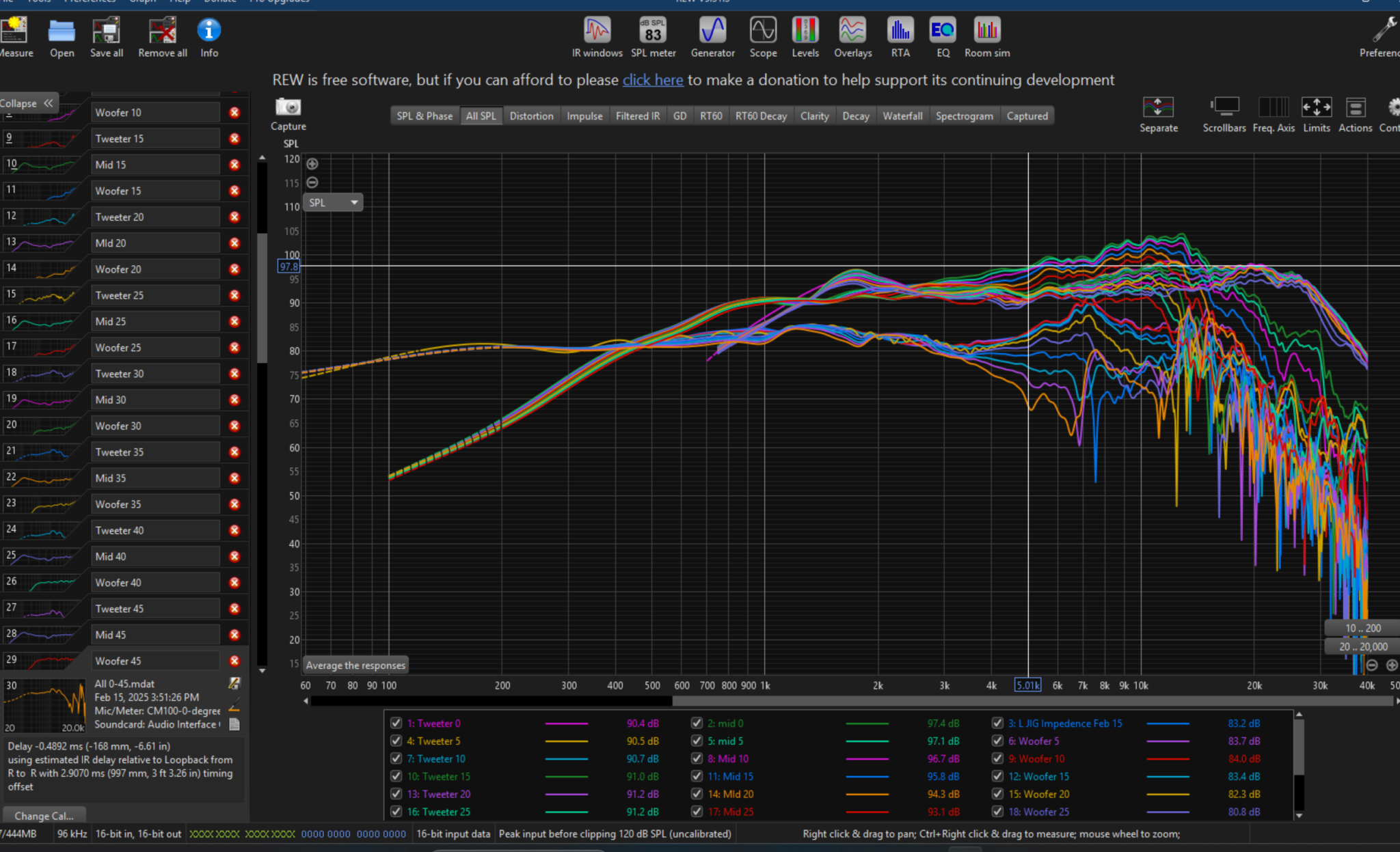

The real answer here was the jig I used to take the measurements. It was a reflection off of it. I believe it was A4e who called that one. Well sir, kudos to you, if I were handing out grades you'd get an A+ and a scratch and sniff sticker.
That said, since I could use the jig there was no perfect way for me to take the driver measurements EXACTLY in place with the mic. So I took it where my head will be in relation to drivers and got 0-60 degrees of the horixantsl with 5 degree increments and 0-30 degree in the vertical with 5 degree measurements. It took me forever since the yoga people were walking above my shop. I had to take 4 sweeps and let it average out.
But wowza, this is a lot of data
Reactions: A4eaudio and AllenB
The woofer data doesn't matter. Nothing there to analyze. All the crazy stuff is well above the x-over point. It's mostly a geometry thing involving different distance to your ears. The cancellation is less at low frequency. I'd probably cross below 3k, if you can get the position / distances right. Crossing really high puts the issue where you likely will not notice. I'd try both, and listen. Till then, it's anybody's guess.

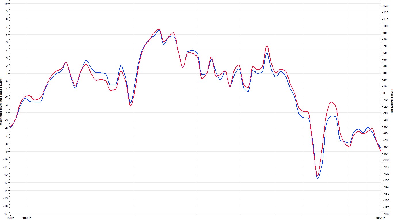

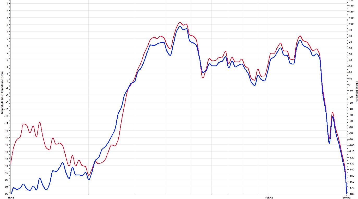

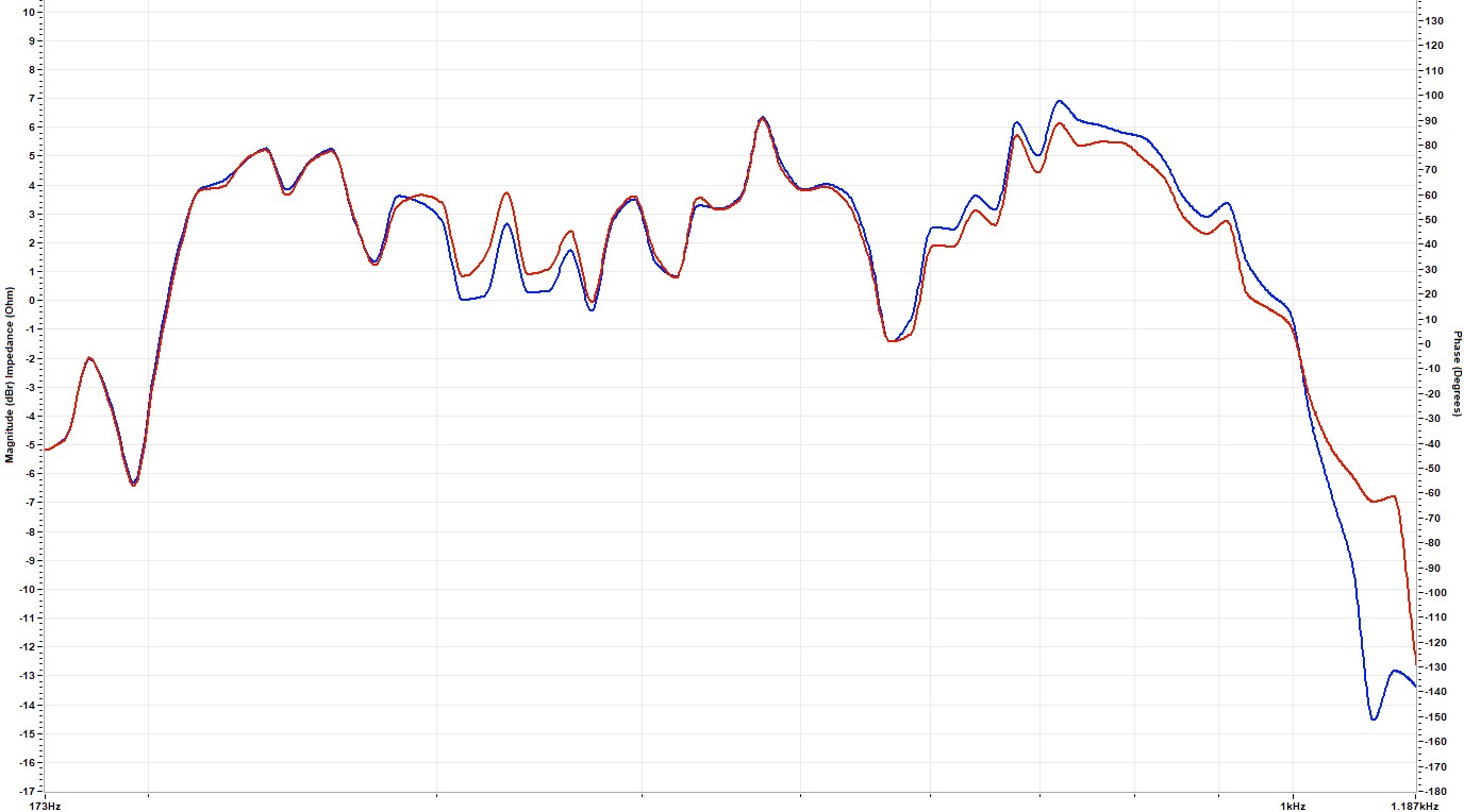

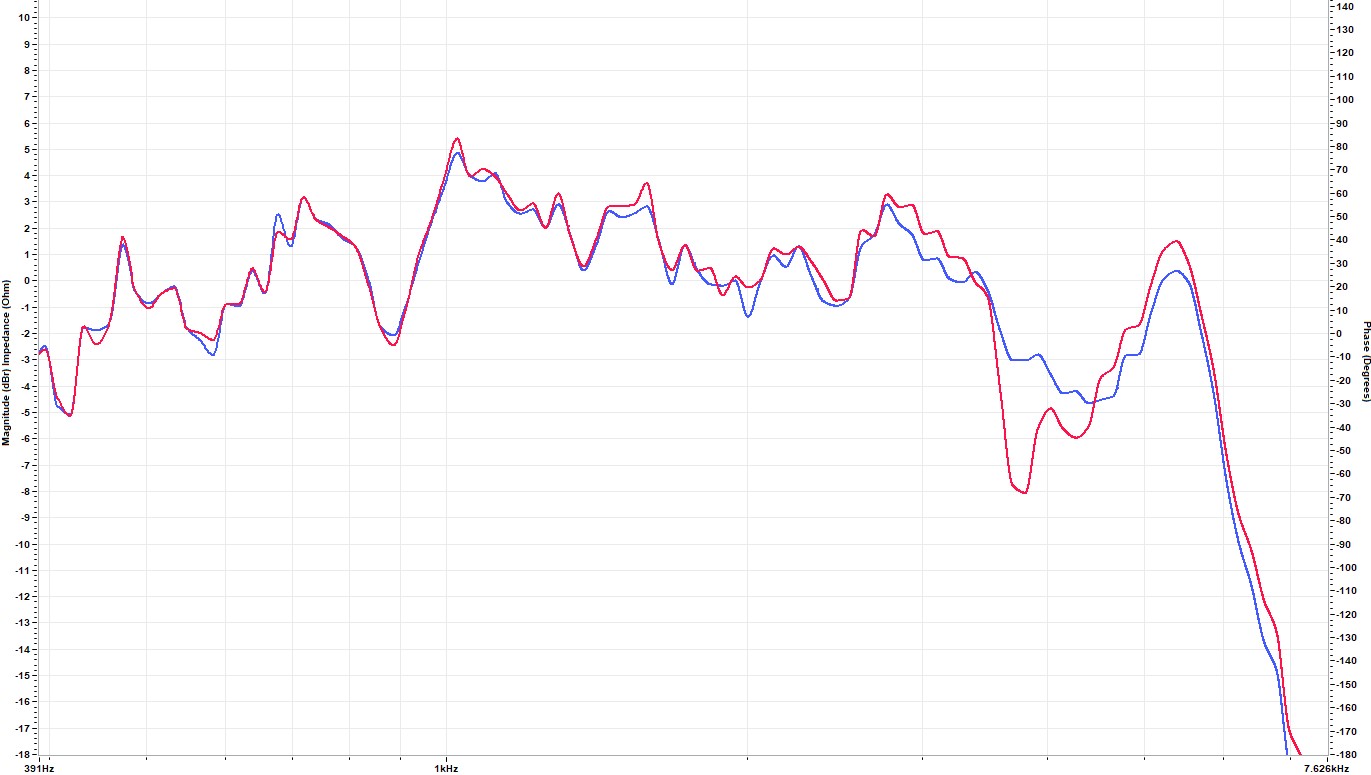

Here are 4 sections of a multiway, measuring each section separately. Low, mid, HF, and VHF.
Each section with all other sections either un-shorted or unhooked from amp with no signal...... in RED.
And each section with all other sections either shorted or hooked to amp with no signal....in BLUE.
All traces 1/24th.
Draw your own conclusions.
In practice, I've found the high end of the spectrum to vary more than the low end, other sections shorted vs not.
LOW
MID
HF
VHF
