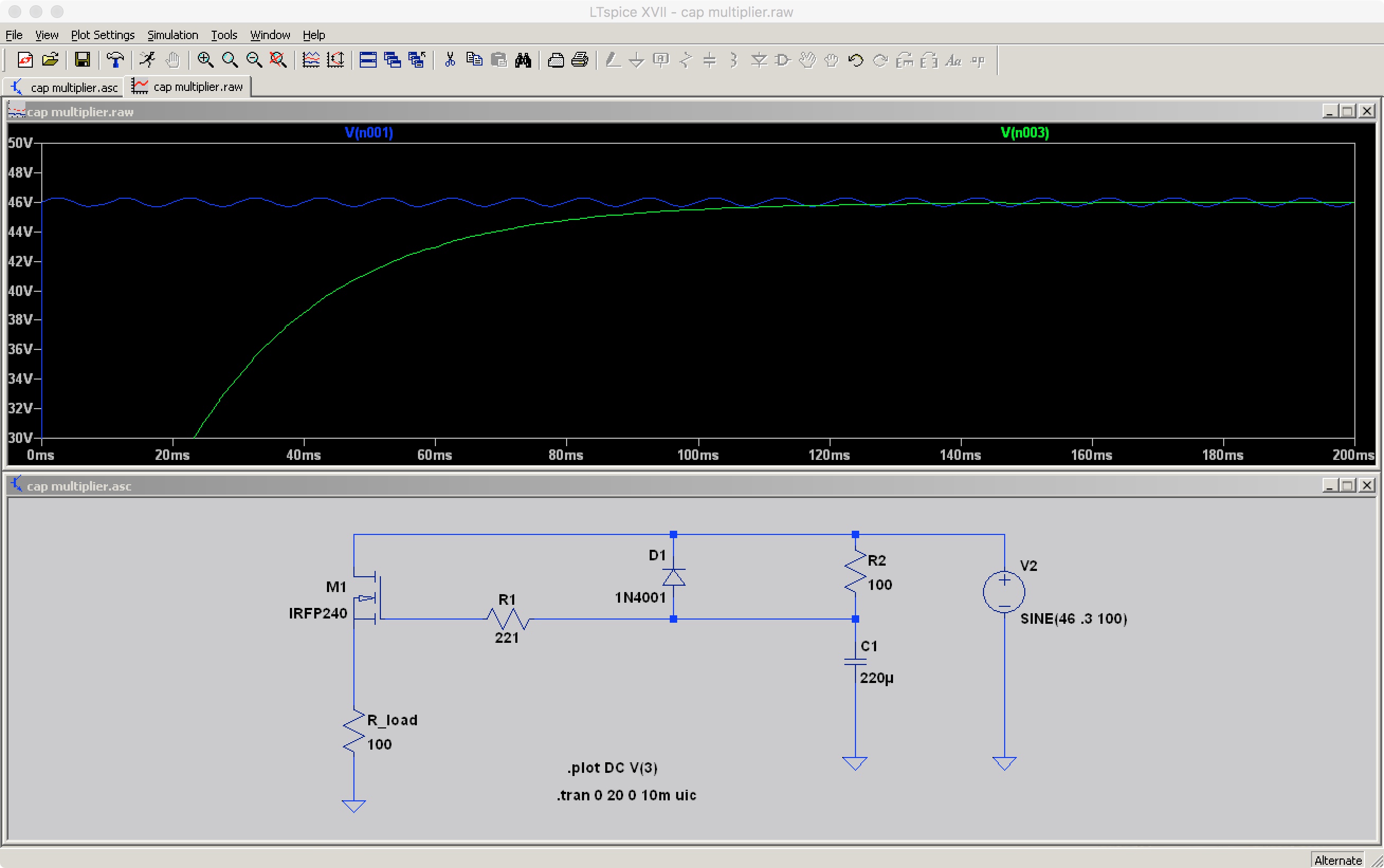

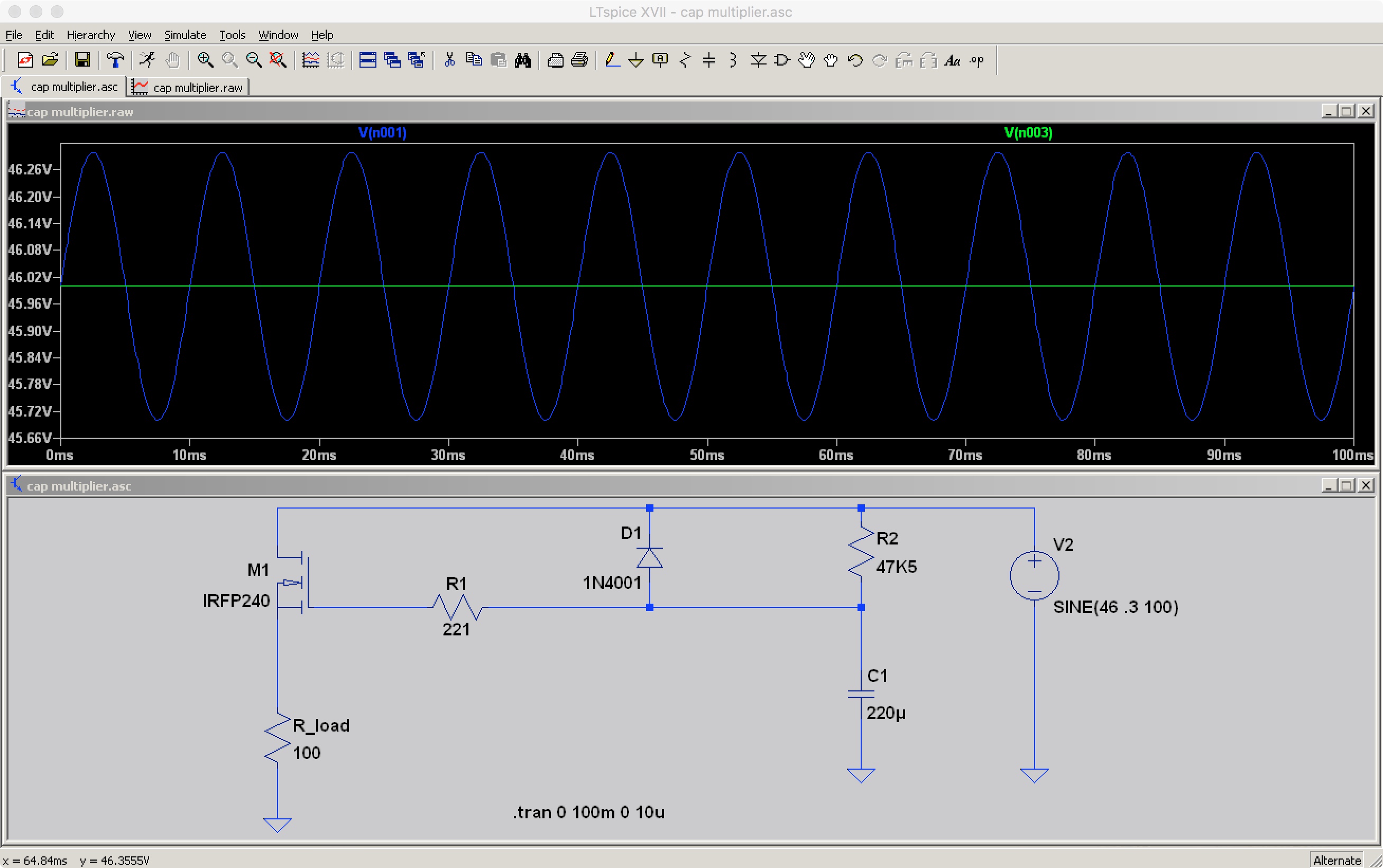

I've been trying to sim a simple cap-multiplier circuit. It's a somewhat inaccurate model (my source is just a sine wave over dc), but that part works as expected.
However, if I output data from time=0, I don't get the slow rise I think I should. Shouldn't there be an initial current surge over R2 (and a corresponding slow voltage rise on the node between them) until C1 is charged? All I get is a constant sine-wave from the AC.
What is it that I'm doing wrong?

You are assuming that everything starts at zero. Unless explicitly instructed to do otherwise, LTSpice or any other simulator I know of first calculates a DC bias point and takes it from there. For stable circuits this is the response you would have got if the values you apply at t = 0 had been there from t = -infinity onwards.
