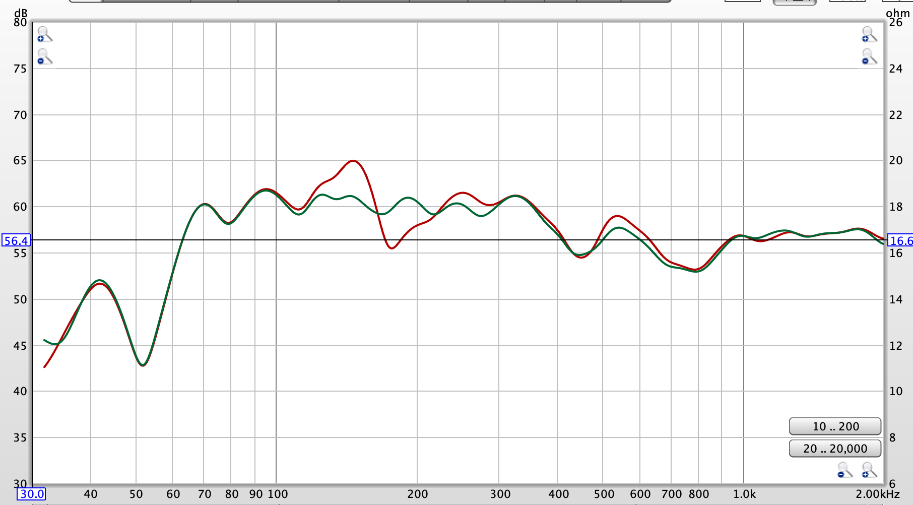

My speaker measured at several spots and average with -20dB. I tried to eq the hump 40-50Hz, but it sounded bad - it is a mode.

Just wanted to add an interesting observation. I stuffed the shelf portion between the two enclosures with pillows, and the ~180 Hz hole went away. Smooth bass performance all the way.
Any theories why this might be?

180 Hz is prolly outside the band where the room as a whole has influence.
Hard to say if your "pillows" absorb or reflect or both?

Filling the cavity obviously eliminated at least 30% of waves going around the bend of the baffle and making SBIR reflection/nulling.

Tested filling the cavity with MDF. Here's the result
