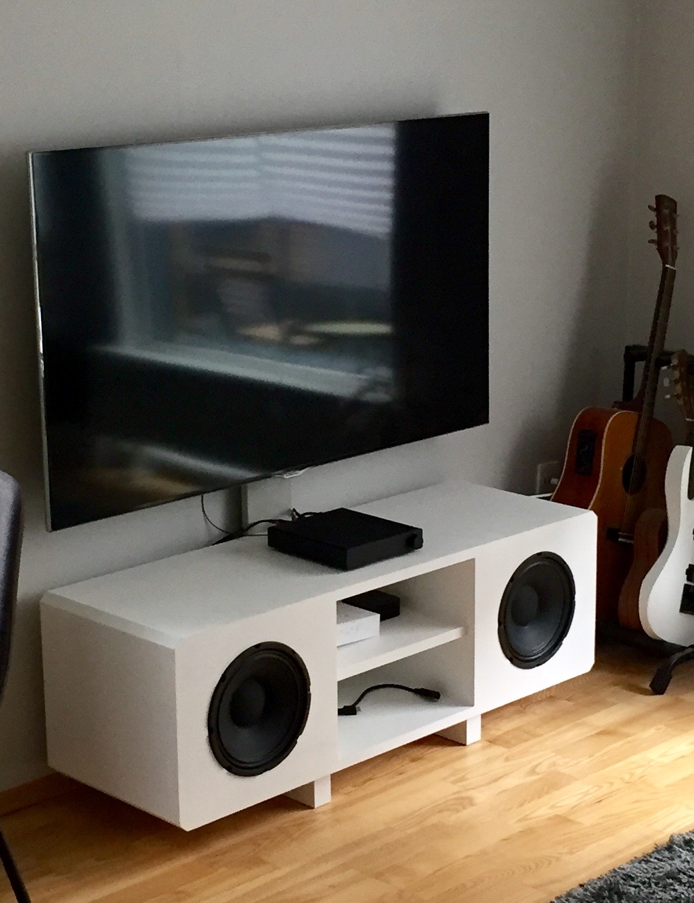

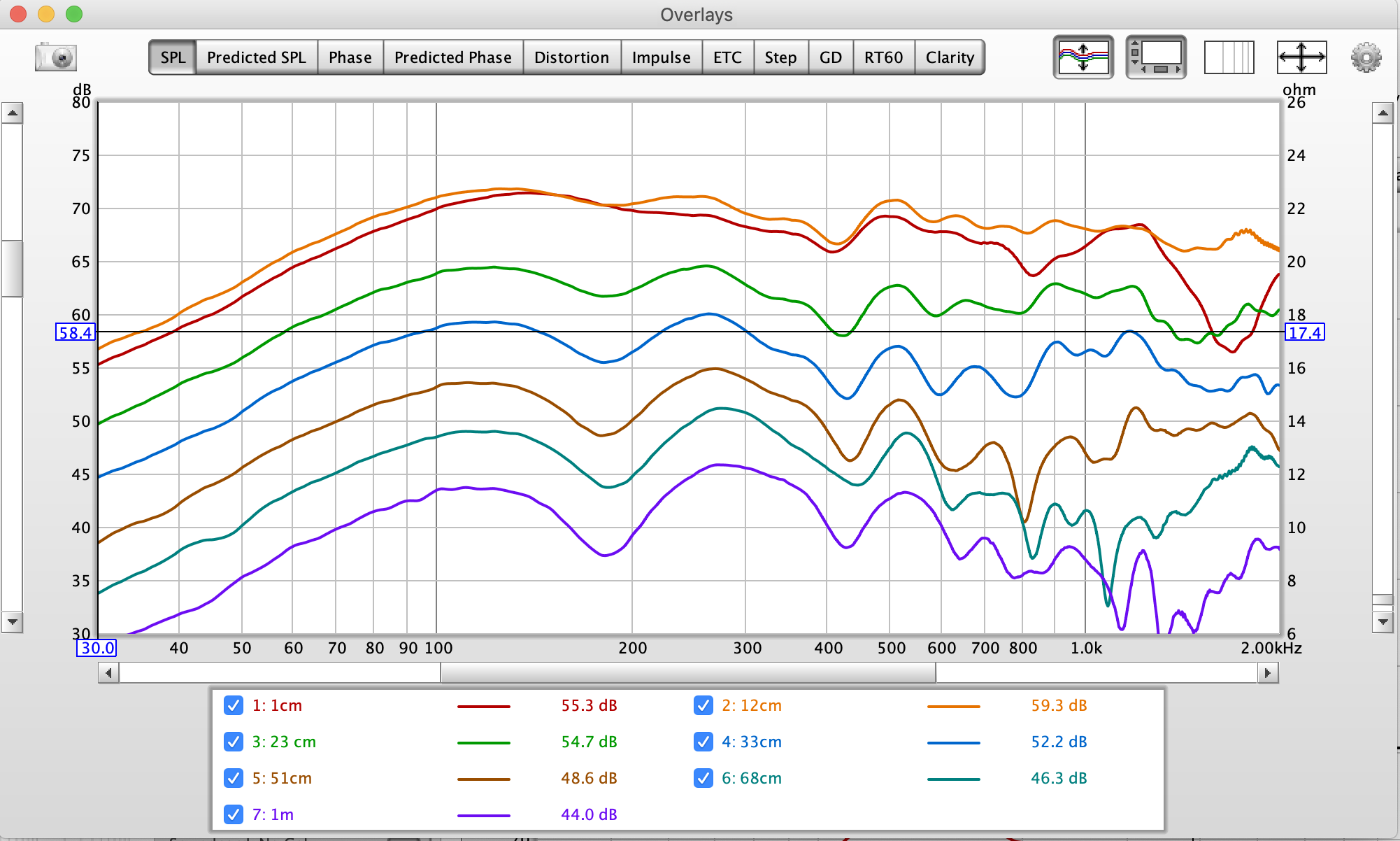

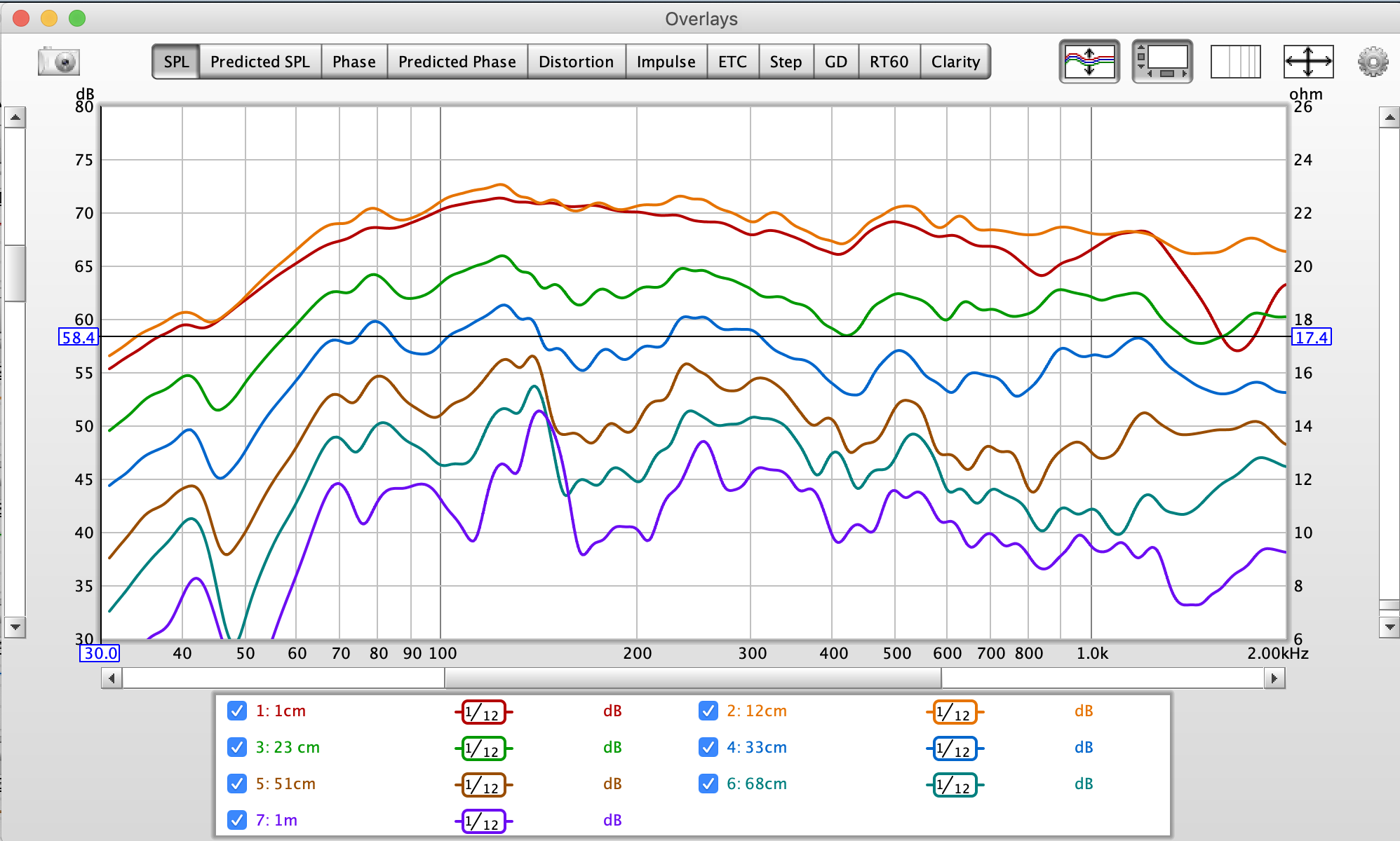

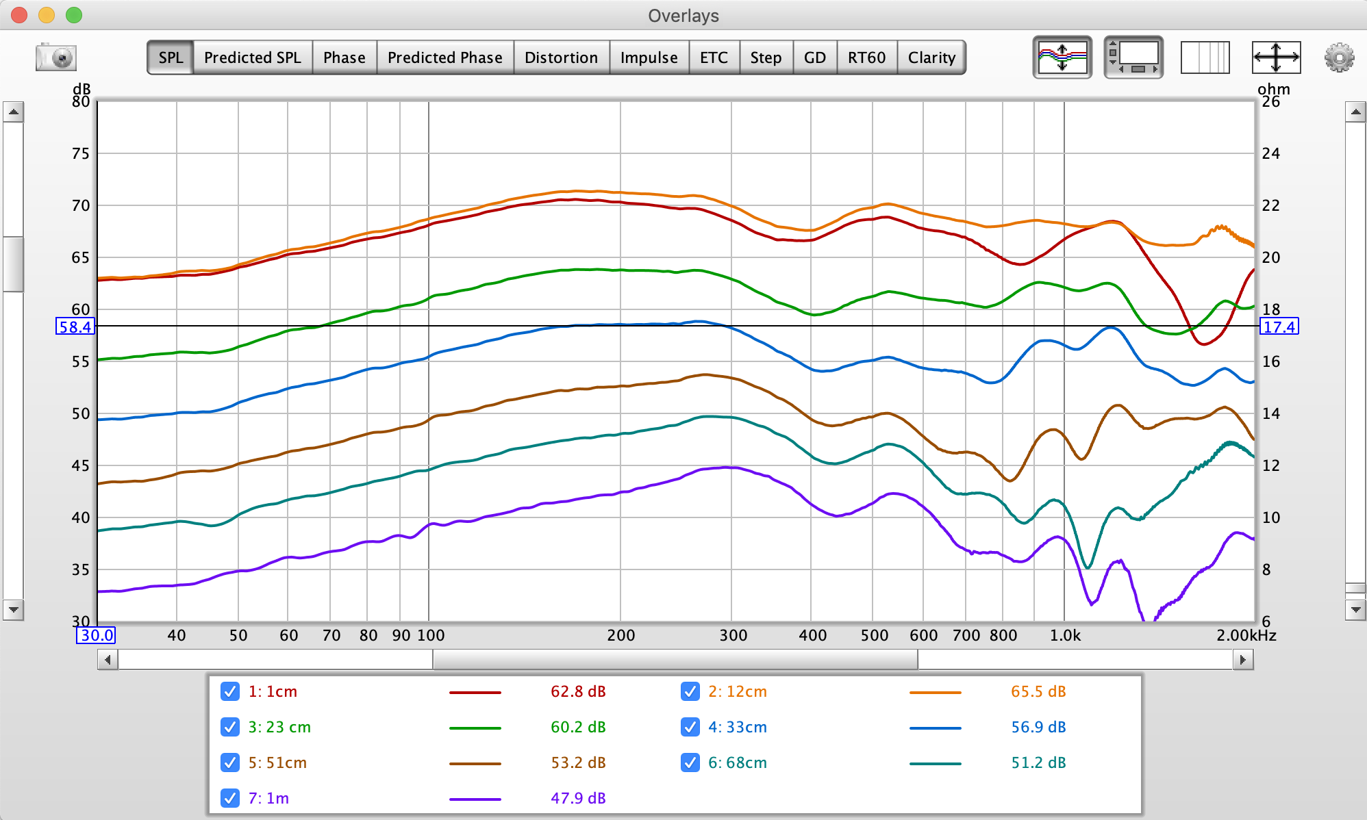

I'm trying to figure out what kind of baffle step loss I'm seeing, and have done a bunch of measurements.
Based on calculation (11500 / 36,8 cm) I should see baffle step occur at ~312 Hz.
But other than the amplitude drop around 400 Hz which is driver related (by looking at the near field measurement), the only other place we see a drop is ~170 Hz.
Could someone help me interpret my measurements to try and make some sense of them?
They are done at distances of 1 cm, 12 cm, 23 cm, 33 cm, 51 cm, 68 cm, and finally 1 meter.
First with no gate and 1/12 smoothing. Then no smoothing with a 10ms gate and then a 5ms gate.
Also added a picture of the speaker in question.

I assume the floor and rear wall are a fixture in this design. Considering the dimensions involved I'd consider moving the mic further back. It may become difficult to gate out the ceiling and side walls.
I reckon what you're asking is if the woofers close placement to the floor and the enclosures close placement to the back wall are intentional?
If so, then yes they are intentional as a way of reducing floor bounce and boosting bass due to the enclosure being sealed.
The furtherest measurement above is 1 meter. I have an averaged measurement from listening positions below.
You mean the floor? Ceiling and side walls should be more than far enough away to easily be gated out no?
Ok, then maybe they should be included.the woofers close placement to the floor and the enclosures close placement to the back wall are intentional?
How far is it from the driver around to the wall and back to the baffle (maybe 1.2m)? You have the potential for a hole at 145Hz and 430Hz. To measure this properly you should not be too close to the speaker. As you can see from your measurements the relative intensity of the direct sound and the reflection are changing at a different rate due to the different path lengths.

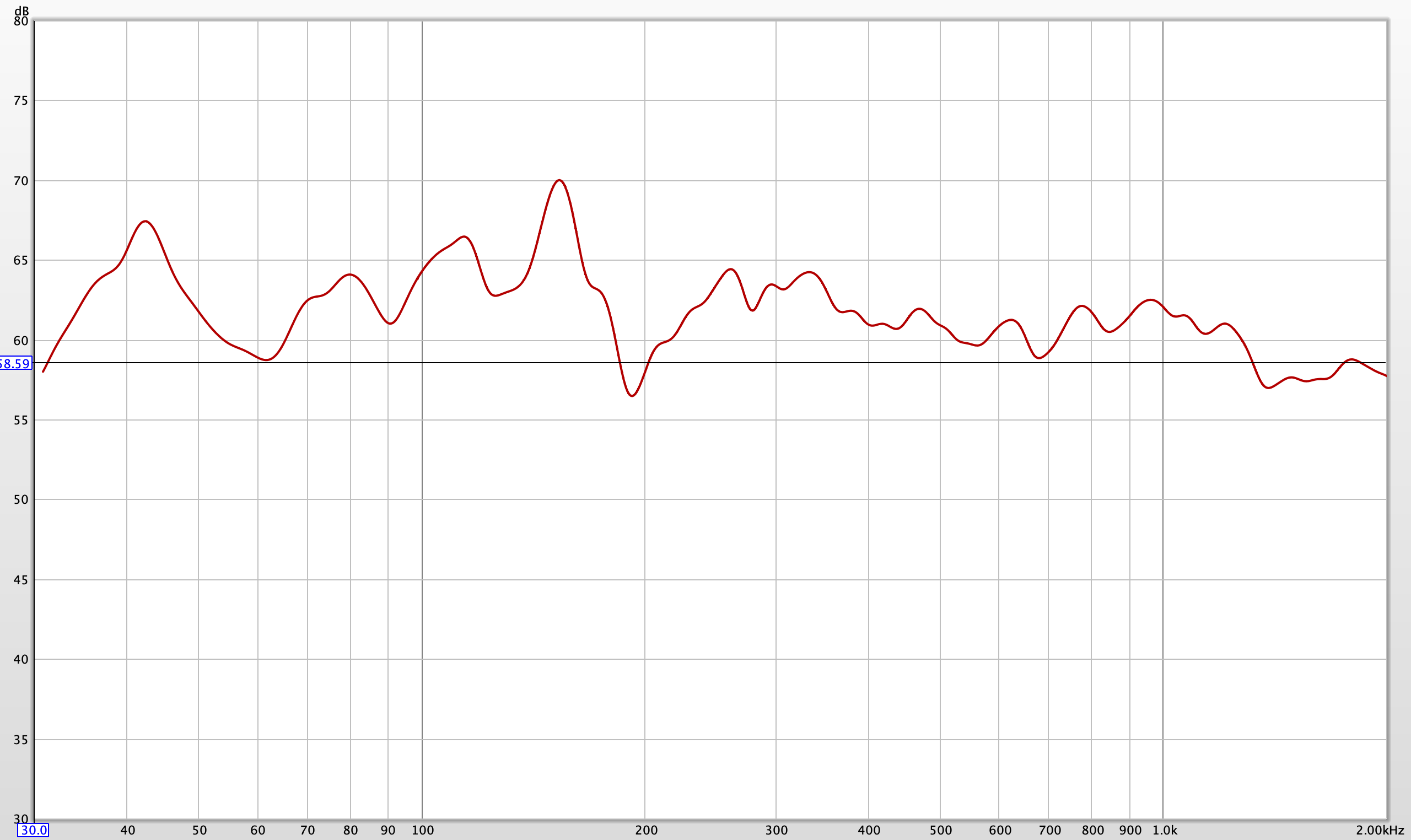

This is excellent. If you have done proper averaging then you should be able to add a sub to fix your <200Hz response.I have an averaged measurement from listening positions below.
I'm thinking of converting the enclosure to a ported design tuned to about 50-60 Hz so I can get a needed boost in that area. I'm curious if that will have any effect on the 180 Hz dip also. Probably not...

I was hoping my combination of near field and far field measurements could give an indication through deduction. For example, we can see that the 400 Hz drop is driver related by looking at the near-field measurement, so we can exclude that from being baffle-step related.
That leaves the drop at ~170 Hz, which starts to show up from a measurement distance of 20 cm and above. But seeing the null gets deeper the further away we measure, it seems like its room related and not baffle step related.
take a measurment at the listenting position, ungated
adjust your software to increase the resolution at low frequencies
Baffle step loss isn't a single number or slope, but if you want to see it in that form you'll need to go outside or at least go in to the middle of the room....
Defo's classy and careful lab work shows that effects like baffle step are trivial compared to room acoustics and other influences. Important to marketing departments mostly.
I like to put the mic where my head normally is. That's the "bottom line", hoping my use of the term "bottom" won't be misunderstood. I use 3 mic locations spread over 3 feet.
My guess is the dip at 62 and the boost at 42 Hz are major room factors and/or related to location of speakers (location of speakers makes a big difference, even just dozen inches). Maybe can only be moderated.

Looking at the 5mS gate, which I assume includes the rear wall, the 400Hz drop changes frequency with distance?the 400 Hz drop is driver related by looking at the near-field measurement,

The measurements if post #1 can not show baffle loss, because long gating grabs rflfecions and room modes, and short gating is not able to show low bass response right at all.

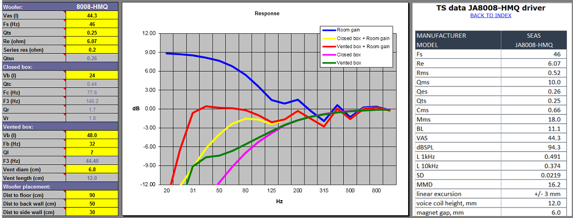

Theoretically in your case, because of the construction and placement, baffle loss is compensated by boundary reinforcement pretty well now. Sealed box woofer has also low bass loss which gets partially compensated as well.
Only measurements done outdoors or in a large hall can show low bass response "right" - but in-room "room response" is what we are listening, so only that's what we should look at.
This is typical scenario of boundary/room effect to bass response (simulation).
Yeah, that's indeed a bit strange... On the other hand, such a small gate kind of invalidates data in this frequency area.

Since my design don't have any baffle step correction taken into account in the crossover, this seems indeed to be true.
Due to the proximity to the floor, and the theoretical baffle step f3 frequency wavelength being larger than the gap (where the shelf is) between the two woofer enclosures, we should in theory only see loss from two out of four sides of the baffle. In other words about half the loss.
Theoretical loss is 6 db, while the actual real world loss seems to be 3 db. So maybe 1.5 db in my case?

To me your measurements look like what you'd expect. Boundary reinforcement plus a high Q alignment on the woofer used. This effectively negates typical bafflestep although the proof is always in the listening.
You may, or may not need compensation. And by compensation I mean 0.5-2dB of it until things sound right. What are the drivers are they coaxial?
