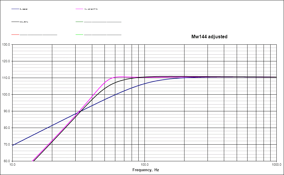

My morel MW144's do 80 Hz in 5L sealed, and they are a 5" driver. They have a lower resonant frequency though at around 50Hz. I'm not sure about the prevous comment about modelling some similar sized drivers, I think you will find that you can get BIG variances between drivers of different specifications.
I've taken my (measured) T/S params of my MW144's and done a comparison in unibox (with the fs adjusted from the real 52Hz to 65Hz).
in a 8.5L box a 60 hz tuning seems ok. attached is the comparison between sealed 5L, vented 14L (which will give about the most extension) and vented 8.5L. These are only really valid for my woofers, but gives you an idea of what you can do if you have the T/S params.
The smaller box with higher tuning frequency will give you a better transient response at the cost of less bass extension. These days I aim for somewhere in the middle of these two. For these woofers if I were to go vented (which I didn't) I'd probably settle for something around 10 to 11L.

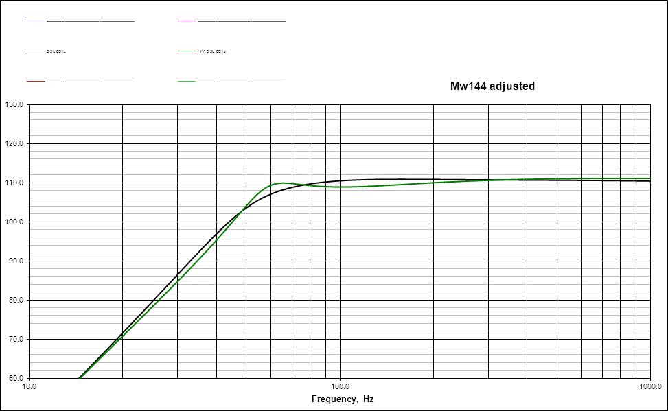

and to show how different woofers specs will vary the results. Attached is a comparison between the MW144 results and a HiVi 5" driver (also with fs adjusted to 65Hz, interestingly it has the same 52Hz in reality as the morel). The HiVi is a kevlar and paper cone woofer.
Box volume and tuning are the same, I just put in the HiVi's T/S params.
You can see that you really need the specs for YOUR drivers!!
edit: sorry about the legends, not sure what has gone wrong there, they normally are perfectly legible, my excel has a gremlin...
