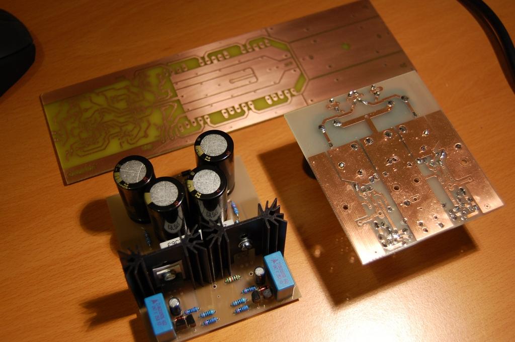

Some time ago a bought somewhere a superb looking quality copper clad board, almost fully transparent and quite shiny and greyish, like a smoked glass. Problem is, I don't remember where and it was probably a random purchase. Any idea what that could be? I can post a photo later when I get home.
I have got both types here in stock. The yellow one is coated with photoresist and the nice one is plain copper. I have never seen the nice type with photoresist though. One strange thing is both materials come from the same supplier with the same spec, apart from the photoresist of course.

zdr's picture shows an ordinary glass-epoxy board, no phenol-paper!hello.

The photoresist has no impact on the final colour, if removed with acetone.

I would look for manufacturers suppliers of CEM PCB's. Not used as much these days, as FR4 boards can be purchased for the same price, with much better proerties.
CEM-1 (CEM1)- composite for PCB's - Order Online
The two boards photographed will be FR4 based, this comes in different qualities and weave patterns, so bare boards will differ in apearance, from cheap and rough looking upwards.
eBay seller identified my "nice" pcbs as "non-UV blocking laminate". I think that mine was covered with photo resist.
same thing I noticed before that it has something to do with UV.
the greenish stuff glows brightly in UV light while the white stuff stays dark.
