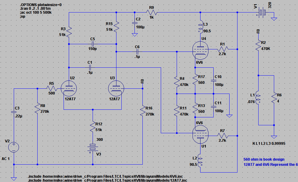

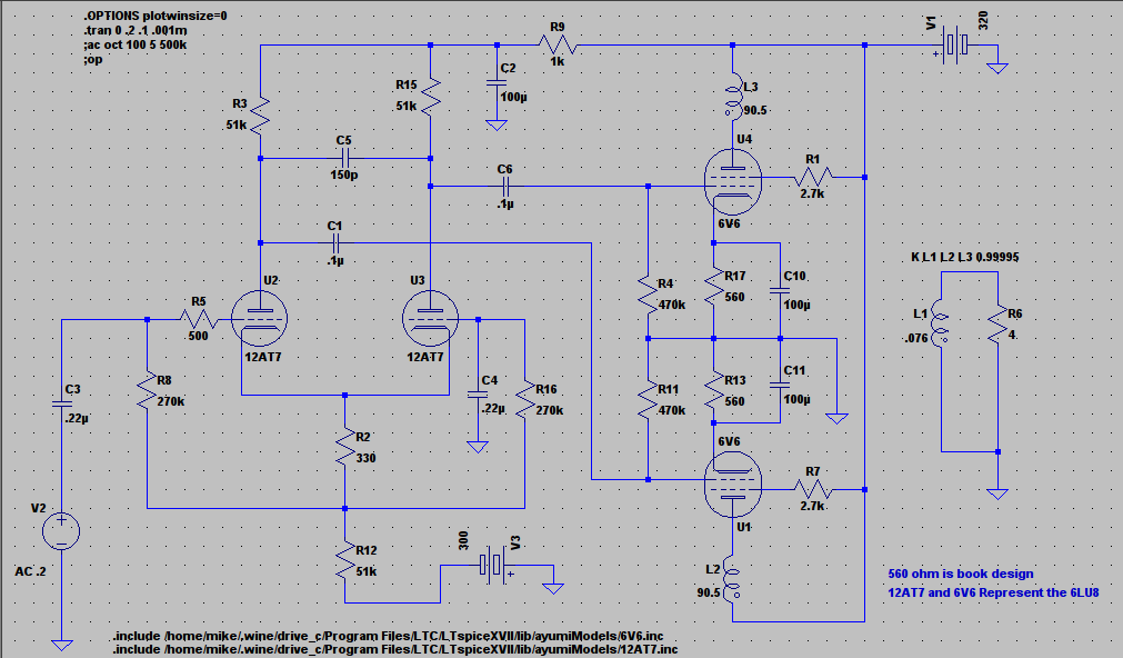

Trying to get my bearings on LTP & feeling like a dummy
Is this even close to the way one would put a B- tail on a LTP or does there need to be a more definite reference to ground? Also what is the best way to apply FB?
Note C5 is a pole to avoid instability when FB is applied.

With B- available, try this way:
Remove R8 and R16 from the junction to R2 and connect those ends directly to ground.
R2 can be bypassed, connecting the cathodes directly to the tail resistor (51k).
You can then introduce NFB to grid-R16 junction, don't forget to remove C4.

If you are going to use the non-inverting triode's grid as the application point for NFB, you must use a CCS as the tail load. Forced symmetry is, most definitely, your "friend". LTP = long tailed pair and a resistor is not "long" enough, when NFB is in the picture.
Think of the CCS as being either the fulcrum of a "teeter/totter" or glue that binds everything together.
C3 is no longer needed but it won't hurt.
470k:270k feedback ratio? That's excessive, isn't it? Maybe try R2 100k: R16 10k and work from there? I usually aim for feedback ratio that yields full output power at 2Vpp input. Eli's suggestion to use CCS is good. You can use pentode CCS if you want to keep it SS-free. Pentode CCS only needs 100-150v so that's another bonus.

If you are going to use the non-inverting triode's grid as the application point for NFB, you must use a CCS as the tail load. Forced symmetry is, most definitely, your "friend". LTP = long tailed pair and a resistor is not "long" enough, when NFB is in the picture......
Care to elaborate on this? I understand that a high tail resistance is generally good for LTP balance, but how and by what mechanism would insuffisient tail resistance influence the feedback loop?
My experience was that LTPs are bad for feedback connections as well as for being driven with balanced signals. ......
Is this not the most common way of providing feedback in solid state amps? Again, seriously asking - what has changed between hollow- and solid state?
The ideal long tail is an infinite impedance at all frequencies. Under those circumstances, coupling at the cathodes is perfect. A constant current sink (CCS) is a fair approximation of infinity that achieves excellent cathode coupling. Quite a few designs employing resistive tails use unequal valued plate load resistors, to achieve AC balance. AFAIK, none of those designs apply NFB to the non-inverting triode's grid.

A LTP is a differential gain block, which driven at only the inverting I/P. Check the reference libraries for the theory.
A CCS in the tail forces symmetry between the 2 sides. Current increasing on 1 side must be accompanied by current decreasing on the other. In the archives, you will find posts by SY dealing with his experiments on LTPs constructed from dissimilar triodes, with a CCS in the tail. Bottom line, the CCS forces symmetry between the 2 sides, even with dissimilar triodes.

It's negative feedback, if a portion of the O/P signal in phase with the signal applied to the inverting grid is applied to the non-inverting grid. Scan the archives for the "El Cheapo" schematic.
