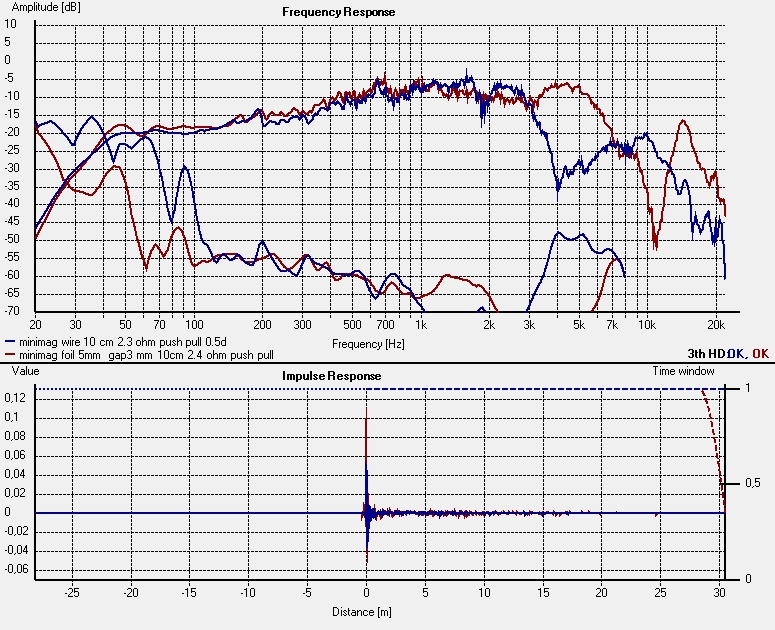

well measured both panels.
The blue line is the panel 0.5mm crosssection of 0.195 mm2 wire and a magnet gap of 1 mm. resistance of 2.3 Ohm
The red line is the foil 5 mm width 40 micron thick, 0.2 mm2 crossection. and a 3 mm magnet gap. and a resistance of 2.4 ohm
both have same amount of turns in magnet field. same amount of magnets used.
difference are not that big. although foil wins.
1. a little bit more sensitivity in the lf response but only a dB or so,
2. impulse looks cleaner.
3. Less 3th harmonic distortion then the wire version.
and i think numer 3 , you can hear verry clearly. the bass sounds way better less floppy.
both measure at 10 cm distance, so the low end will be much less further away , but i wanted to have the driver and not the room so much.

Yeah, and the foil obviously wins in the upper mid-range, too. But wow it takes a dive just above that.
Maybe if you lower the gap between membrane and magnets to 2 mm with the foil, then the high frequency response could improve enough.
My old Magnepan MG-12/QR have a separate tweeter section, with foil, and the gap is 2mm, there, instead of the 3mm they used for the mid/bass section (which used wires).

its the other way around as far as i know. the gap in a SMGA is 1.5 mm. i tried looking for magnepans with the QR to see what gap they used but i could never find a picture with the gap. could you measure this ?? or take a look at it ?
the 2 mm for the foil looks logical, but 3 for the wires would be a waste of magnetic field.
im not sure yet why the response takes a dive, my guess is its to heavy. or not enough foil versus mylar. the reason why the magnets in the high fequency are usually smaller so they can fit more foil/wire versus mylar.
i found magnet 3.2mm thick 24.4mm wide right now for 50 euro for 20 meter. if i go for 4-5 mm wide magnets instead of 6 (because mine is thicker 1,2 mm thicker) i could cut 4 or 5 strips. equals around 80 to 100 meters. enouhg for one huge push pull bass panel. still bit expensive for a shot in the dark.
Looks like I was remembering wrong about the 2mm: (It's 1 mm and 3 mm, not 2 mm and 3 mm. But those measurements were approximate, anyway.)
